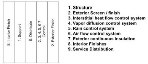

In most practical construction, the enclosure is assembled from numerous layers, and increasingly, these layers have a specific function. For housing, the following break down is useful
Figure 2:
Enclosure Functions and Layers

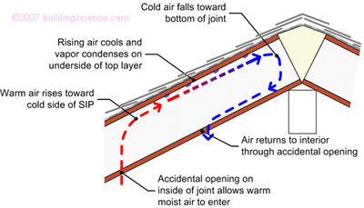

In some cases, air leakage from interior, through the roof assembly, and back into the building, can result in the same type of condensation damage (Figure 8) as through-roof air leakage.
Both types of air leakage condensation damage will be worse when the exterior temperature is low (almost always at night when the sun provides little solar heating to the roof), the interior humidity is high, and the interior air pressure is higher than exterior (caused by a combination of wind forces, thermal buoyancy, and mechanical equipment pressurization).
Figure_08: Convective loop condensation processes in roofs (in this case joint in SIPS)
Figure 8: Convective loop condensation processes in roofs (in this case joint in SIPS)
