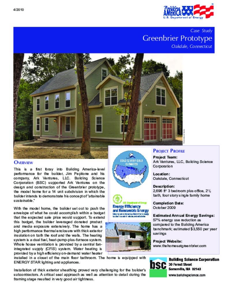

This is a first foray into Building America-level performance for the builder, Jim Pepitone and his company, Ark Ventures, LLC. Building Science Corporation (BSC) supported Ark Ventures on the design and construction of the Greenbrier prototype, the model home for a 14 unit subdivision in which the builder intends to demonstrate his concept of “attainable sustainable.”
With the model home, the builder set out to push the envelope of what he could accomplish within a budget that the expected sale price would support. To extend this budget, the builder leveraged donated product and media exposure extensively. The home has a high performance thermal enclosure with thick exterior insulation on both the roof and the walls. The heating system is a dual fuel, heat-pump-plus-furnace system. Whole house ventilation is provided by a central fan-integrated supply (CFIS) system. Water heating is provided by a high efficiency on-demand water heater installed in a closet of the main floor bathroom. The home is equipped with ENERGY STAR® lighting and appliances.
Installation of thick exterior sheathing proved very challenging for the builder’s subcontractors. A critical seal approach as well as attention to detail during the framing stage resulted in very good air tightness.
Photograph courtesy of Jim Pepitone
Project Team: Ark Ventures, LLC, Building Science Corporation
Location: Oakdale, Connecticut
Description: 2,696 ft2 3 bedroom plus office, 21/2 bath, four story single family home
Completion Date: October 2009
Estimated Annual Energy Savings: 57% energy use reduction as compared to the Building America benchmark; estimated $3,550 per year saviings
Project Website: www.thehomesatgreenbrier.com
This Building America prototype home is the model home for the Homes at Greenbrier in Oakdale, Connecticut. The builder intends the entire subdivision to demonstrate his concept of “attainable sustainable” whereby he can offer high performance homes at mid-market prices.
The model home contains 2,700 ft2 of finished space in a relatively compact footprint. The design achieves the generous floor area by fully occupying the space under 12:12 pitch roofs. An open staircase continues from this third floor space to the conditioned basement. The builder includes features in his homes that he believes will attract mid-market buyers. These features include an open ground floor plan, central AC, fiber cement siding, hardwood-laminate flooring, and a semi-finished basement and third floor ready to accommodate expansion.
