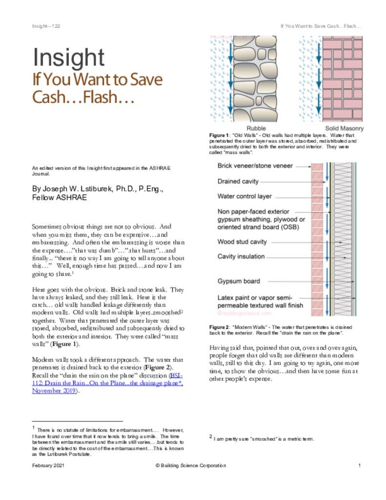

Sometimes obvious things are not so obvious.  And when you miss them, they can be expensive….and embarrassing.  And often the embarrassing is worse than the expense….”that was dumb”…”.that hurts”…and finally... “there is no way I am going to tell anyone about this…”   Well, enough time has passed….and now I am going to share.[1]
Here goes with the obvious.  Brick and stone leak.  They have always leaked, and they still leak.  Here is the catch… old walls handled leakage differently than modern walls.  Old walls had multiple layers..smooshed[2] together.  Water that penetrated the outer layer was stored, absorbed, redistributed and subsequently dried to both the exterior and interior.  They were called “mass walls” (Figure 1).
Modern walls took a different approach.  The water that penetrates is drained back to the exterior (Figure 2).  Recall the “drain the rain on the plane” discussion (BSI-112: Drain the Rain...On the Plane...the drainage plane*, November 2019).
Figure 1:  “Old Walls” - Old walls had multiple layers.  Water that penetrated the outer layer was stored, absorbed, redistributed and subsequently dried to both the exterior and interior.  They were called “mass walls”.
Figure 2:  “Modern Walls” - The water that penetrates is drained back to the exterior.  Recall the “drain the rain on the plane”.
Having said that, pointed that out, over and over again, people forget that old walls are different than modern walls, still to this day.  I am going to try again, one more time, to show the obvious…and then have some fun at other people's expense.
