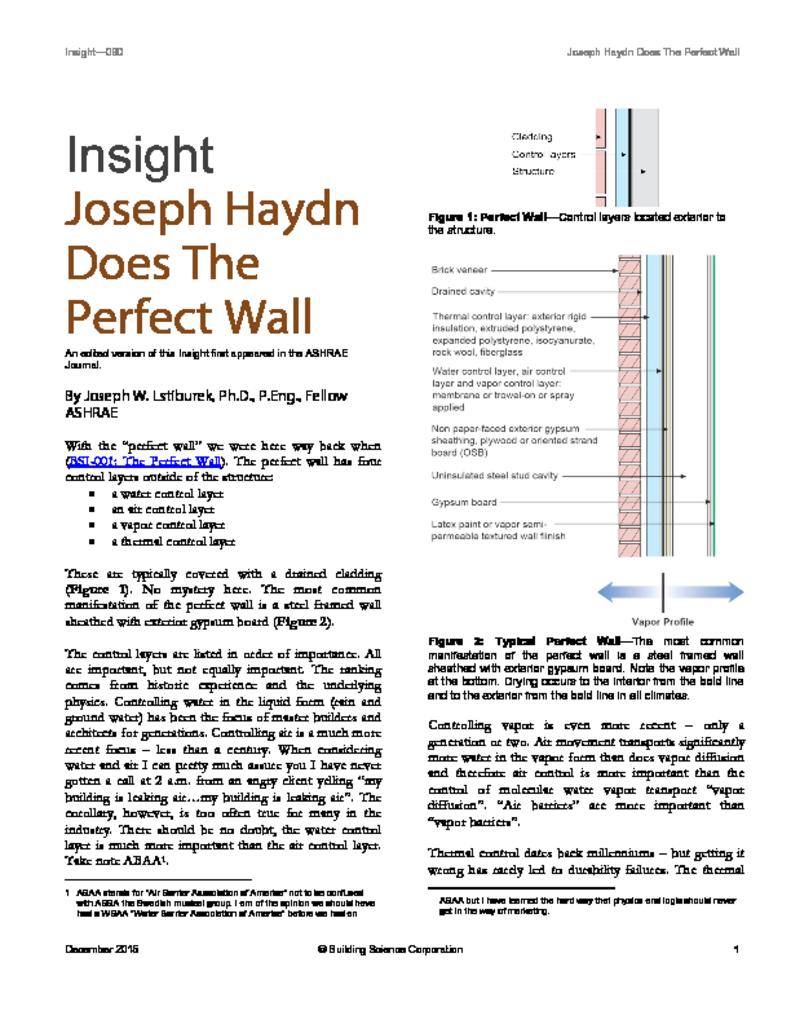

With the “perfect wall” we were here way back when (BSI-001: The Perfect Wall). The perfect wall has four control layers outside of the structure:
  • a water control layer
  • an air control layer
  • a vapor control layer
  • a thermal control layer
These are typically covered with a drained cladding (Figure 1). No mystery here. The most common manifestation of the perfect wall is a steel framed wall sheathed with exterior gypsum board (Figure 2).
Figure 1: Perfect Wall—Control layers located exterior to the structure.
Figure 2: Typical Perfect Wall—The most common manifestation of the perfect wall is a steel framed wall sheathed with exterior gypsum board. Note the vapor profile at the bottom. Drying occurs to the interior from the bold line and to the exterior from the bold line in all climates.
The control layers are listed in order of importance. All are important, but not equally important. The ranking comes from historic experience and the underlying physics. Controlling water in the liquid form (rain and ground water) has been the focus of master builders and architects for generations. Controlling air is a much more recent focus – less than a century. When considering water and air I can pretty much assure you I have never gotten a call at 2 a.m. from an angry client yelling “my building is leaking air…my building is leaking air”. The corollary, however, is too often true for many in the industry. There should be no doubt, the water control layer is much more important than the air control layer. Take note ABAA1.

In the last decade we have gotten pretty good at combining the water control layer, air control layer and vapor control layer into a single layer that can be a film or coating or membrane or a sheet good. We have also gotten pretty good at wrapping the exterior of all this with the fourth control layer – the thermal control layer.
This configuration, with the thermal control layer outboard of the water, air and vapor control layers, allows the assembly to be constructed in all climate zones: cold, mixed, hot and humid or dry. Even better, this configuration allows this assembly to enclose all interior environments in all climate zones: office, commercial, residential, institutional, pools, museums, art galleries, data processing centers. The sole exception being refrigerated buildings and cold storage facilities. In such assemblies the location of the thermal control layer is “flipped” with the other control layers – the thermal control layer now becomes located on the interior of the other three control layers. More about this later.
In cold climates locating the vapor control layer on the interior of the thermal control layer results in this layer remaining warm therefore controlling condensation from occurring due to interior moisture sources.
In hot climates locating the vapor control layer on the exterior of the structure allows the drainage of condensation to the exterior – condensation that may occur on the exterior surface of the control layer due to exterior moisture surfaces. This condensed water is handled in the same manner as penetrating rainwater. Note that the water control layer and vapor control layer are in the same location and are typically the same material.
In mixed climates the configuration addresses interior moisture loads during the heating season in the same manner a similar assembly addresses interior moisture loads in cold climates. During the cooling season the configuration addresses exterior moisture loads in the same manner a similar assembly addresses exterior moisture loads in hot climates.
Note the vapor profile at the bottom of Figure 2. Drying occurs to the interior from the bold line and to the exterior from the bold line in all climates. For this reason, this configuration or assembly is referred to as the “universal wall” or the “perfect wall”. It works in all climate zones for all interior environmental conditions with the exception noted.
