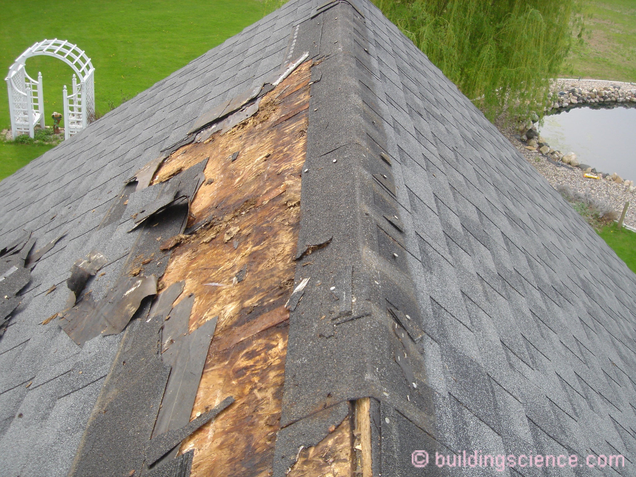

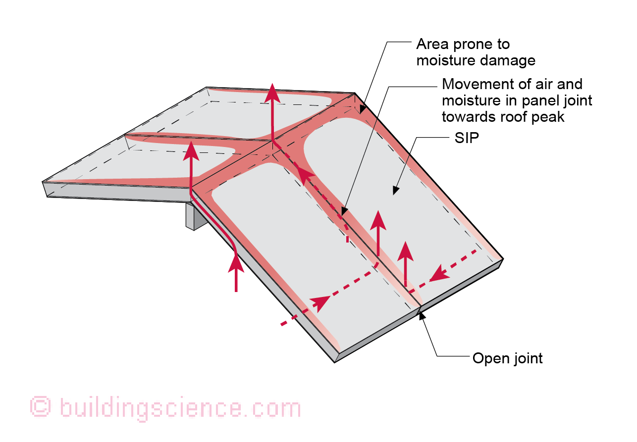

The next biggest concern with SIPS is their ability to control air flow from the interior to the exterior at panel joints.  Unfortunately, folks have not figured this out.  This is a big deal with roofs.  Bad stuff happens at ridges….”ridge rot”.   (Figure 2 and Photograph 1).
BSI-148 Figure 2
Figure 2:  Roof Panel Airflow Problems – It is necessary to control air flow from the interior to the exterior at panel joints particularly at roof assemblies.
BSI-148 Photograph 1
Photograph 1:  Bad stuff happens at ridges….”ridge rot”.

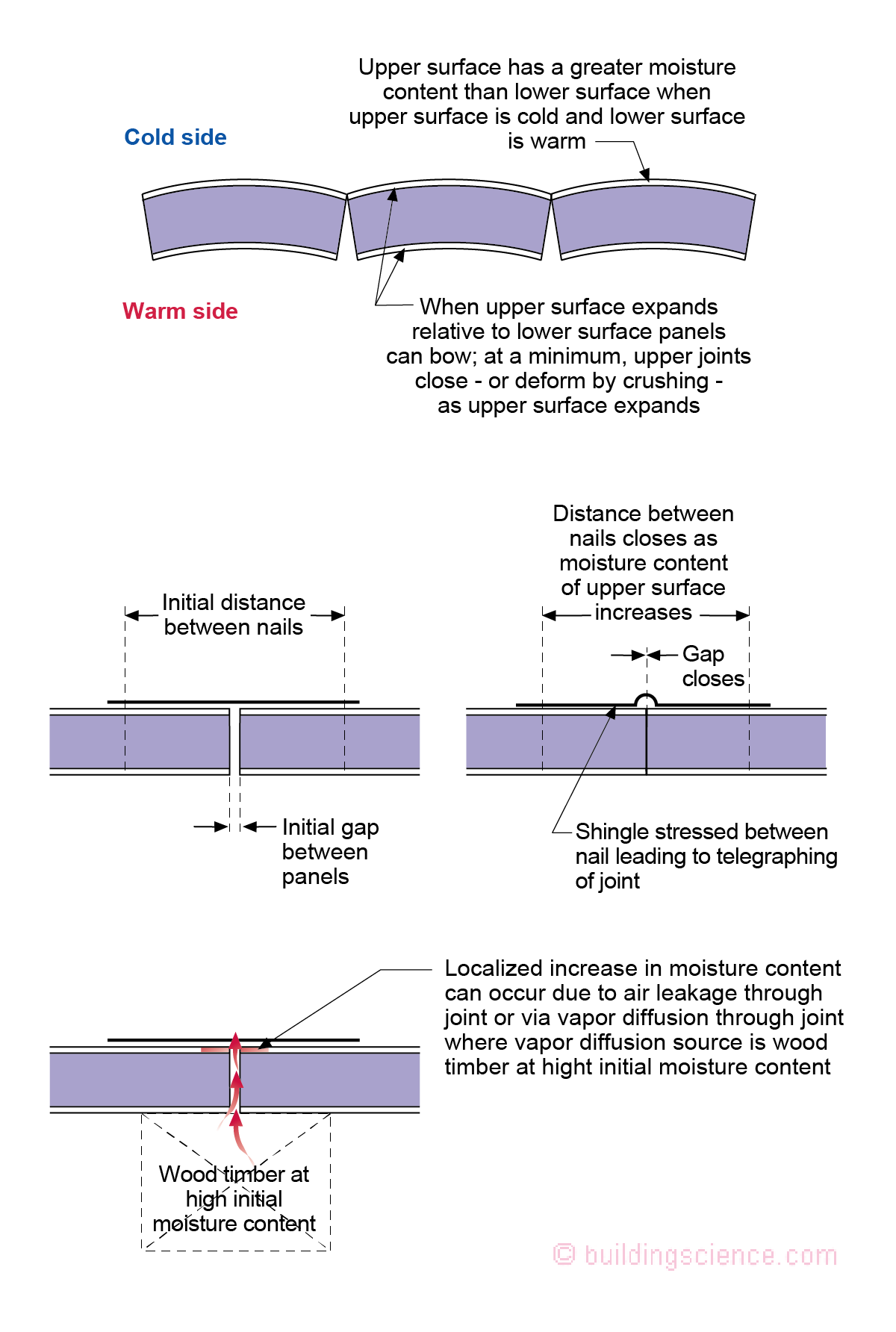

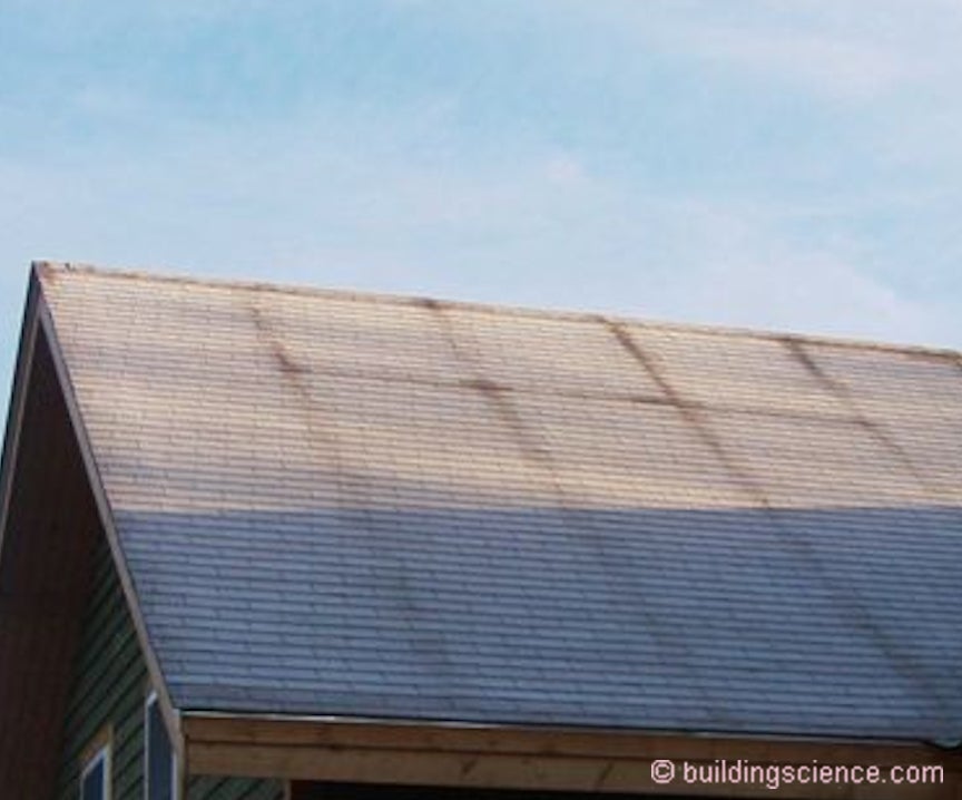

There is more….since SIPS components are made from laminated or adhered elements they can be prone to dimensional stability problems due to thermal induced moisture differentials between their wood-based hygroscopic facings.  They can bow and move differentially with the changing moisture contents of their exterior skins.  This can result in the “telegraphing” of panel joints in roof assemblies under asphalt shingles.  Again, unfortunately, folks have not figured this out (Figure 3 and Photograph 2).
BSI-148 Figure 3
Figure 3: Telegraphing of Panel Joints (telegraphing can occur due to panel movement, telegraphing can also occur due to localized increase in moisture content)
BSI-148 Photograph 2
Photograph 2:  “Telegraphing” of panel joints in roof assemblies under asphalt shingles.

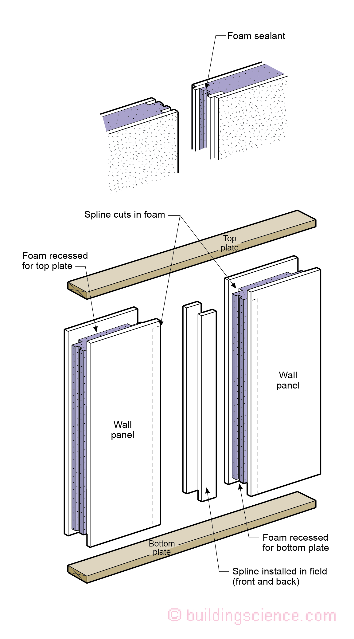

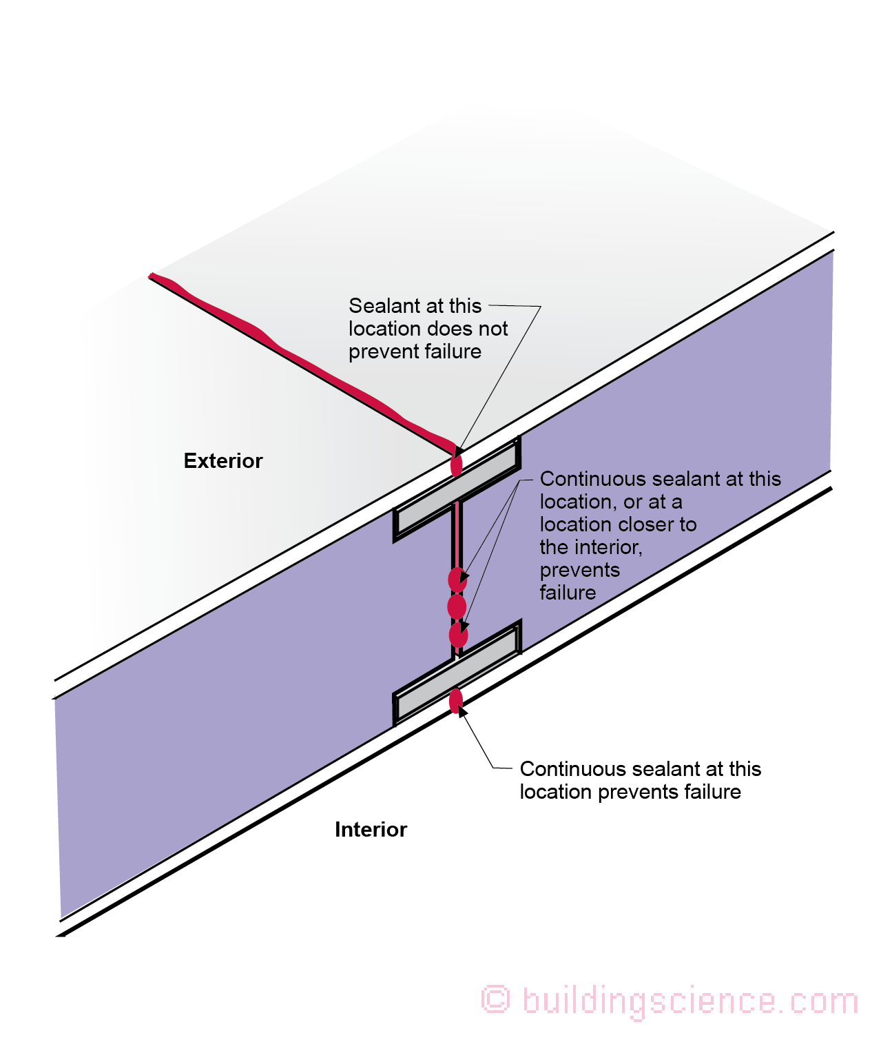

So, what do folks need to do?  Panel joints seal the heck out of them at the interior as well as close to the interior (Figure 4).  Yup, two locations….belt and suspenders….systems redundancy…. This is a really, really big deal in roof assemblies.
BSI-148 Figure 4
Figure 4: Sealant at Panel Joints - At panel joints seal the heck out of them at the interior as well as close to the interior…two locations…

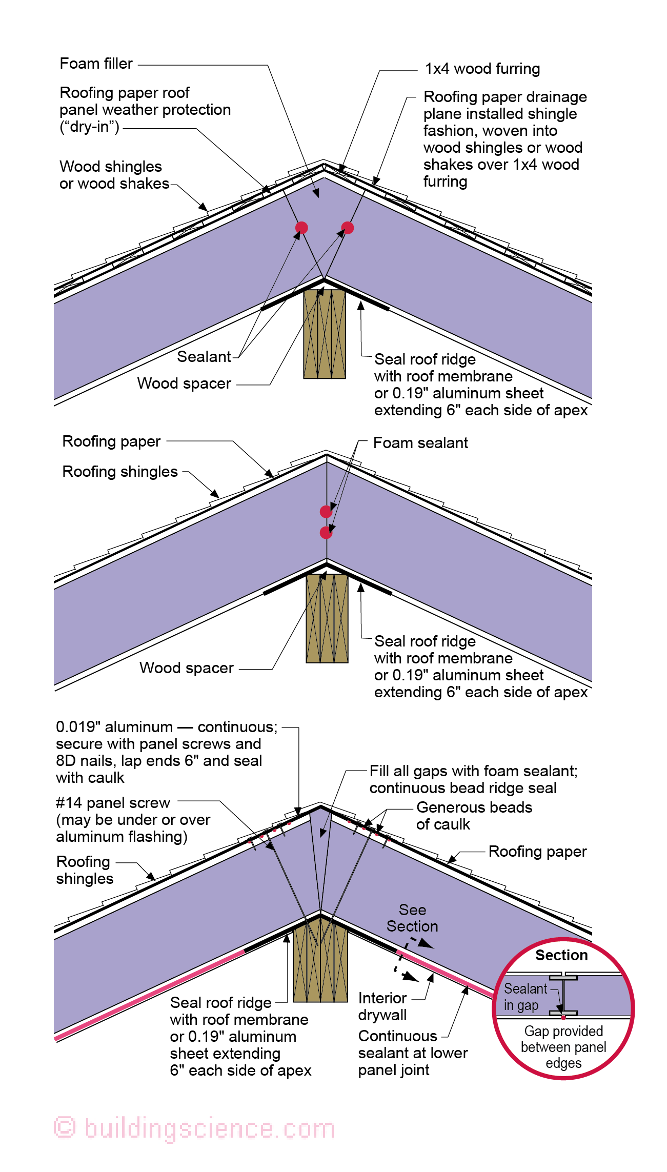

What else?  The ridge…the ridge…did I mention the ridge?  See Figure 5.  Note that there are three options – pick one…
BSI-148 Figure 5
Figure 5:  SIPS Roof Ridge – Three options shown, pick one.

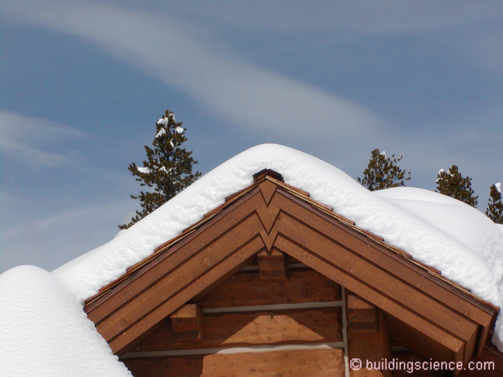

OK, what else?  Well, snow and ice-dams.  There is only one way to deal with ice dams.2  Venting.  Yes, we were here before (“BSI-046: Dam Ice Dam”, February 2011).  A vented “over roof” needs to be installed over the SIPS in locations where the ground snow load is greater than 50 lb/ft2 (244 kg/m2).  See Photograph 3.
BSI-148 Photograph 3
Photograph 3:  Note the air inlet at the facia.  Yes, the ridge vent is covered with snow, but snow is not an air barrier.  Having said that…add a “cupola” or two along the ridge to connect the “vented over roof” through the snow layer to the outside air.
