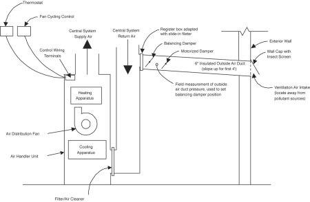

  • HVAC configuration –
    For homes with central forced air distribution system:
    Intermittent central-fan-integrated supply, designed to ASHRAE 62.2P rate, with fan cycling control set to operate the central air handler as much as 33% of the time, but not less than 25% of the time, occurring within at least every three hours to provide ventilation air distribution and whole-house averaging of air quality and comfort conditions ($125 to $150). Outside air fraction is designed to keep mixed air temperature at furnace heat exchanger above 50°F, usually not more than a 10% outside air fraction. Optionally include a normally closed motorized damper in the outside air duct (+$50 to $60). See Figure 18.
    In very cold climates ventilation can also be accomplished using a continuous single-point exhaust system, designed to ASHRAE 62.2P rate, pulling from the principal living area ($150).
    Figure 18 - HVAC Configuration

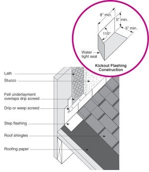

Kick-out Flashing

  • Stucco flashing detail – Where a roof intersects an exterior wall (for example, on a garage attached to a gable end), the flashing detail for the stucco should look Figure 19 and employ a kick-out flashing.

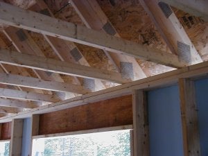

  • Energy trusses –There are a number of different truss configurations that yield greater depth at the heel, but they vary quite a bit in cost. The truss shown in Figure 20 (sometimes called a “slider” truss) has proven to be among the most cost-competitive. And of course, the pitch of the roof affects just how much insulation you can get at this location, regardless of the type of truss.
