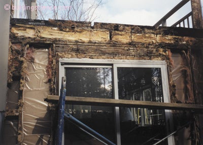

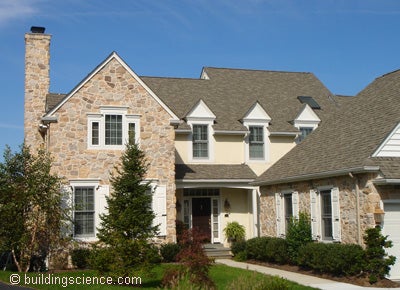

We are seeing problems with stucco claddings in field of the wall—away from windows and “other architectural features.”  And the buildings affected are not shacks (Photograph 1).  And the problems are not limited to “traditional hardcoat stucco” but also are prevalent with a version of hardcoat stucco—a cladding type that I refer to as “lumpy stucco”—more formally known as “manufactured stone veneer.”  Think of it as rocks embedded into the exterior surface of the stucco—hence the “lumpy” term.

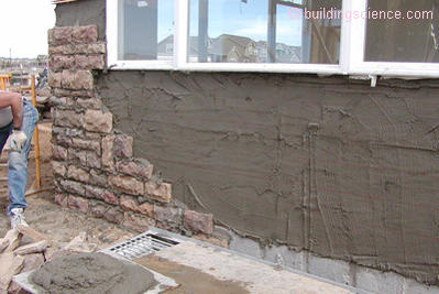

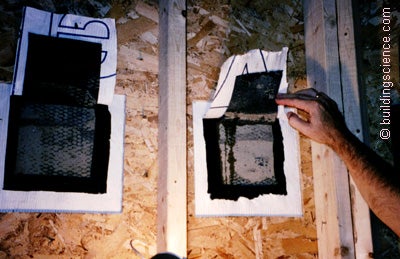

Hardcoat stucco is typically a three layer cementitious rendering (scratch coat, brown coat and top coat) applied over a building paper, metal lath and sheathing (Photograph 2).  Manufactured stone veneer is a version of hardcoat stucco where the top coat is replaced with an embedded thin stone veneer (Photograph 3).  Stucco claddings coupled with manufactured stone veneers are hugely popular because of their beauty—among other things.  Unfortunately, the beauty is often only skin deep, as they are also commonly linked with moisture problems (Photograph 4).  This was not always the case and the reasons for the change in performance are due to several seemingly small factors that add up to a huge factor:

Photograph 1: Pennsylvania Stucco “Shack”—Eastern Pennsylvania is the stucco failure capital of the United States.  Note the manufactured stone veneer—or “lumpy” stucco on the front façade.

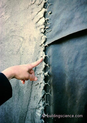

Photograph 2: Hardcoat Stucco—Three coats have been traditionally applied directly over a single layer of impregnated felt or asphalt saturated kraft paper.  Today, this results in a bond between the stucco rendering and the outer layer of the felt or paper compromising drainage.
Photograph 3: Manufactured Stone Veneer—Manufactured stone veneer claddings are very similar to hardcoat stucco and perform in a similar manner.  In a manufactured stone veneer the outer coat of stucco is replaced with a thin stone layer.
Photograph 4: Hardcoat Stucco Failures—Note that the damage is in the field of the wall away from windows.
Photograph 5: Failure on Steroids—Note the plastic vapor barrier “accelerant” in this Vancouver, Canada building.
Building paper manufacturing changes and the introduction of plastic building papers (also referred to as “building wraps” or “housewraps”) led to a change in the water management attributes of stucco renderings installed directly over these materials.  Older building papers were more “robust” than more recently manufactured products—they weighed more and had more cellulose content.  As a result when stuccos were applied directly over them a bond between the stucco and the building paper did not develop due to the dimensional instability of the cellulose.  The absence of a bond permitted a modest degree of drainage to occur between the building paper and the stucco.  With more recently manufactured building papers a bond develops between the building paper and the stucco—preventing drainage between the building paper and the stucco.  The bond between plastic building papers and stucco is even greater (Photograph 6).

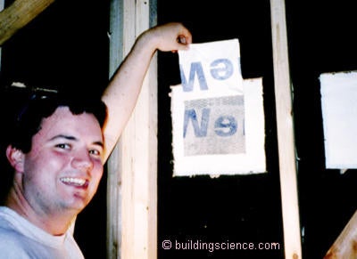

Photograph 6: Hardcoat Stucco Bonding to Plastic Building Paper—A young, happy engineer, discovers that stucco does indeed bond to plastic building papers preventing drainage.  The engineer is my friend Chris Schumacher—may he remain this happy when he gets older.

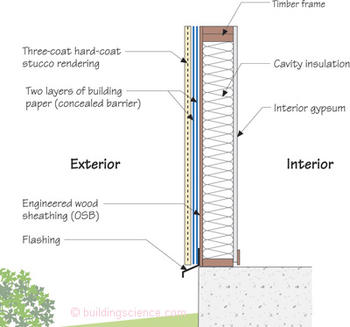

The solution to the bonding problem is pretty straightforward—the use of a “bond break”—an additional layer of building paper between the stucco and the water management layer building paper (two layers of building paper).  The best bond break between building paper and stucco, is, you guessed it, another layer of building paper (Figure 1).  Similarly, a building paper bond break should be used between plastic building papers and stucco.  For reasons that are not quite understood3 plastic building papers do not make as good a bond break as paper building papers (Photograph 7).  The use of a second layer of building paper as a bond break is not ubiquitous—it should be.  Stucco, today, needs every edge it can get.
Figure 1: Two Layers of Building Paper—The two layers of building paper are significant in the performance of hardcoat stucco assemblies.  The outer layer of building paper acts as bond break between the stucco and the inner layer of building paper permitting modest drainage of water between the two layers.
Photograph 7: Building Paper Bond Break—Traditional building paper is an excellent bond break between traditional hardcoat stucco and plastic building papers.

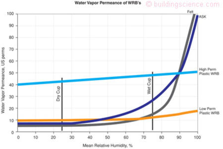

Another attribute that changed was the water vapor transmission of the plastic building papers versus the traditional building papers (impregnated felts and asphalt saturated kraft paper) (Figure 2).  What is the big deal with the shape of the curves?  Well, it’s a “Goldilocks” thing—the materials should not be too vapor open or too vapor closed—but “just right.”  With materials that are too vapor open—too much moisture stored/ absorbed in the stucco layer can be driven inwards through the material under solar induced drive causing damage in the sheathing layer.  With materials that are too vapor closed—not enough moisture will be able to exit the sheathing layer and dry outwards during drying events.
Figure 2: Permeance of Water Resistive Barriers (WRB’s)—Debate rages within the building science community as to what the curves mean.  The old guy in me intuitively believes that the shape of the curve describing the traditional building papers (WRB’s) is “good.”  And that the curve describing the “high perm” WRB is “not so good” and the curve describing the “low perm” WRB is “better but not as good as” the curve describing traditional building papers.  I believe that if we could get a plastic building paper with a curve that mirrors the shape of the traditional building papers the product would “kick building science butt.”
The stucco problem seems to be worse with “high perm” plastic WRB’s than with “low perm” materials.  As the “dwell” time for moisture in the stucco and WRB layers goes up, inward vapor transmission also goes up with “high perm” plastic WRB’s.  The “low perm” plastic building papers appear to do a better job of “throttling” the inward vapor drive protecting the sheathing.

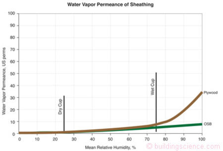

On to the plywood versus oriented strand board (OSB) change.  Folks, this is a big deal.  No matter how many times manufacturers say that OSB is just like plywood it just isn’t so.  Check out Figure 3 and the relative differences in water vapor transmission between plywood and OSB.  Plywood becomes vapor permeable as it becomes wet—OSB does not.  Did I mention that this is a big deal?  When plywood gets wet it dries a lot easier (and faster) than when OSB gets wet because it becomes vapor open.  Moisture also migrates laterally within a plywood sheet a lot easier than OSB.  The lateral movement and vapor openness when wet allows the plywood to more easily redistribute moisture than OSB.  This means that with OSB moisture becomes concentrated at OSB/building paper interfaces—whereas with plywood the moisture is released into the cavity as well as allowed to migrate laterally reducing concentrations and localized moisture stresses.
Figure 3: Permeance of Plywood vs OSB Sheathing—Note the “hockey stick” shape of the plywood curve.  Hockey is good—remember that and life will be good.  The upward rise allows the plywood to dry more readily than OSB when it gets wet.

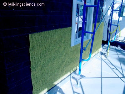

The air gap does not have to be particularly big to be a big deal—3/8 inch (9 mm).  One method of getting the air gap is to use a drainage mat between two layers of building paper (Photograph 8).  The gap allows redistribution of the moisture in both the stucco and the OSB sheathing.  The gap also does something else—if it is wide enough it becomes a ventilated space making the “Goldilocks” vapor curve argument moot.  Once we have a ventilated space (with meaningful air movement) the permeability of the traditional building papers and plastic building papers almost does not matter.  Anything between the “low perm” and “high perm” materials can be shown to work.  In fact, an insulated semi-permeable sheathing does the best job of controlling inward vapor drives in all climate zones.
Photograph 8: Air Gap—The air gap does not have to be particularly big to be a big deal—3/8 inch (9 mm).  One method of getting the air gap is to use a drainage mat between two layers of building paper.  The gap allows redistribution of the moisture in both the stucco and the OSB sheathing.
