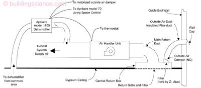

A ducted dehumidifier can be integrated with the central air conditioning distribution system as illustrated in schematic below. The fan inside the dehumidifier unit draws air from the living space or from the air handler plenum and returns it to the supply plenum. The dehumidifier controls include a remote dehumidistat located in the living space. Controls cycle the air handler fan on when the dehumidifier is activated. Controls could also be configured to operate the outside air damper or to link dehumidifier operation to outside air ventilation cycles.

Supplemental Humidity Detail
Figure 1
Figure_01
  • Dehumidifier controlled by remote dehumidistat located in the conditioned space
  • Air handler fan is operated with the dehumidifier for distribution
  • Controls can be configured to operate the outside air damper with dehumidifier
