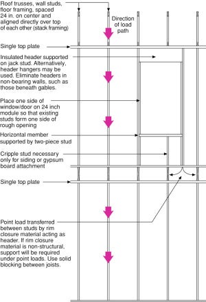

Advanced framing, as the name implies, means using the lumber intelligently in wood framing. The foundations of advanced framing are 1. use common material dimensions (24-inch grid) as a basis for design to maximize material use and minimize waste and 2. efficient load transfer to reduce unnecessary framing members from the home. Some of the techniques used include stack framing allowing for the use of single top plates, elimination of wood beams/headers in non-load bearing walls, and two-stud corners. Framing around openings in exterior walls limited to those framing members needed for vertical load transfer (e.g. jack studs) or horizontal load resistance (e.g. king studs where needed around larger openings in larger buildings or high-wind areas).
Stack framing elevation view
Exterior Wall Openings:
Structural headers are reserved for bearing wall conditions – they are not needed in non-bearing walls and non-bearing partitions. Headers should be sized appropriately for the load. When possible a single header should be used, however for lager openings a double header may be required. At exterior walls the header should be pushed to the exterior to allow for insulation to be installed on the interior. A framing member on the flat should be used below the header to allow for attaching of the interior drywall. Openings should be aligned with stud spacing (at least one side, preferably two) where possible. Cripple studs are not needed to support sill studs where windows are “hung.” Cripple studs are included at the wall stud spacing intervals for siding or interior finish attachment.

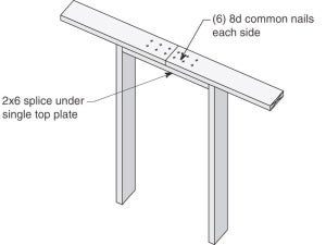

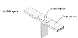

Single Top Plate:
With stack framing and structural rim board material transferring loads, a double top plate is not needed for load transfer. The framing members must be centered over the studs with a tolerance of no more than 1”.
Top Plate Splice Over Stud
- Top plate joint aligned over stud
- Connector plate provides structural continuity to top plate
Top Plate Splice Between Studs

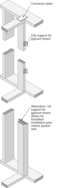

Partition Wall Connection:
Similar to exterior corners, adding additional stud framing for drywall support where partition walls intersect exterior walls creates unnecessary material use and unnecessary thermal bridges. The diagram to the right shows how dry wall support at this intersection can be provided by drywall clips or a 1x6 (alternately, a strip of plywood could be used) attached to the back of the partition’s terminal stud. These measures allow insulation of full, or nearly full-, cavity depth to continue past the intersection. Structural connection between the partition wall and the exterior wall can be achieved by a connector plate at the top of the wall and nailing into the floor sheathing at the bottom of the wall.
Partition Wall to Exterior Wall Intersection
- Thermal bridging by framing at intersection is avoided.
- Insulation continues behind intersection.
- Drywall attachment is to partition wall only to reduce cracking resulting from differential wood shrinkage. Alternately, use floating corner for one wall.
