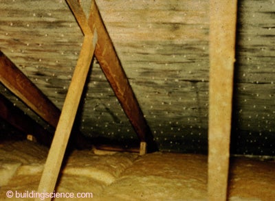

Photograph 1: Moldy and Decaying Attic
– Notice the frost on the nails penetrating the roof sheathing. Moisture ends up on the coldest surfaces first. The sheathing is taking a beating, but the top chords of the roof trusses are doing fine because they are just a little bit warmer.

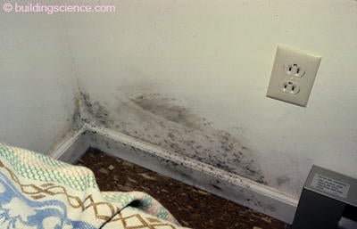

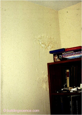

Photograph 2: Mold on Interior Surfaces
– Interior moisture levels go up due to reduced air change and relative humidity adjacent cold surfaces rises sufficiently to support mold growth. Compare this mold growth pattern to the temperature profile in Photograph 3.

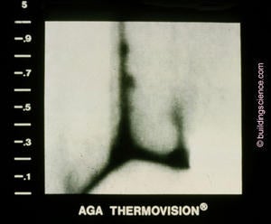

Photograph 3: Temperature Profile
– IR scan of a corner illustrates cold surfaces. Mold growth tracks the cold surfaces. Compare this temperature profile to the mold growth pattern in Photograph 2. A cynic with a sense of humor – the best kind of cynic – would say that mold growth is a cheap and more accurate method of surface temperature profiling compared to an IR camera. How to fix this problem? Lower the moisture content of the interior air with dilution ventilation or warm up the surfaces or do both.

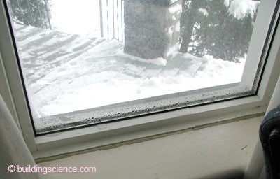

Photograph 4: Window Condensation
- Interior moisture levels go up due to reduced air change and relative humidity adjacent cold window surfaces rises sufficiently to condense water. How to fix this problem? Lower the moisture content of the interior air with dilution ventilation or warm up the surface of the windows by replacing the windows with better windows or do both.

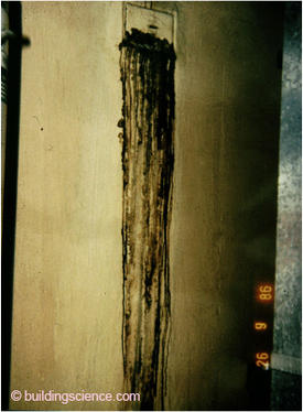

Photograph 6: Flue Condensate Damage
– Big danger here. Condensate from flue gases from replacement gas furnace leaching through wall assembly. How to fix this problem? Line the chimney; see Photograph 8.

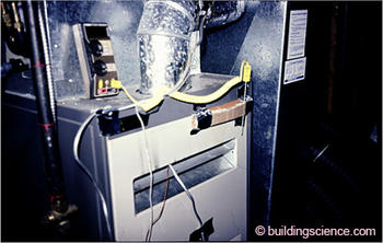

Photograph 7: Spillage of Flue Products
– Notice the soot stains at the draft hood of this replacement gas furnace. How to fix this problem? Provide combustion air; see Photograph 9. What are all those tubes and toys you ask? I was once a young graduate student who thought you could measure pretty much anything. Boy was I wrong – and I will leave it at that.

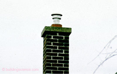

Photograph 8: New Chimney Liner
– notice the new smaller sheet metal flue installed inside the larger original masonry chimney that served the older oil furnace that got replaced.

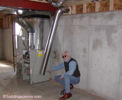

Photograph 9: Combustion Air Supply
– Handsome guy with sunglasses (not me, but an ex-classical concert musician who knows stuff about buildings) is pointing at a ducted (to the outside) combustion air supply duct. As handsome as he is wouldn’t it be better to have sealed combustion power vented appliances and not have to worry about providing a duct like this?
