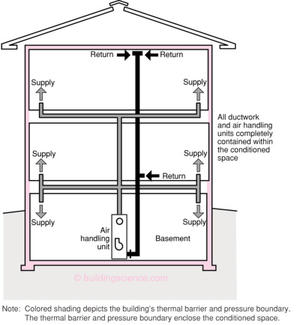

Ducts in Conditioned Space Details
Figure 1
Vented and Unconditioned Attic
  • The air handling unit is located in a conditioned basement
  • Low efficiency gas appliances that are prone to spillage or backdrafting are not recommended in this type of application; heat pumps, heat pump water heaters or sealed combustion furnaces and water heaters should be used
  • A hot water-to-air coil in an air handling unit can be used to replace the gas furnace/heat exchanger. The coil can be connected to a sealed combustion (or power vented) water heater located within the conditioned space.
  • Ductwork is not located in exterior walls or in the vented attic

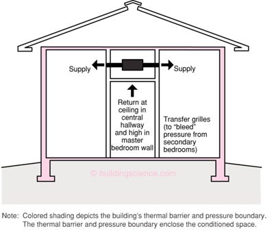

Figure 2
Vented and Unconditioned Attic with a Dropped Ceiling
  • In this approach, exterior wall heights are typically increased to 9-feet or more leaving hallway ceiling heights at 8-feet
  • The air handling unit is located in an interior closet and the supply and return ductwork are located in a dropped hallway
  • Transfer grilles “bleed” pressure from secondary bedrooms
  • Ductwork does not have to extend to building perimeters when thermally efficient windows (low-E, spectrally selective) and thermally efficient (well-insulated 2x6 frome walls with 2” of insulating sheathing) building enclosure construction is used; throw-type registers should be selected
  • A hot water-to-air coil in an air handling unit can be used to replace the gas furnace/heat exchanger. The coil can be connected to a sealed combustion (or pwer vented) water heater located within the conditioned space.
