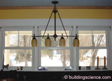

Window Replacement

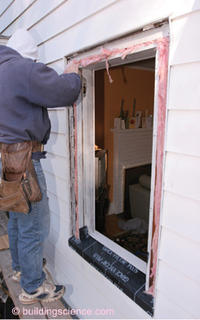

To increase comfort during the renovation, windows were replaced first. The interior sash stops and sashes were removed. The whole opening was wrapped with peel-and-stick membrane, leaving enough around the exterior to connect the new drainage plane. A new vinyl-clad wood-framed window was installed from the exterior into the pocket that was formed by wrapping the opening with membrane, so that no interior trim had to be changed. The sills were extended and exterior trim was wrapped back to the plane of the window. The exterior siding was butted to the trim.
Photograph 2 (top) and Photograph 3 (bottom): Windows—Insulation was installed around the window opening. The membrane pan flashing installed to receive the replacement windows was extended upwards and wrapped the entire opening.

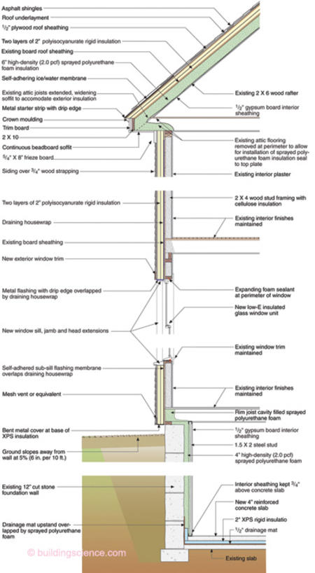

Drainage Plane Continuity

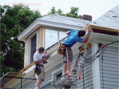

Draining water away from the enclosure starts at the roof. The rooftop vents were removed, and the roof was stripped down to the original board sheathing. Two layers of foil-faced foam were installed followed by a new layer of plywood sheathing. The roof sheathing was covered entirely with ice and water shield and new shingles were installed. Care was taken to retain the depth of the original overhang which was achieved by furring out the fascia board.

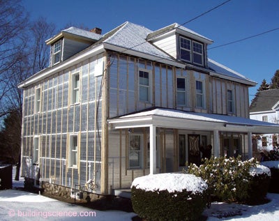

Photograph 4: Wood furring strips hold exterior foil faced rigid insulation in place. The windows are recessed inboard of the rigid insulation so that interior window trim geometry was not altered. The interior look remained true to the original design.
The original wall shingles had been covered with aluminum siding. The siding was removed and hauled away by a scrap metal contractor. The shingles were removed to expose the original board sheathing.
A corrugated house wrap was installed over the board sheathing and connected to the window wrap as well as the top and the bottom of the wall sheathing (with a continuous bead of caulk for air barrier continuity). Then, the two layers of 2-in. polyisocyanurate were applied with the joints staggered and taped with adhesive construction tape. The insulation board was held in place with 1 by 3 furring strips screwed back to the board sheathing. The pre-primed cedar siding was then attached to the furring strips. This resulted in a ¾-in. space (open at top and bottom) that allows drainage of water and ventilation to dry much of the remaining water.
Multiple mechanisms in the new assembly shed water. When rain hits clapboard siding, the majority of the incident water drains to the outside. The ¾-in. ventilated space provides added protection (water is not “sandwiched” between the clapboard and the underlying structure, plus the space allows for ventilation drying).

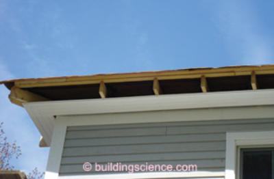

Photograph 5: Two layers of rigid insulation were installed over the top of the roof deck. Rafter tails were extended to provide a sufficient overhang.
Photograph 6: Crown molding was installed to hide the thickness of the two layers of rigid insulation installed on the top of the existing roof deck.
Any small amount of water that penetrates past the cladding is drained on the outside face of the insulating sheathing. Finally, any water that manages to get between the two layers of insulating sheathing is carried down the wall on the draining housewrap. Since the windows were installed back at the face of the housewrap/board sheathing, the rain is kept away from the face of the window, further increasing the long-term durability of the window.

Air Barrier Continuity
For an air barrier to be effective, it needs to wrap all six sides of the “conditioned cube,” and all components need to be connected in a continuous manner. The new slab was connected to the basement walls with spray foam that extended from the new basement slab to the rim sill, directly under the first floor. The corrugated housewrap became the air barrier at the exterior wall above grade, helped by the two staggered layers of foam sheathing installed over it.
At the roof-wall interface, the air barrier was transferred back to the interior at the soffit where the housewrap was adhered to the board sheathing and then connected with spray foam to the top plate of the second floor wall. It was continued with more spray foam to the interior side of the roof board sheathing.
Thermal Continuity
The insulation followed the same path as the air barrier to wrap all six sides of the cube. Starting at the basement, the existing slab floor was covered with 2 in. of XPS. The existing basement walls were covered on the inside with 4 in. of closed-cell spray foam. The exposed sills at the basement were sprayed from the inside as well. Then the exterior above-grade walls were filled with cellulose, using the traditional method of making small holes in the exterior sheathing. The two 2-in. layers of polyisocyanurate were installed over the whole exterior wall.

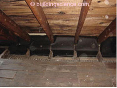

The roof vents were sealed, and the wall-roof intersections were lined from the inside with building paper to provide a temporary dam for the application of spray foam from the interior. Two additional 2-in. layers of polyisocyanurate were then installed on top of the roof deck.
Vapor Diffusion Profile
The roof assembly with its layers of insulation, plywood roof deck, and self-adhering membrane is impermeable. The exterior walls of the house were rendered vapor impermeable by the addition of the exterior foil-faced polyisocyanurate insulating layers. However, the thermal resistance of the insulating sheathing is sufficient to stop any condensation on interstitial surfaces that might otherwise occur. A small area of the basement wall was left exposed above grade, allowing the concrete and stone structure to dry to the outside.

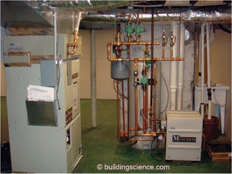

One air handler located in the basement serves the basement and first floor. One central return for that air handler is located on the floor of the first floor central hallway. The other air handler, located on the conditioned attic level, serves the second floor and the attic. One return is on the ceiling of the second floor hallway and another is in the attic. Transfer grilles over the doors to the bedrooms on the second floor prevent room pressurization due to inadequate return paths. Each air handler is equipped with a MERV 13, 5-inch pleated media filter.
Providing air change with a controlled mechanical ventilation system is important for interior moisture control and for good indoor air quality. There is an outside air duct to the return of each air handler with a manual damper, which provides ventilation during air handler run time. Four individual exhaust fans (one in each bath and powder room) and a ducted exhaust over the gas range provide source control of pollutants.
Photograph 11: Mechanical systems upgrades in the basement include an air handler, high efficiency boiler and a super insulated water tank.

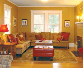

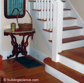

Photograph 13: Keeping the existing plaster, wood trim and maple floors makes this home beautiful as well as comfortable and energy efficient.

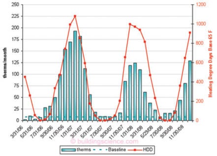

The utility bills for the past three years are shown. Gas was billed monthly, but electricity was only billed every two months, reducing available resolution. Heating degree days and cooling degree day data (NOAA data for Boston weather station) are also plotted for reference.
Graph 2: Gas Use (Therms/Month) With HDD Base 65°F
While the home was purchased and occupied starting in mid 2006, construction was taking place until the end of 2007. 2008 was the first full year of data after renovations were completed.
The most recent 12 months of bills were examined to see how they compared to the model. During that period, weather and house operating conditions were as follows:

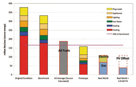

The resulting energy use is shown on the bar graph, “Energy Use Before, After Renovation.” It shows the annual gas and electric use (in terms of source energy), with the unrenovated house, Benchmark and model for comparison.
Graph 3: Energy Use Before, After Renovation
The utility bill data showed even greater savings (54%) than what was modeled (44%). The graph shows that gas use was less than predicted (614 therms vs. 731 therms); space heat and domestic hot water were provided by gas.
Similarly, electrical use was less than predicted (3,865 kWh versus 5,694 kWh simulation). The air-conditioning use—and therefore, resulting load—were lower than expected.

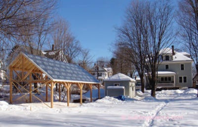

The installation of photovoltaic units could offset the electrical loads, and based on actual electrical use, it is clear that a 3.5 kWp system would reduce the electric load to next to nothing. By late April, a 4.9 kWp system will be installed on a south-facing boat shed in the backyard in anticipation of the plug-in cars of the future.

Photograph 14: In April 2009, 28 photovoltaic panels with micro-inverters will be installed on the shed. They will further offset the house’s total source energy use to approximately 40 million Btu.
