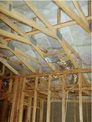

Pulte Tucson has changed very little from their first Building America prototype home in 1996. They have switched from plywood to Thermoply (lighter, cheaper, easier) to define the attic conditioned space (backer for cellulose insulation installation), and have fine-tuned their mechanical ventilation system (see discussion of moisture problems for technical discussion of ventilation systems for Pulte Tucson).
