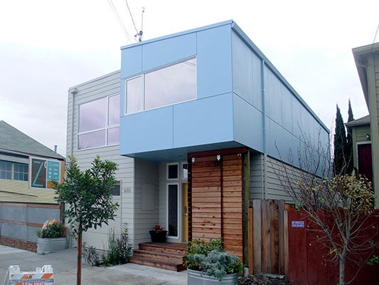

Description: 1,561 ft22 bedroom, 2 bath, two-story urban infill duplex/townhouse
Completion Date: November 2009

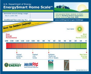

Estimated Annual Energy Savings: $992 per year without photovoltaics; $93 per year with PVs (electricity @ $0.13/kWh)
Project Website: www.zetacommunities.com/projects_livework.php

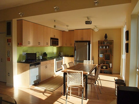

ZETA Communities is a startup company that has a mission of building energy efficient and/or net zero modular houses at costs competitive with local construction. They recently completed their first prototype, the live-work townhome: an infill project located in a mixed industrial/artist/residential urban neighborhood, within walking distance of a mass transit station. The plan provides a ground floor work studio, 2 bedrooms, light-filled great rooms, decks, and sustainable landscaping, in addition to a one-car parking garage.
BSC worked with ZETA and Daniel Smith & Associates (DSA), the architects who were previously associated with the project, and have extensive experience in sustainable design and passive solar projects. Energy analysis showed a 45% savings with respect to the Benchmark when not including the photovoltaic system; inclusion of the 5.4 kW PV system showed a savings of 95%. The analysis also showed near-net zero performance, assuming Building America operating conditions; prudent operation by a homeowner will likely result in net zero performance.
The project has received a LEED-H Platinum rating, 217 Green Point Rating, and EPA’s highest indoor air rating, Indoor airPLUS. The house is currently under contract, and the owner is scheduled to take occupancy in March 2010.

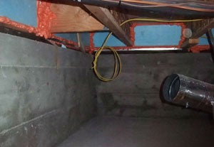

The design actively uses thermal mass to reduce space conditioning energy use. The conditioned crawl space is used as thermal mass (walls and slab floor); the air handler distributes air through this space, which is then “bled” to the first floor registers.

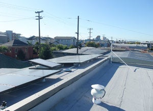

The photovoltaic system was sized to account for the remaining annual electric load.

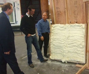

Roof assembly mock-up in factory

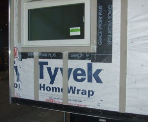

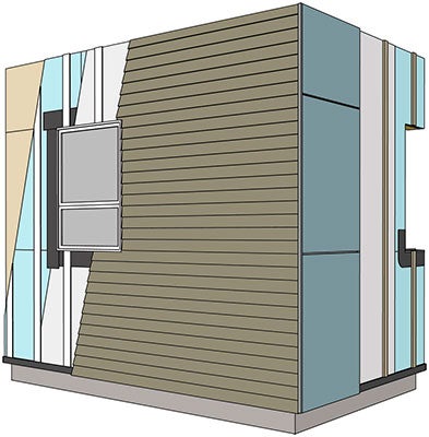

Wall Assembly: 2x6 walls at 24” o.c. with R-24 nominal wall insulation: low density urethane spray foam (R-19) in wall cavity with 1” XPS (extruded polystyrene) (R-5) foam sheathing; housewrap and ¼” or ¾” drainage/ventilation cavity. Non-paper faced gypsum board used throughout interior.
Wall assembly mock-up in factory

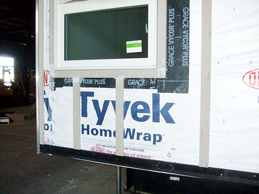

Window Specifications: Serious Materials 725 Series, triple glazed (dual pane, high SHG film, Krypton fill gas); U=0.23 SHGC=0.42.
Window installed in factory

Foundation Assembly: Conditioned crawl space with 1½” R-7.5 XPS insulation on exterior, and R-5 XPS under slab. Space used as “thermal basement,” or thermal mass, connected with air handler system.
Foundation assembly

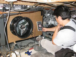

Ventilation: Heat recovery ventilator (HRV), with FanTech timer control, allowing hourly cycle runtime, plus use as a bathroom exhaust fan (both bathrooms).
Heat recovery ventilation

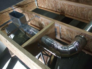

Space Conditioning Distribution: Sheet metal and insulated flex ducts located in conditioned space (conditioned crawl space, interior space).
Sheet metal ducts to insulated flex ducts

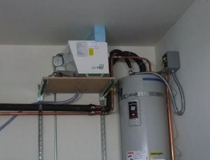

DHW:Heat pump water heater mounted on electric resistance tank in garage; AirGenerate AirTap, 2.11 EF.

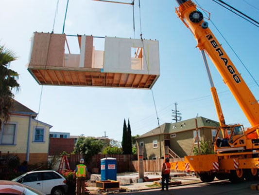

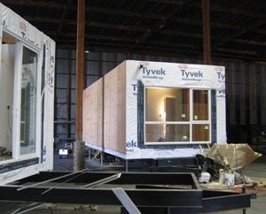

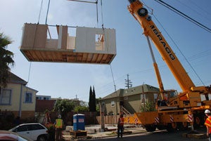

Prior to the start of construction, BSC participated in several design charrettes with ZETA, fine-tuning the enclosure design, the mechanical systems, the zTherm controller, and evaluating various measures for cost-effectiveness. The units were factory-built, and the modules were set on site. Site finishing and integration work followed, which included the installation of all mechanical equipment.
Water management was a priority for both the design team and the builder; critical measures included pan flashings under all windows (both membrane and sheet metal), a drained and ventilated cavity behind the siding, and exterior foundation water management details. BSC provided step-by-step flashing details for the window installation.
In addition to BSC’s oversight, a local third-party tester was retained by ZETA for LEED and ENERGY STAR® certification; all three groups communicated their findings and resulting concerns, working together to solve problems.
BSC travelled to the site on three different occasions during the construction and commissioning process, both testing and providing feedback to the builder. The zTherm controller was a custom-designed piece of equipment; integrating it with the functions of the house required an effort from all parties, but was eventually resolved.

Design Challenge: Heat Pump Water Heater
One particular challenge was the implementation of the heat pump water heater. An all-electric mechanical system was chosen, due to California net metering laws. Excess power is forfeited to the utility, so using fossil fuels on site and generating excess PV energy to achieve net zero is a financial loss.

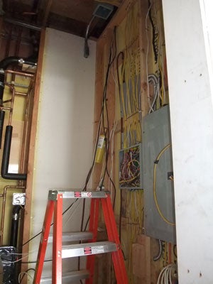

Initial designs placed the water heater in a mechanical room off the garage; however, it was later clear that the mechanical room would be difficult to isolate from the interior, due to service penetrations and electrical panels. Bringing the mechanical room within conditioned space solved the enclosure issues; however, the heat pump water heater still needed non-interior air. Ducted connections to outside were tested, showing very poor efficiency.
The water heater was then moved to garage. Concerns that this will cause excess chilling of the garage were addressed with calculations, showing that it is unlikely to be a problem. However, garage temperatures will be monitored.
