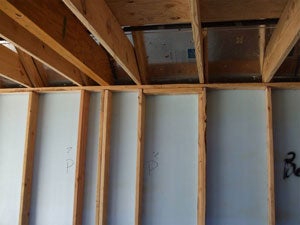

These houses feature advanced framing, which includes 2x6 exterior walls and 2x4 interior (partition) walls, both spaced at 24” on center instead of the standard 16” on center. All joists and rafters are stack-framed, meaning that single top-plates can be used, and headers above doors and windows are eliminated where the wall is not load-bearing. All of this results in less thermal bridging and an enclosure that reduces the amount of heat flowing through the wall.

Framing: OVE 2x6 wood frame walls
Stack framed walls

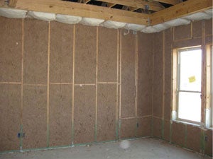

Wall Insulation: R-25; R-20 damp-sprayed cellulose in the 2x6 wall cavity plus 1” R-5 XPS
Damp-sprayed cellulose cavity insulation

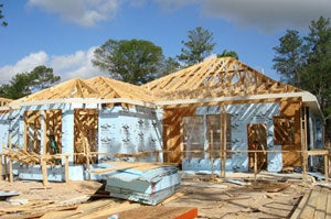

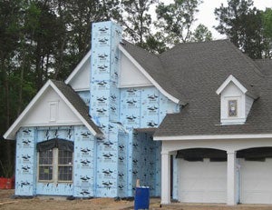

Drainage Plane: XPS insulating sheathing; all horizontal and vertical joints taped with sheathing tape; windows are pan-flashed to the exterior of XPS sheathing; all roof-to-wall transitions have flashing and kick-out flashings.
Insulating sheathing with joints taped

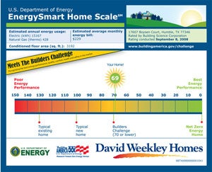

HERS Index Score: 63 to 70 depending on model

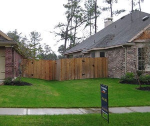

Landscape Plan: Positive drainage away from foundation provided via sloping of grade around entire perimeter of foundation (front, back and sides).
Sloping grade
