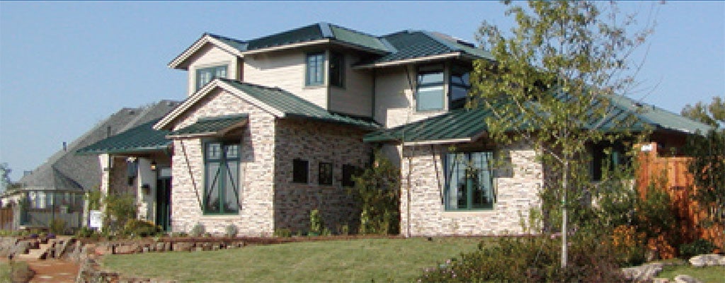

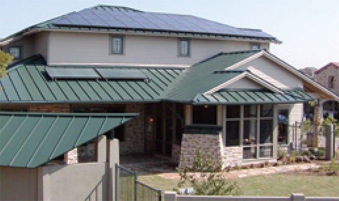

It shouldn’t be a surprise that energy would be a hit in Texas—but 8,000 people on the fi rst weekend to tour a home that uses less than half that of a standard new home, and makes the rest itself? There is no magic in the technology and engineering, but clearly builder Jim Sargent and his systems thinking team have created something special at the Building America Zero Energy Home of Lone Star Ranch in Frisco, Texas.
Project Team: Anderson Sargent Builders, Barley Pfieffer Architects, Building Science Corporation, EEBA, US DOE Building America Program
Address: Dallas, Texas
At the first-of-its-kind Zero Energy Home in North Texas, energy-efficient technology and science are not thrown into and onto the home, but are integrated into every aspect of the home’s design, walls, and equipment. Early in the design process, Sargent decided to make it a Building America project, and became a Building Science Consortium partner. A full-day design charrette in Westford, Massachusetts, became the first step in ensuring that this Zero Energy Home would be a systems-engineered expression of age-old and cuttingedge architecture and building science.

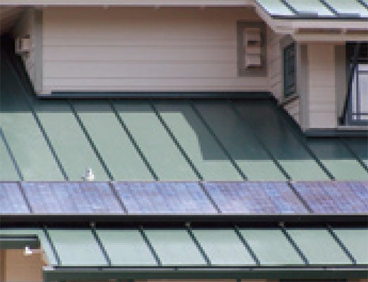

Energy Efficiency — The key to any zero energy home is reducing the overall load as much as possible, keeping the renewable energy systems within the home's ability to support both their cost and their typical rooftop location. This means that all major systems in the house—the building enclosure, the mechanical systems (space heating/cooling/ventilation), domestic hot water, appliances, and lighting—must work together. As you look at the impressive list of energy features in this home (see Anderson Sargent Building America Zero Energy House Case Study side bars, keep these points in mind:

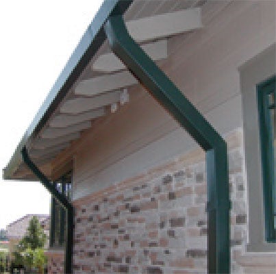

• The architectural design and details (sized overhangs and window shading, window locations and dimensions, and layout for temporal and space "zoning") are accomplished with precision and beauty—the definition of high performance includes occupant convenience and comfort.

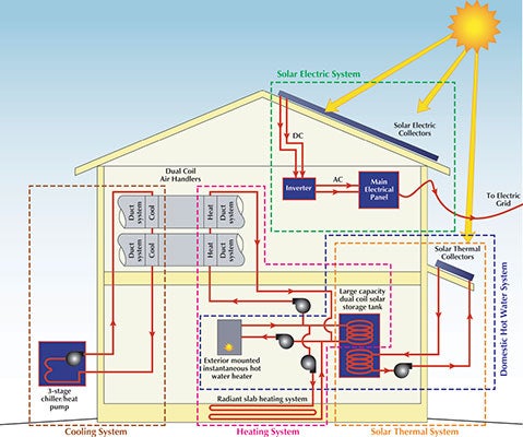

• The design and performance of each system are synergetic with each of the others—no system competes to reduce overall energy load. A truly elegant example of this is the integration of the rooftop solar water system, the tankless water heater, and the modified heat pump. The key? A heat sink—the large, highly insulated hot water storage tank with two high-surface area heat exchangers. The lower heat exchanger is connected to the rooftop solar system, the upper to the tankless water heater. Since the closed-loop solar water system can “communicate” with the space heating system through the tankless water heater coil, the hot water storage tank takes on or gives up heat as solar supply and domestic water/space heating needs demand. The water heater is a backup supply for space and domestic water heating. This system depends on a series of controls for efficient operation, but is much less complex than many systems with the same level of integration.
• The combined impact of all the features is a 45% reduction in overall annual energy consumption—181 MBtu for this home compared to 329 MBtu for a conventional home of the same basic dimensions and characteristics. With modest energy savvy, the homeowner’s remaining energy needs can be met by the renewable energy produced by the photovoltaic and solar hot water systems.1

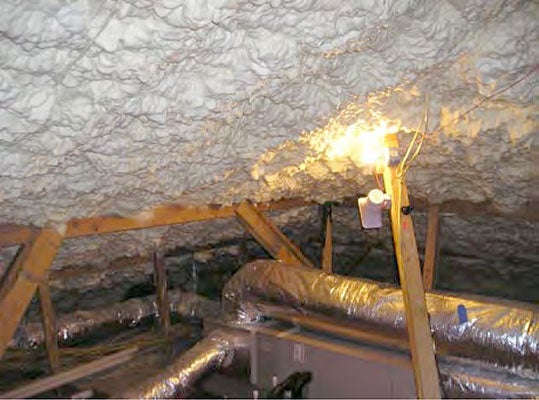

Indoor environmental quality — As the home becomes a more and more efficient environmental separator (keeping the outdoors out, and the indoors in), maintaining indoor environmental quality becomes a greater challenge. This Building America Zero Energy Home has a mechanical ventilation system integrated into the central heating, ventilation, and air-conditioning (HVAC) system, and no-combustion or sealed-combustion mechanical systems. The builder and architect selected materials for their low emissions and designed assemblies for their ability to manage moisture and mold.

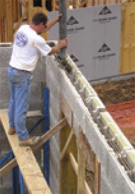

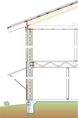

Durability — A high-performance home is a lasting home, and maintains its performance over time. There is no simpler nor more effective way to reduce the environmental footprint of a building than by making it last longer. Durability is a three-legged stool that requires due diligence in design, specification, and workmanship. The architect, the builder, and the trades must achieve durability in concert. The Building America Zero Energy Home of North Texas will long stand as a testament to durability, with its ventilated claddings, engineered wall assemblies, and painstaking attention to moisture
control details.
