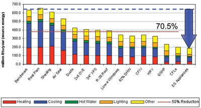

Estimated Annual Energy Savings: Average 70.5% projected source energy savings relative to the 2008 Building America Benchmark

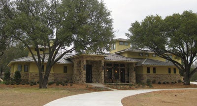

BSC collaborated with Greencraft Builders, LLC in Colleyville, TX on a 2009 prototype house called the Colleyville House. This house demonstrates the energy efficiency and durability upgrades that Greencraft currently promotes in all of their products. The Colleyville house is located in Colleyville, TX, about 25 miles North West of Dallas. The house was designed by William Peck and Associates, an award winning architect specializing in sustainable energy efficient architecture.

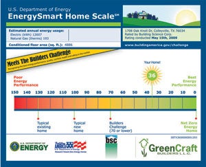

BSC has been collaborating with Greencraft homes since 2005 and have forged a valuable working relationship. BSC provided consulting services for Greencraft and recommended numerous efficiency and durability improvements. One of the main features that separate this home from previous projects is the inclusion of a high efficiency ground source heat pump. Other key upgrades include an unvented roof with low density spray foam insulation and supplemental dehumidification. Also included are LoE3 next generation spectrally selective glazing treatment and very low enclosure infiltration. A full CFL lighting package plus Energy Star® appliances help to achieve a HERS Index of 36.

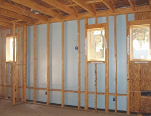

Greencraft constructs with full Advanced Framing in their walls, roof, and frame floor. This includes 2x6 studs at 24” o.c. plus two stud energy corners and single top plates. Greencraft employs stack framing so that wall and floor framing members are aligned to transfer loads efficiently through the structure.
The wall cavity is fully insulated with low density open cell spray foam to an R-20. The roof is an unvented cathedralized roof with R-30 low density open cell spray foam installed to the underside of the roof sheathing.
The Colleyville house was able to procure high quality fiberglass framed windows with state of the art LoE3 spectrally selective glazing coating. This resulted in an NFRC full unit SHGC rating of 0.34 with a U-value of 0.29. This glazing coating, coupled with extensive overhangs in the floor plan, results in a greatly reduced cooling peak load and annual cooling energy use.
A high efficiency ground source heat pump (18.8 EER/4.1 COP) is installed along with a integrated supplemental dehumidification. All the equipment and ductwork is located in the unvented cathedralized attic to save living space. Jump ducts provide passive returns from the bedrooms. High efficiency exhaust ducts are installed at all the bathrooms and at the kitchen hood.
Parametric Study

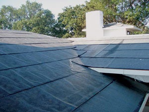

Roof Assembly: Unvented roof with R-30 open cell spray foam and fully-adhered waterproof membrane
Fully-adhered waterproof membrane
Wall Assembly: Fully advanced framed structure; R-24 wall with R-20 open cell spray foam and 3/4” XPS sheathing
Advanced framing with XPS sheathing

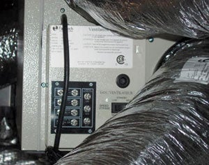

Ventilation: Fantech energy recovery ventilator (ERV).
Energy recovery ventilator (ERV)

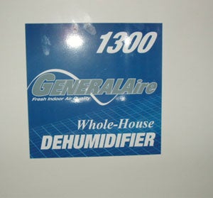

Supplemental Dehumidification: GeneralAire whole-house dehumidifier integrated with HVAC system.
Dehumidifier cover

Greencraft Builders, LLC utilizes Central Fan Integrated Supply ventilation that draws outside air via a 6” flex duct to the return plenum of the HVAC system. This allows for the introduction of outside air to the living space whenever space conditioning is already operating. The GeneralAire whole house dehumidifier draws air from the main living space and supplies dehumidified air to the supply plenum of the HVAC system. An Aprilaire® Ventilation Control System 8126 communicates with the air handler to employ fan cycling. Fan cycling will turn on the fan at a 33% duty cycle (10 minutes on, 20 minutes off) in order to provide outside air during periods of no space conditioning. A 6” mechanical damper is installed on the 6” outside air duct. This is controlled by the fan cycler and will close off the outside air duct during periods of consistent space conditioning to prevent over ventilation of the living space.
Bathroom exhaust fans plus a kitchen hood are installed to provide spot ventilation when necessary. These are all routed to the outside and are not re-circulating fans. One of the bathroom fans is rated to provide ASHRAE 62.2 ventilation so that the house can be operated at that rate if needed.

Second, the homeowners requested a dark metal roof for aesthetic purposes. Greencraft had to work to find an ENERGY STARr® rated dark metal roofing material in a short period of time.
Third, the homeowners also requested a higher roof pitch to match the 10:12 roofs in the neighborhood. A 10:12 roof pitch greatly reduces the overhang potential for shading purposes so Greencraft compromised by increasing the roof pitch from the original 4:12 to 6:12. A 6:12 pitch still allowed for the specified overhangs to be constructed.
