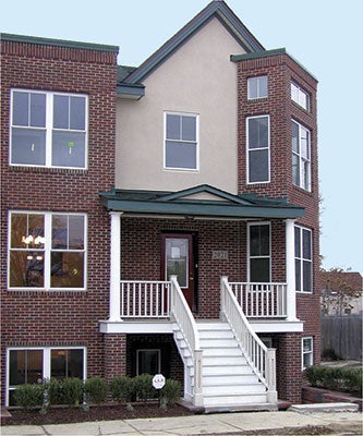

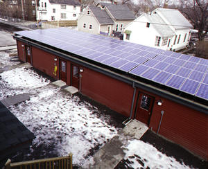

Building A front elevation (above left); solar panels on Building A garage (above right)

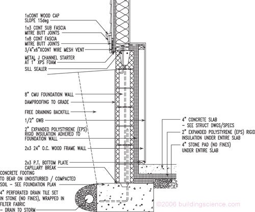

Foundation detail:
Note the type and location of rigid insulation in terms of both thermal and moisture performance, the complete and continuous drainage details for bulk moisture and the air sealing details as the foundation meets the framing assemblies above.

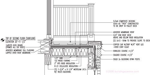

Balcony detail:
Although the roof lines of the main structures are relatively straightforward, there are complex cladding, flashing, and air sealing details for the second story proches and the bump-out column bay on Unit 1. Achieving superior energy efficiency and durability with these details requires detailed drawings for follow-through during construction.

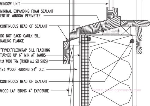

Wall section
: For each type of exterior wall cladding (and there are three—brick, stucco, and lap siding), the wall assembly is tuned in terms of maintenance of the drainage plane, back-venting of the cladding, air infiltration barrier, vapor retarding properties of materials, and thermal insulation employed. Each wall system is an integrated system controlling the movement of heat, moisture, and air.
