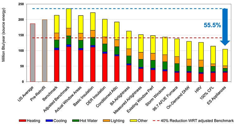

Estimated Annual Energy Savings: 55% energy use reduction compared to the homesize-adjusted Building America benchmark; $2,800 estimated annual savings

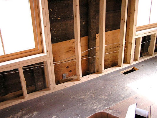

As an alternate to the already comprehensive renovation planned, the builder offered a high performance package to meet the objectives of the National Grid Deep Energy Retrofit Pilot. This package included extensive use of medium density spray foam insulation and construction of a 2x4 stud wall to the interior of existing exterior walls in order to accommodate a greater thickness of foam.

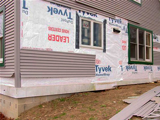

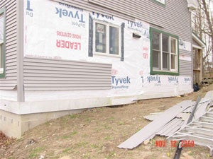

BSC expressed concern that adding a thick layer of air-impermeable, vapor-retarding insulation to the interior without assuring proper water management on the outside, would put this 250 year-old structure at risk. BSC called for remedial flashing at windows and inspection of other flashing details. Inspection of water management details revealed numerous problems which necessitated installation of new flashings and corrections to the drainage plane.

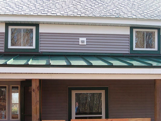

After some discussion and analysis by BSC, the builder elected to include the small attic space within the thermal enclosure. This allowed for the new ducted heating distribution system to be entirely contained within the thermal enclosure.

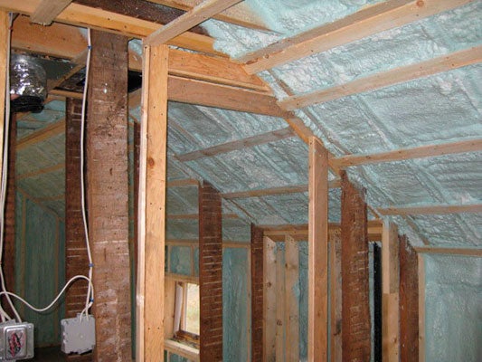

Roof Assembly: Compact (unvented) roof assembly with existing 2x8 rafter framing and 2x3 cross furring, framing cavity and portion of furring cavity filled with R-56 Demilec Heatlok Soy™ medium density spray foam insulation.
Roof Assembly
Wall Assembly: 2x4 stud wall constructed to inside of original post and beam frame with 1” gap between existing and new framing. R-32 (~5”) medium density spray foam insulation sprayed into wall cavities and over rim beam.
Wall Assembly

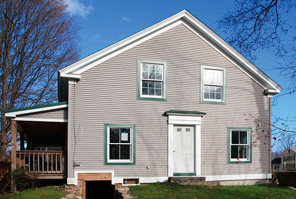

Window Specifications: New Harvey Tru Channel storm windows over existing wood-framed, double-glazed, low-E windows; approx. composite performance: U=0.25, SHGC=0.52.
Air Sealing: Continuous layer of medium density, closed-cell spray foam insulation provides air flow control in the field of the wall and roof assemblies. Spray foam insulation also applied at rim beams and in a floor assembly over a crawl space. Low-expansion foam sealant applied around windows and doors, and at any mechanical or electrical penetrations through the enclosure.
Air Sealing

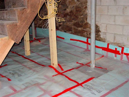

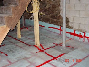

Foundation Assembly: Conditioned basement with 3-5” medium density spray foam insulation applied directly to field stone and concrete foundation walls. Spray foam insulation painted with Blaze Lok 1B™ ignition barrier paint. A 12” high strip of 2” XPS as the slab perimeter thermal break also allows foundation walls to drain to the sub-slab drainage system. Several trenches with drainage pipe connected to drain and filled with gravel manage bulk water. New cast concrete basement floor slab over 6 mil poly, 2” XPS and continuous bed of gravel.
Foundation Assembly

The target air tightness of the closure in BSC’s Building America work is 2.5 in2 of effective leakage area per 100 ft2 of building enclosure area. For this home the target corresponds to ~925 cfm at 50 Pascals (cfm50) or 0.25 cfm50 per ft2 of enclosure. The National Grid Deep Energy Retrofit Pilot set an even more aggressive air leakage target of 0.1 cfm50 per ft2 of enclosure. BSC measured air leakage of 468 cfm50 or 0.13 cfm50 per ft2 of enclosure. While falling just short of the Pilot target, these results are, nonetheless impressive and are a testament to how well the builder used the medium density spray foam to create a continuous air flow control layer around the building.
BSC conducted duct leakage testing and found total duct leakage for the nominal 3 ton system to be 98 cfm at 25 Pascals. Testing measured zero cfm of leakage to the outside as was expected with the distribution system entirely contained within the very air tight thermal enclosure of the building.
BSC conducted analysis of the completed project to evaluate its predicted energy use under standard operating conditions. Because the homeowners evince a very low energy lifestyle, it is expected that the actual energy use for this home will be well below that predicted for the home under standard operating conditions.

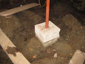

Design Challenge: Converting a Cold, Wet Cellar into a Useable Space
The renovation plans included providing access for the homeowners to wheel their bicycles into the basement. Because these residents of a rural and hilly part of Massachusetts relied upon their bicycles for transportation, condition of the space in which they store their vehicles is very important.
Prior to the renovation project, the basement was a cold and damp space. It often contained standing (sometime flowing) water. The homeowner and builder combined efforts to dig trenches in the basement, install drainage piping draining to daylight, and load several cubic yards of gravel into the basement. To supplement these liquid water control measures, BSC recommended an insulated concrete slab in contact with a polyehtylene sheet to provide condensation control, vapor diffusion control and to control convective (air flow) transfer of moisture and soil gases into the space. BSC also provided a detail to ensure that, after spray foam insulation is installed against the foundation walls, any water that leaks through the walls is able to drain into the sub-slab drainage system.
