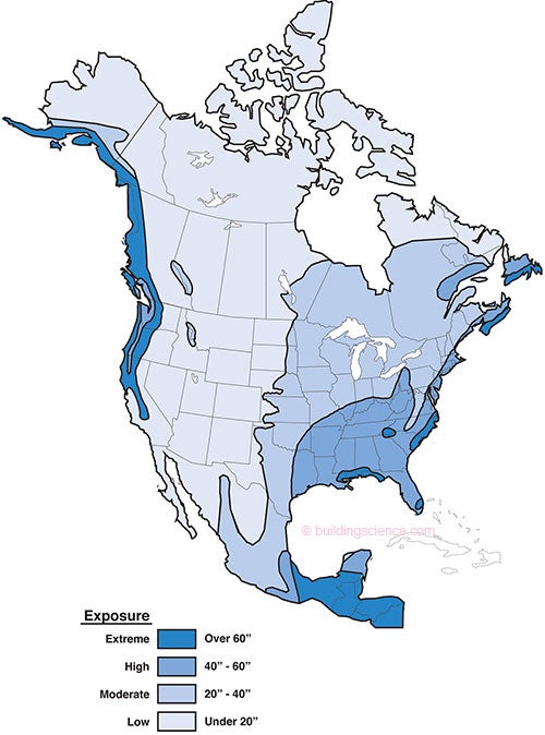

Figure 2: Rainfall
—From “Moisture Control for Buildings” ASHRAE Journal, February 2002. Where it rains more buildings get wetter. Yup. Cold and rain, double yup.

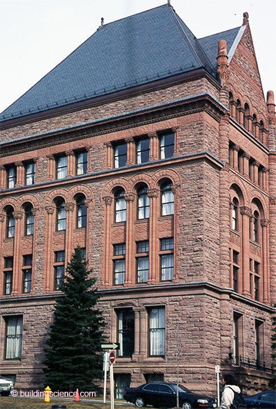

Photograph 1: Getting It Right—Classic building at University of Toronto “Romanesque”. Look at all the drip edges – at roof edges, at window openings, between floors. Notice that they are working. How can you tell? No stains. Look at this building carefully because it is an example of “what is good”.

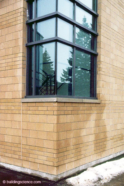

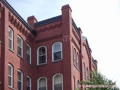

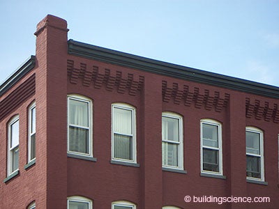

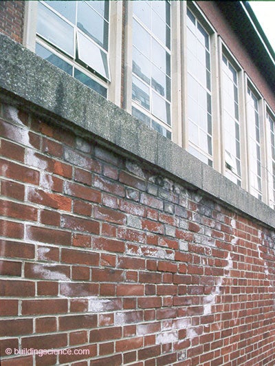

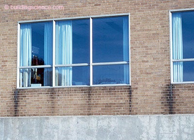

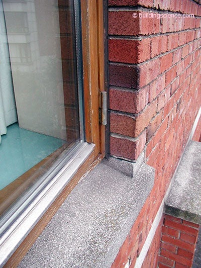

You want to see stuff that is not good? Look at Photograph 2. Pretty obvious, eh? How about Photograph 3 and Photograph 4? Windows are places where water is concentrated. Why? Well, large expanses of glass don’t absorb water. Water runs down them and ends up at corners that are typically “inset” with surfaces that don’t slope. It gets worse, the windows themselves leak and act as “syringes” for “liquid crack” that inject poison into the body of an assembly5. The openings need drip edges, end dams, back dams and slopes and kerfs. You want to know how to do it right? Go to Ireland and look at real old stuff (Photograph 5) and not so old stuff but still old (Photograph 6).
Photograph 2: Getting It Wrong
—Look at the stains. Large expanses of glass don’t absorb water and water runs down them and ends up at corners that are typically “inset” with surfaces that don’t slope. It gets worse, the windows themselves leak. Look at the bottom of the mullions where they meet the sill.
Photograph 3: Getting It Wrong Continued
—New building not yet screwed up but going to get there soon. We can do better than this. This is obviously a new building but the style comes directly from Frank Lloyd Wright. Frank Lloyd Wright was wrong.
Photograph 4: Getting It Wrong Turning into Ugly—Efflorescence and freeze-thaw damage occurring and the cause is a combination of bad water control and bad brick. Could good brick have survived the bad water control? Maybe. But with good water control even the bad brick would have lived.

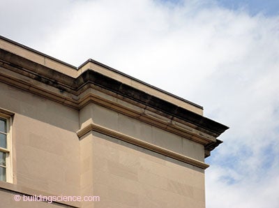

What if you have a building that does not have this neat stuff? Well you can add it. And you can typically add it in such a way as to not irritate the historical preservationists.6 Check Photograph 7 and the detail that was used to make the difference (Figure 3). Reversible but critical to adding decades to the longevity of the façade.
Photograph 7: Courthouse in Washington

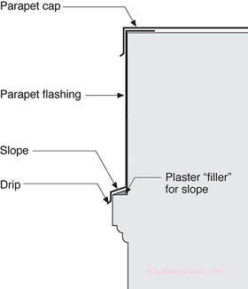

—Can’t tell you which one or I will end up in jail. And not just any courthouse—an unbelievably beautiful courthouse—but a parapet without a drip edge. Look at the stains. Criminal. The fix is in Figure 3.
Figure 3: Retro Parapet Drip Edge
—Reversible but critical to adding decades to the longevity of the façade.

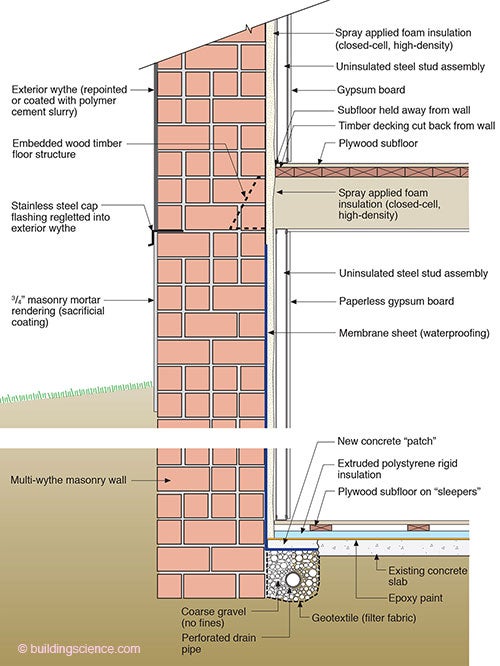

Side note: Basement foundations can be a bear. Use the approach in Figure 4. It works everywhere (see “BSI-011: Capillarity–Small Sacrifices”).
Figure 4: Basement Foundation Retrofit
—This works everywhere (see “BSI-011: Capillarity–Small Sacrifices”). This will not work with air permeable insulation that is moisture sensitive. No fiberglass or cellulose below grade in this type of assembly. You can add fiberglass or cellulose to the interior of the spray foam in this assembly, but not instead of the spray foam in this assembly. Further note that we are talking the high-density closed-cell stuff.

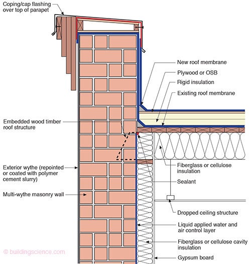

Figure 6: Roof Insulation Cold Climates
– Get a look at that parapet. Drip edge and slope to the back-side. Roof membrane over the top. Secondary membrane over the top of that. Does not get better than this. The spray applied foam needs to be protected with a fire resistant layer.

Figure 9: Roof Insulation Everywhere Else
– Note the parapet. Note that in this assembly rigid insulation is installed above the roof deck to control condensation. This is also an excellent strategy in cold climates or colder.
