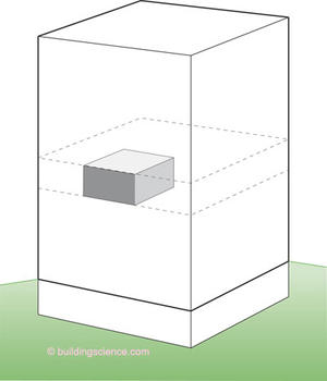

Figure 1: Multifamily Compartmentalization—Individual units are air sealed and tested by pressurization or depressurization for compliance.
It gets better – or worse depending on your perspective. Now we have a “compartmentalization” tightness requirement for apartments and multifamily buildings2 to go with these higher flow rates (Figure 1). We are getting pretty good at compartmentalization (Photograph 1, Photograph 2 and Photograph 3). Not as good as some folks think, see previous footnote, but pretty good.

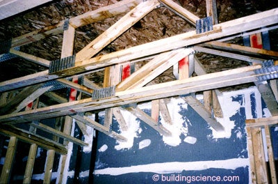

Photograph 1: Compartmentalization Air Sealing—Gypsum board is run up to the underside of the floor sheathing above and sealed with joint compound.

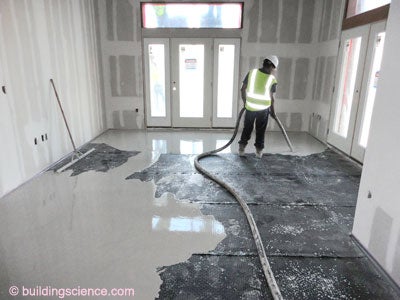

Photograph 2: More Compartmentalization Air Sealing—Bottom of walls are sealed fabulously well when gypcrete floors are used.

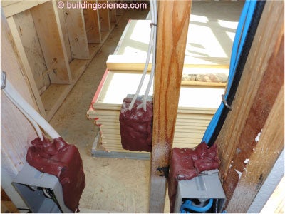

Photograph 3: Airtight Electrical Box—Putty pads are used to seal electrical boxes airtight. Joint compound is used to complete the seal between the electrical box lip and the cut opening in the gypsum board.

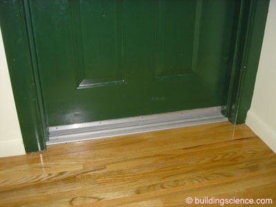

Now comes the interesting question. Where is the make up air going to come from? It can’t come from the corridor. The corridor doors are also required to be weather-stripped (Photograph 4) and even if they were not weather-stripped and undercut it is a bad idea to do that in any event for smoke control and fire spread reasons. It can’t come from the neighboring units, which was the whole point of the compartmentalization. It has to come from the outside. Duh. But to keep the pressures reasonable you need a really big hole.3 No one is ever going to do this. The big hole will lead to comfort problems (Photograph 5).
Photograph 4: Weather-Stripped Door—A beautiful thing if you are worried about fires – an ugly thing if you need make-up air.

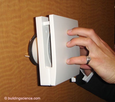

Photograph 5: High Tech Big Hole—Good for about 25 cfm, so you need three or four per apartment. They diffuse the incoming air to avoid cold spots and drafts.
The Standard 62.1 and Standard 62.2 folks say that you are not required to use exhaust only ventilation. You can use supply ventilation or balanced ventilation. That is true. But what is true is that both Standard 62’s effectively eliminate the use of exhaust only ventilation because it no longer can be made to work in apartments and condominiums constructed to the required tightness standards. The only remaining good news is that exhaust ventilation can still be made to work in single-family detached houses without atmospherically coupled combustion appliances – although as an approach exhaust only ventilation is a pretty poor excuse for ventilation.

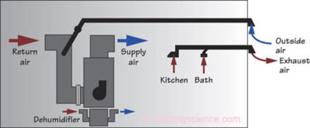

So how do you actually do this? How do you meet the ventilation rate requirements and the tightness requirements and get something that works? One way is to install a roof top unit that preconditions the air and then duct it down to each corridor and then into each individual apartment unit. You couple this with bathroom exhaust and kitchen exhaust. As an engineer I do not have a problem with this. This is actually pretty darn good. It is just that I don’t think folks understand that there is a new sheriff in town and that this is now the deal.4 What else can you do? You can do a balanced system such as an HRV or an ERV (Figure 2). As an engineer I would love to do this in units. I like Porsches too.

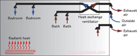

Figure 2: Fully Ducted HRV or ERV—The “Porsche” of ventilation systems. Only slightly less expense than a Porsche …. and certainly not as much fun. Kitchen exhaust is vented separately – not through the HRV or ERV. I prefer not to run the bathroom exhaust through them either, but I am in the minority.

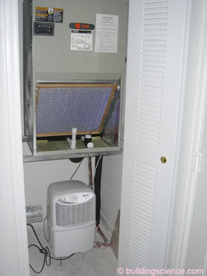

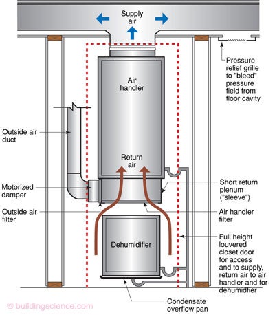

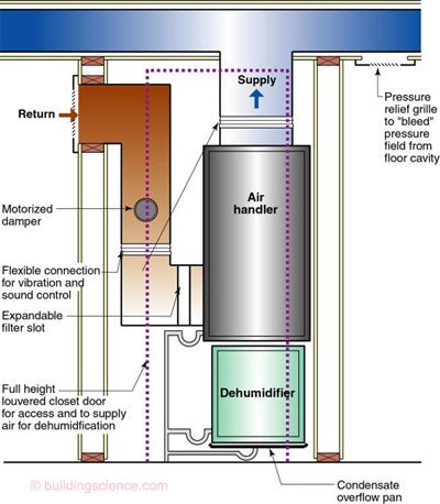

We are not done yet. At the flow rates we are now talking about we have a part load humidity problem is many parts of the Republic. Note that we are actually building energy efficient houses, apartments and condominiums. We have great windows with low SHGC’s, compact florescent lighting and enclosures that are actually insulated well. Ah, here is the rub. No load, no cooling, no dehumidification from cooling. Oops. Now we need dehumidifiers (Figure 3, Figure 4 and Photograph 6) in houses if they are small and for sure we need them in apartments and condominiums.5
Figure 3: Dehumidifier in Return Closet—Standard off-the-shelf dehumidifier inside a return closet. Works great. Folks hate this because the return is not ducted. Not a rational objection in my view, but what do I know?
Figure 4: Dehumidifier with Ducted Return—Standard off-the-shelf dehumidifier in a closet with a hard ducted return.
Photograph 6: Low Tech Dehumidifier—One of those standard-off-the-shelf things that are plumbed such that they drain directly into the condensate drain.
