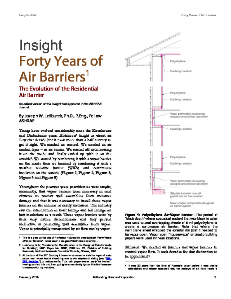

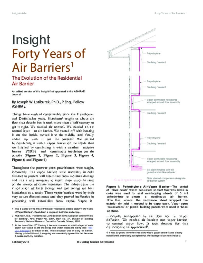

BSI-084: Forty Years of Air Barriers*—The Evolution of the Residential Air Barrier
Things have evolved considerably since the Eisenhower and Diefenbaker years. Hutcheon2 taught us about air flow that decade but it took more than a half century to get it right. We needed air control. We needed an air control layer – an air barrier. We started off with locating it on the inside, moved it to the middle, and finally ended up with it on the outside3. We started by combining it with a vapor barrier on the inside then we finished by combining it with a weather resistive barrier (WRB) and continuous insulation on the outside (Figure 1, Figure 2, Figure 3, Figure 4, Figure 5, and Figure 6).
Figure 1: Polyethylene Air-Vapor Barrier
—The period of “black death” where acoustical sealant that was black in color was used to seal overlapping sheets of 6 mil polyethylene to create a continuous air barrier. Note that where the membrane sheet wrapped the exterior rim joist it needed to be vapor open. Vapor open “housewraps” or plastic building papers were used in these locations.

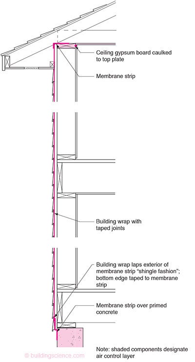

Figure 4: Air Infiltration Barrier
—Plastic housewraps were developed and had two functions – rainwater control and air control.

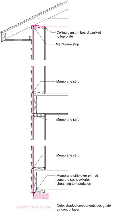

Figure 5: Exterior Sheathing Air Barrier
—Turning the sheathing itself into both the water control layer and air control layer.

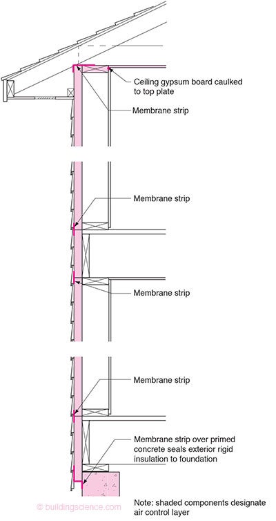

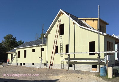

Figure 6: Insulating Sheathing Air Barrier
—Adding the function of thermal control to the sheathing in addition to water control and air control.

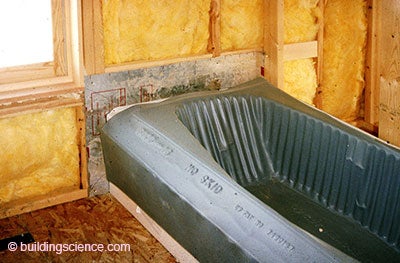

The focus shifted to targeting only the interior big holes using sealed rigid draft-stopping. Bathtubs and shower enclosures on exterior walls, fireplace assemblies on exterior walls, soffits dead ending in exterior walls, dropped ceilings at enclosure perimeters, garage-to-house connections and cantilevers (Photograph 3 and Photograph 4). A “lite” version “airtight drywall approach”. It became relatively easy for production homebuilders to get below 3 ach@50Pa and the approach morphed into the EPA Energy Star “thermal bypass checklist” and eventually found its way into the model codes5.
Photograph 3: Bathtub on Exterior Wall
—Targeting the big holes with rigid draft-stopping. Of course an even better approach is not have a bathtub on an exterior wall…

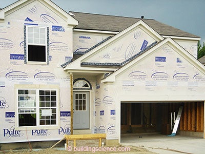

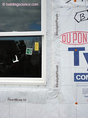

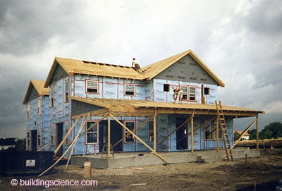

Why not turn the exterior building paper into the air barrier? Tarpaper was already being used for rainwater control purposes. Why not turn it into an air barrier? Good idea in principle, but tarpaper was not the product up to the task. You could not tape tarpaper and it only came in narrow rolls6. Plastic housewraps were developed and the exterior “air infiltration barrier”7 was introduced (Figure 4 and Photograph 6).
Photograph 6: Air Infiltration Barrier
—Classic housewrap rainwater control layer and air control layer. Note the beautiful job of flashing integration with the housewrap. The outside is the right place for air control.
It was an amazing transformation in retrospect. Tarpaper was introduced first to control air and then it took on a rain control function. Its original air control function was forgotten when sheet goods like plywood and OSB replaced exterior (and very air leaky) board sheathing. Now the air control function was back. But to a production builder, the water control function was still more important. And for good reason, builders do not get calls in the middle of the night saying their buildings are leaking air, but they do get those calls when they are leaking rainwater.
The “new” air infiltration barriers needed to be robust rainwater control layers. Numerous elegant and clever accessories were introduced to deal with rainwater control particularly at window-to-wall interfaces (Photograph 7 and Photograph 8).

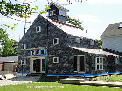

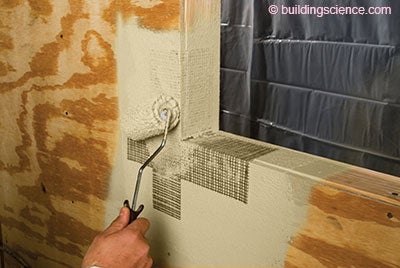

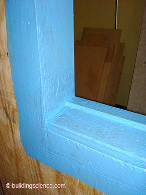

On the commercial side fluid applied air barriers began to make inroads due to their competitive cost and relative ease of installation. It was only a matter of time before they appeared residentially (Photograph 10 and Photograph 11). Overcoming the technical challenges has not proven to be easy. The coatings needed to be able to span joints and they needed to be vapor permeable. And their most important function, rainwater control could not be compromised. After a decade of experience – principally on the commercial side – we are seeing products that are working. Origami is no longer a required skill to flash a window opening (Photograph 12 and Photograph 13)8.
Photograph 10: Fluid Applied Air Barrier
—The coatings needed to be able to span joints and they needed to be vapor permeable. And their most important function, rainwater control could not be compromised.
Photograph 11: Water Control/Air Control Continuity
—The fluid applied coating must connect to the air control layer of the roof assembly and to the air control layer of the foundation assembly.

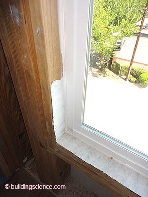

Photograph 12: Window Opening
—Origami is not a necessary skill with fluid applied flashing systems.
Photograph 13: Another Window Opening
—Some systems require fabric reinforcement at critical interfaces.

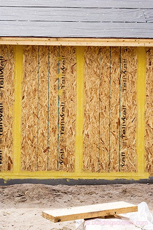

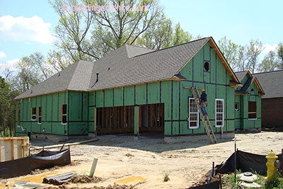

What about turning the sheathing itself into both the water control layer and air control layer? Yes, see Photograph 14 and Figure 5. You could even have the sheathing be the thermal control layer (Figure 6 and Photograph 15).
Photograph 14: Sheathing Water and Air Control Layer
—The sheathing in this system is pre-coated with a water control layer. Tape is used provide water control and air control layer continuity.
Photograph 15: Insulating Sheathing Water and Air Control Layer
—The insulating sheathing provides three functions in this approach – water control, air control and thermal control.
