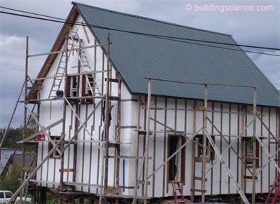

Photograph 1: Extreme Enclosure
—“Superinsulated” does not do justice to this house constructed by the Hydaburg Tribe in Alaska that is ultra-airtight and ultra-vapor tight (less than 0.5 ach at 50 Pa [0.20 in. w.c.] and less than 0.5 perms).

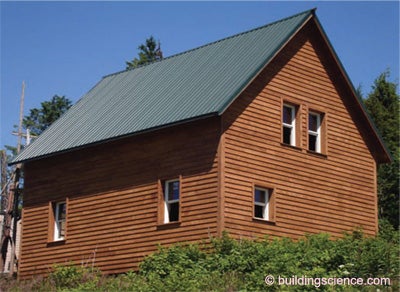

Photograph 2: Exterior insulation
—Multiple layers of rigid insulation on the exterior of a wood-frame structure held in place with wood furring strips. Note the inset location of the windows allows the water management layer of the window to connect to the water management layer of the exterior wall (the fully adhered membrane).

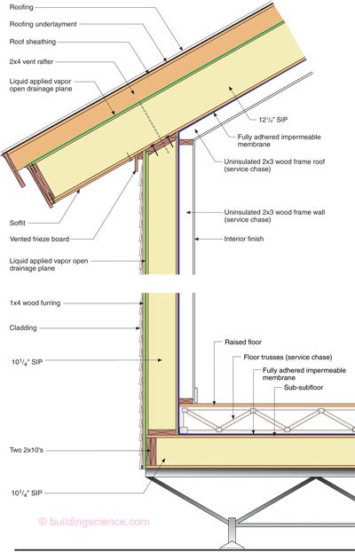

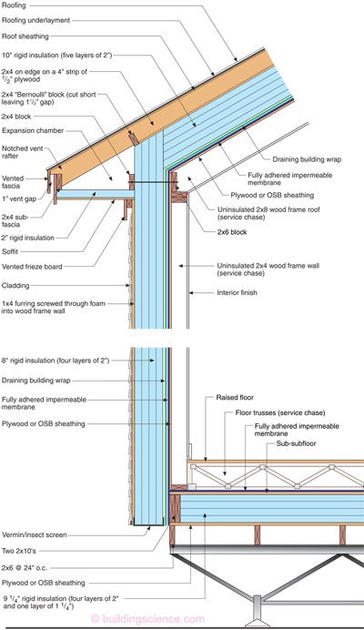

Figure 1: Extreme Enclosure Section
—Building supported on space frame. Note the vented frieze board, the vented facia, the insulated soffit, and the Bernoulli blocked soffit expansion chamber to control snow entry. The roof and wall assemblies are drained to the exterior between the exterior rigid insulation and the exterior (to the structure) fully adhered impermeable membrane. This membrane is the air barrier, as well as the vapor barrier for this structure.

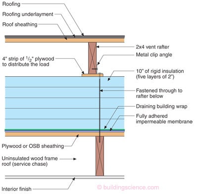

Figure 2: Roof Section—The vent rafters are connected through the roof rigid insulation with a metal bracket and a long roofing screw. Note the 4 in. (100 mm) strip of plywood under the rafter to distribute the load due to the limited compressive strength of the rigid insulation.

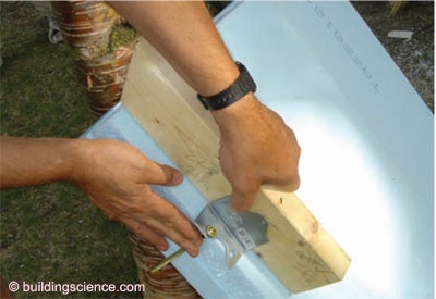

Photograph 3: Ventilation Rafter
—The 2x4 (standing proud) is connected through the roof rigid insulation with a metal bracket and a long roofing screw. You can purchase 14 in. (356 mm) long epoxy-coated steel screws. Stay away from stainless steel screws because the heads twist off. Stainless steel tends to be soft. Ask me how I know.
Putting it all together in a system that works and that is constructable is not easy. We have learned elsewhere, in high snow-load areas, how best to deal with ice dams. We need a ventilated roof cladding to deal with the thermal resistance of snow. The roof cladding needs to be at the same temperature as the exterior. When the outside temperature is below freezing, the roof cladding must be below freezing. If it is above freezing, the snow melts, runs to the edge of the roof and freezes. Then, we get big hunks of ice that can fall down and hurt you big time. Oh, they also dam up the melt water and the roof leaks, hence the term ice dam.
Because snow has an R-value4  (remember the igloo?), we need to flush heat away from the underside of the roof cladding using ventilation. That part is easy. What is difficult is keeping snow out of the ventilation space, and then designing an assembly that can live with the snow getting in anyway. Stuff happens. We can go to a long-dead European by the name of Daniel Bernoulli to help us out.
Bernoulli’s equation tells us that if we have a fluid flowing in a pipe, and a sudden enlargement exists in the pipe, there will be a corresponding drop in pressure. If we then shrink the pipe again, we have an increase in pressure. Folks will recognize this as an expansion chamber. We can use the concept of an expansion chamber to control rain entry and snow entry into soffits. If you have a sudden drop in air pressure the air typically gives up the snow or rain droplets it is carrying. By turning the soffit into an expansion chamber, we can collect the snow in the soffit, rather than have it migrate farther up the ventilated roof cavity. Once in the soffit, we can let the snow eventually melt there and then drain the snow melt out. But just in case, because stuff happens, we’ve learned to design the entire ventilated roof cavity to be able to drain snow melt out.

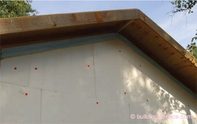

Photograph 4: Mock-up Constructed First
—Things never go together perfectly the first time, which is why test huts, test sections, and mock-ups are essential. Again, ask me how I know. Failure is not an option north of the Arctic Circle. Skill testing question for the geeks in the audience: what are the red dots?

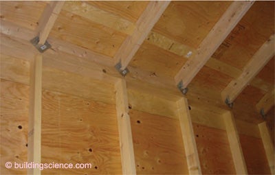

Photograph 5: Interior Structural Frame
—The wood-frame wall cavities and wood rafter roof cavities remain uninsulated to control cavity condensation. The cavities provide space for services. The air barrier membrane and vapor barrier membrane are exterior to the wall and roof framing.
