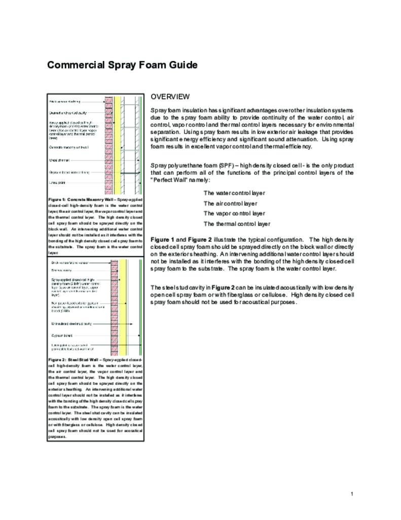

Spray foam insulation has significant advantages over other insulation systems due to the spray foam ability to provide continuity of the water control, air control, vapor control and thermal control layers necessary for environmental separation.  Using spray foam results in low exterior air leakage that provides significant energy efficiency and significant sound attenuation.  Using spray foam results in excellent vapor control and thermal efficiency.
Spray polyurethane foam (SPF) – high density closed cell - is the only product that can perform all of the functions of the principal control layers of the “Perfect Wall” namely:
The water control layer
The air control layer
The vapor control layer
The thermal control layer
Figure 1 and Figure 2 illustrate the typical configuration.   The high density closed cell spray foam should be sprayed directly on the block wall or directly on the exterior sheathing.  An intervening additional water control layer should not be installed as it interferes with the bonding of the high density closed cell spray foam to the substrate.  The spray foam is the water control layer.
The steel stud cavity in Figure 2 can be insulated acoustically with low density open cell spray foam or with fiberglass or cellulose.  High density closed cell spray foam should not be used for acoustical purposes.
Figure 1:  Concrete Masonry Wall – Spray-applied closed-cell high-density foam is the water control layer, the air control layer, the vapor control layer and the thermal control layer.  The high density closed cell spray foam should be sprayed directly on the block wall.  An intervening additional water control layer should not be installed as it interferes with the bonding of the high density closed cell spray foam to the substrate.  The spray foam is the water control layer.
Figure 2:  Steel Stud Wall – Spray-applied closed-cell high-density foam is the water control layer, the air control layer, the vapor control layer and the thermal control layer.  The high density closed cell spray foam should be sprayed directly on the exterior sheathing.  An intervening additional water control layer should not be installed as it interferes with the bonding of the high density closed cell spray foam to the substrate.  The spray foam is the water control layer.  The steel stud cavity can be insulated acoustically with low density open cell spray foam or with fiberglass or cellulose.  High density closed cell spray foam should not be used for acoustical purposes.
