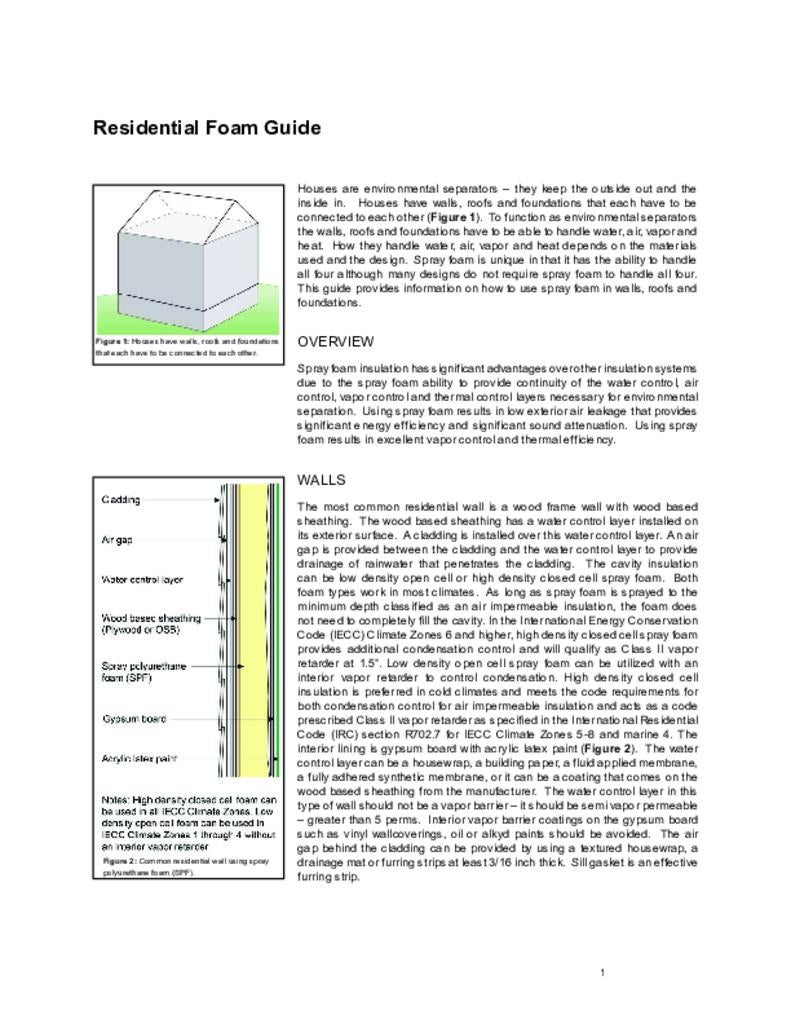

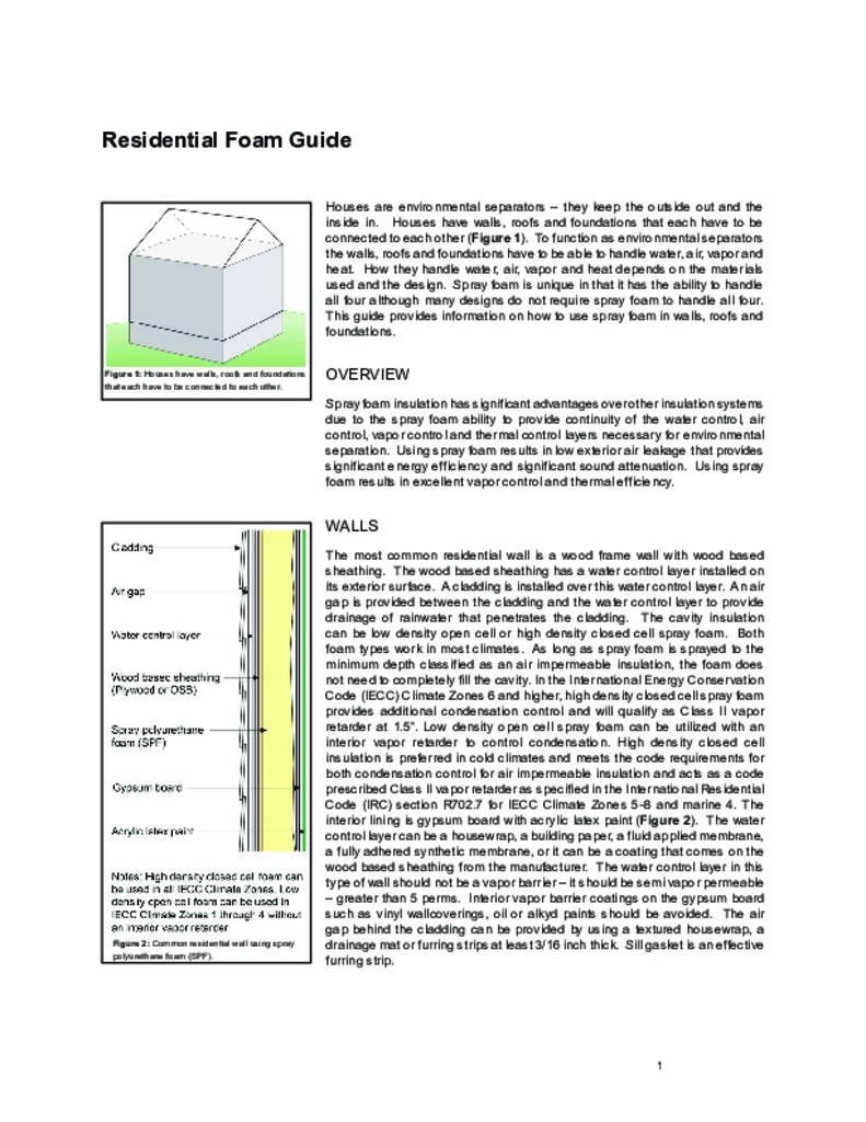

Houses are environmental separators – they keep the outside out and the inside in. Houses have walls, roofs and foundations that each have to be connected to each other (Figure 1). To function as environmental separators the walls, roofs and foundations have to be able to handle water, air, vapor and heat. How they handle water, air, vapor and heat depends on the materials used and the design. Spray foam is unique in that it has the ability to handle all four although many designs do not require spray foam to handle all four. This guide provides information on how to use spray foam in walls, roofs and foundations.
Figure 1: Houses have walls, roofs and foundations that each have to be connected to each other.

WALLS
The most common residential wall is a wood frame wall with wood based sheathing. The wood based sheathing has a water control layer installed on its exterior surface. A cladding is installed over this water control layer. An air gap is provided between the cladding and the water control layer to provide drainage of rainwater that penetrates the cladding. The cavity insulation can be low density open cell or high density closed cell spray foam. Both foam types work in most climates. As long as spray foam is sprayed to the minimum depth classified as an air impermeable insulation, the foam does not need to completely fill the cavity. In the International Energy Conservation Code (IECC) Climate Zones 6 and higher, high density closed cell spray foam provides additional condensation control and will qualify as Class II vapor retarder at 1.5”. Low density open cell spray foam can be utilized with an interior vapor retarder to control condensation. High density closed cell insulation is preferred in cold climates and meets the code requirements for both condensation control for air impermeable insulation and acts as a code prescribed Class II vapor retarder as specified in the International Residential Code (IRC) section R702.7 for IECC Climate Zones 5-8 and marine 4. The interior lining is gypsum board with acrylic latex paint (Figure 2). The water control layer can be a housewrap, a building paper, a fluid applied membrane, a fully adhered synthetic membrane, or it can be a coating that comes on the wood based sheathing from the manufacturer. The water control layer in this type of wall should not be a vapor barrier – it should be semi vapor permeable – greater than 5 perms. Interior vapor barrier coatings on the gypsum board such as vinyl wallcoverings, oil or alkyd paints should be avoided. The air gap behind the cladding can be provided by using a textured housewrap, a drainage mat or furring strips at least 3/16 inch thick. Sill gasket is an effective furring strip.
Figure 2: Common residential wall using spray polyurethane foam (SPF).
