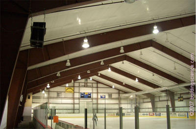

Ice rinks and arenas are a common building type in many communities. The trend over the last 25 years has been to operate these arenas for greater periods of the year, often throughout the summer. Also, an increasing number of such buildings are being built in areas with warm, humid summer weather. The result has been an increase in the number of reported moisture problems, most of which revolve around summer condensation. This digest will describe the causes and discuss potential retrofit solutions for summer condensation in ice arenas.

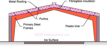

The most common type of ice arena uses a number of large full-span frames of steel or glulam wood with purlins that span from frame to frame supporting the exterior metal cladding and low-slope metal roofing. In many cases the buildings are simple in plan and pre-manufactured metal buildings. The building enclosure usually comprises, from the inside, a heavy plastic liner, a layer of low-density fiberglass insulation, and metal roofing/cladding.
Photograph 1: Typical Ice Arena Interior
Figure 1: Typical Simplified Cross-Section of Arena

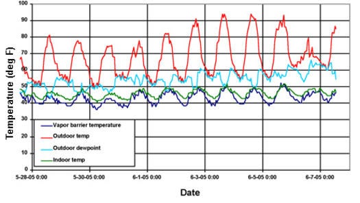

Table 1: Example of measured dewpoint and vapor barrier liner temperature

In most cases the first step should be a confirmation that condensation occurs when the exterior dewpoint temperature is above the measured surface temperature of the interior vapor barrier. This can usually be done cheaply and simply by measurements with a hand held infra-red thermometer. A pair of datalogging temperature and humidity devices (such as a Hobo® from Onset DataCorp), can be used to provide hourly data. The temperature of the vapor barrier liner must be measured over the center of the ice (where it will be the coldest). It should also be confirmed that the interior temperature and humidity are within specs (and that the humidity is kept low enough).

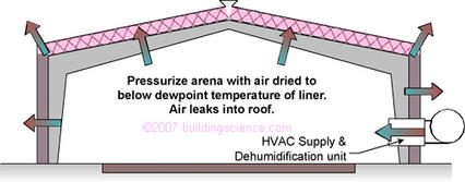

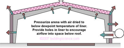

If a major reduction in air leakage has been achieved, the next step in remediation is to control the air pressures acting across the enclosure. The dehumidification/cooling equipment can often be used to generate a net positive pressure, thereby reducing the amount if air that leaks into the enclosure. This can help solve condensation problems at the cost of forcing conditioned air out. If the building is reasonably airtight, simple modifications may be sufficient and cost little in the way of energy.
Ideally, a control strategy would supply air during all warm weather hours (e.g. seasonally), or, to save operational energy, just during times when the outdoor dewpoint temperature exceeds a certain value. The supply air would also be activated when the CO2 or CO sensor indicates the need for ventilation. If the arena has been air-tightened sufficiently, then a moderate volume of supply air will pressurize the arena to more than 5 Pa. This pressurization approach will ensure that any air leakage that does occur will be outward for most of the time. Since the interior dewpoint temperature is well below the liner temperature, condensation will not occur from indoor air entering the insulated cavity. (Note: 5 Pa pressurization may not always stop all inward flow. Small amounts of inward air flow may still occur for short periods of time due to high wind speeds and/or extreme temperature differences, but the condensation that forms might subsequently dry out before sufficient accumulation occurs to cause dripping.)
Figure 3: HVAC unit operated to supply excess air and pressurize
During cold weather an exhaust fan would be operated while the supply air is disabled. This will ensure that cold weather condensation does not occur. Although sophisticated controls could be used to operate this switch over, a simpler manual switch operated once in spring and once in fall is sometimes practical.
If the pressurization available from the HVAC system is not sufficient to solve the condensation problems, the next strategy to investigate is to allow more air to flow directly into the roof-space. This can often be accomplished by cutting a few small (perhaps 4” diameter) holes in the plastic liner one or two spots per bay. This would have the effect of increasing airflow into the roof (which will lower the pressure across the enclosure) but will ensure a greater amount of dry air in the fiberglass-filled roofspace. If the airtightening step is reasonably successful, the overall air leakage rate of the arena will not change much, but the pressure drop will occur almost completely across the metal cladding, not across the combination of the cladding and plastic liner. The seasonal pressurization control strategy would remain the same as described previously.
Figure 4: Pressurize arena and intentionally allow airflow directly into roof space

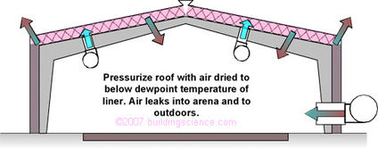

In many cases the steps described earlier will reduce the problem to manageable levels, or even eliminate it. If not, the holes in the liner provided in the last step can be sealed and the roof space pressurized directly with indoor air using small fans. Based on some experience a fan of 50 to 100 cfm/bay may be sufficient to generate a 10 to 15 Pa pressure difference.
This should ensure that no outdoor air leaks into the roof space, and that the space is filled with the relatively dry air of the arena interior. This system would create a constant air loss but the energy penalty is often small if the airtightening has been successfully implemented. This solution trades off a small increase in operational costs for a very low repair cost. The seasonal pressurization control strategy would remain the same.
Figure 5: Pressurize the roofspace directly with the aid of several small fans

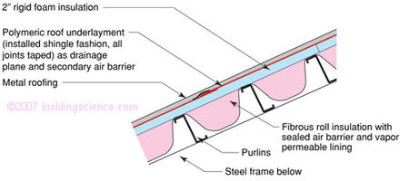

Best practice would be to use the metal over a roof underlayment (installed shingle fashion to act as a drainage plane) with sealed joints (to act as an air barrier) over 2 layers rigid insulation (typically a minimum of 4” of polyisocyanurate insulation) over taped housewrap on plywood or gypsum sheathing, and metal deck spanning between purlins. Alternatively, a single thinner layer of rigid insulation can be used over purlins with roll insulation and a vapor permeable lining.
Figure 6: Best practice roof assembly
Figure 7: Alternative roof assembly
