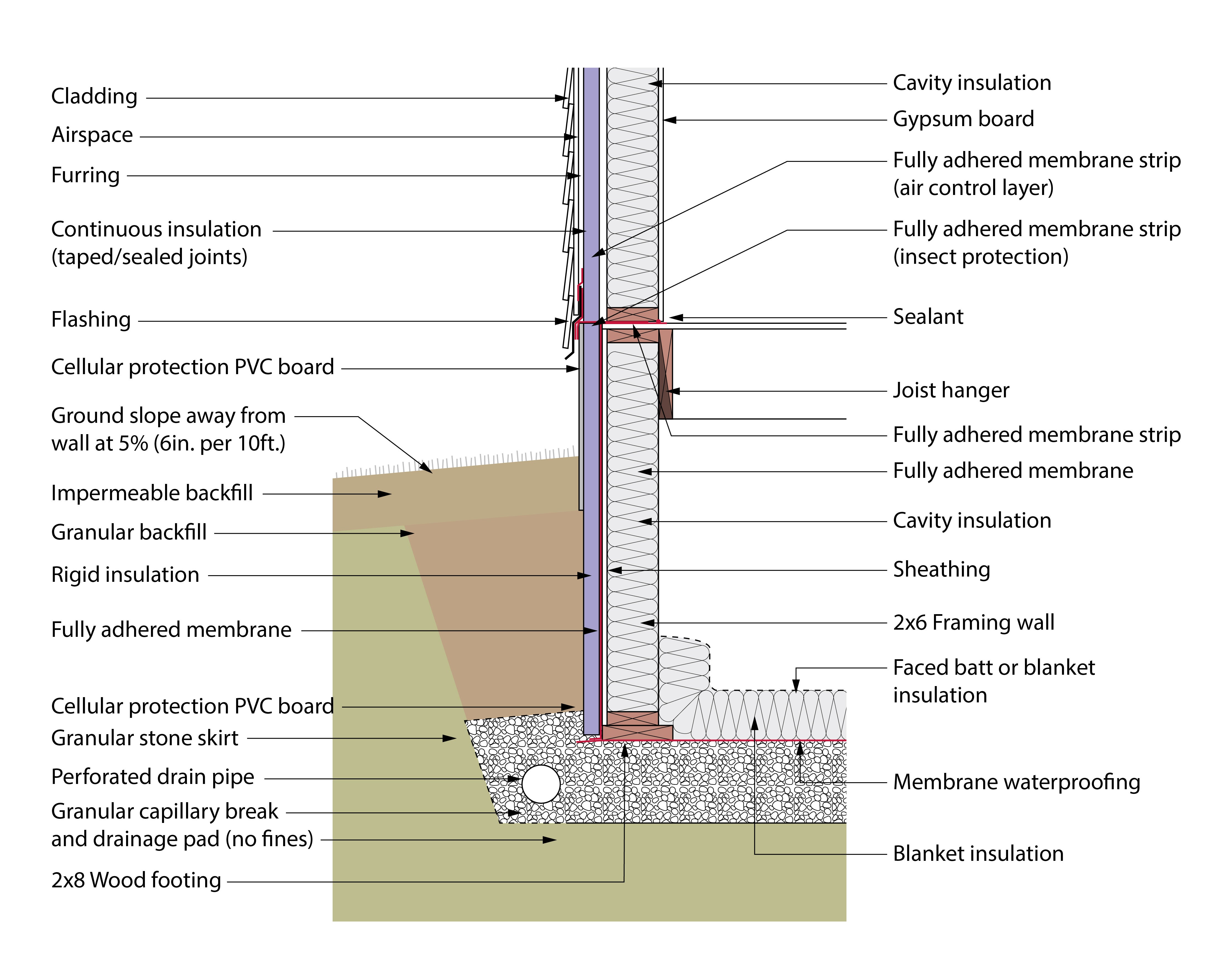

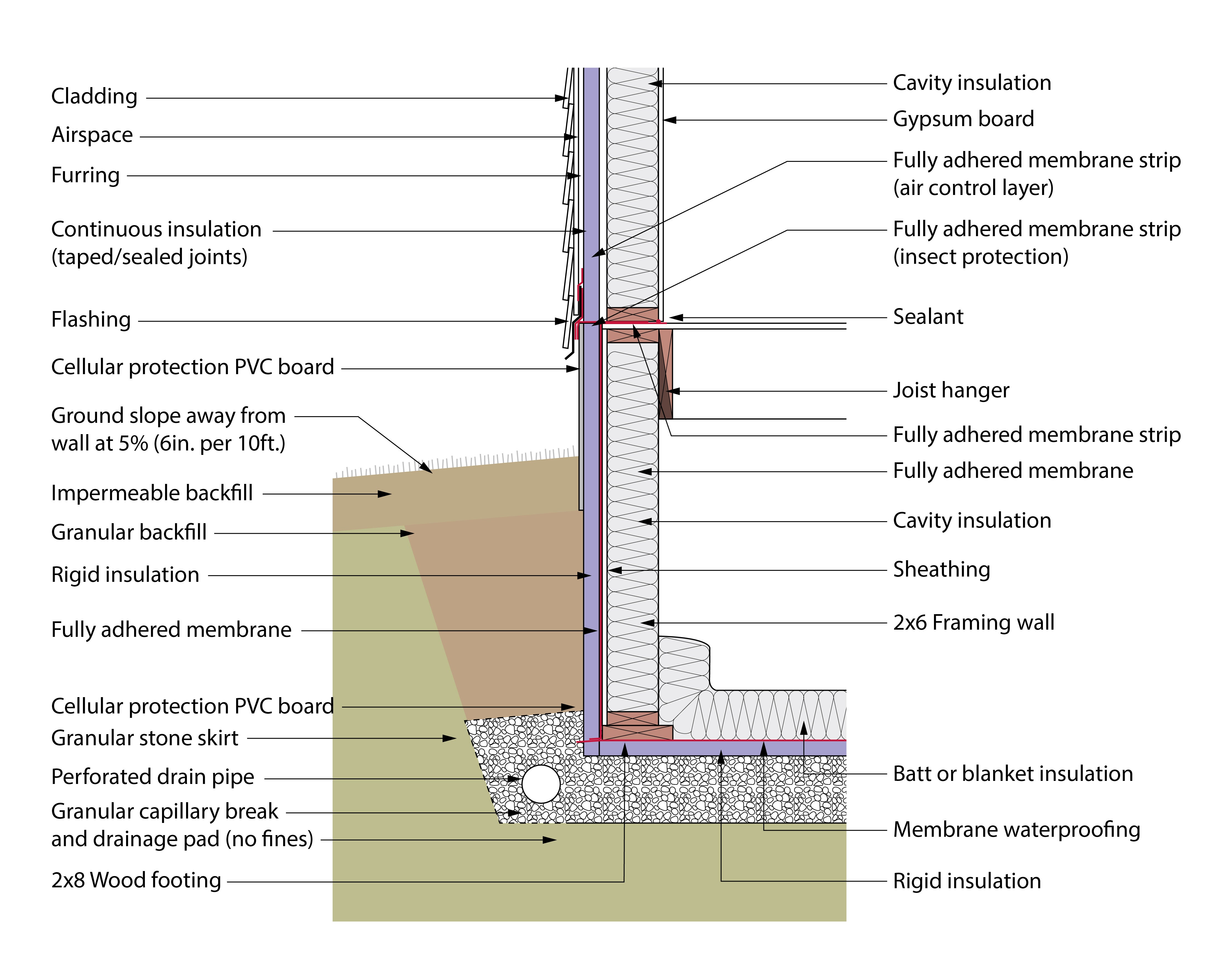

My best current recommendation is to use concrete footings, lay down the rigid insulation under the wood basement floor slab, run a fully adhered membrane over the top of everything including out over the perimeter footings. Then frame the wood basement floor – or use panels. Then frame the exterior walls – or use panels. Then install the fully adhered membrane and continuous exterior draining insulation on the exterior (Figure 1).
Figure 1: Wood Basement Foundation - Use concrete footings, lay down the rigid insulation under the wood basement floor slab, run a fully adhered membrane over the top of everything including out over the perimeter footings. Then frame the wood basement floor – or use panels. Then frame the exterior walls – or use panels. Then install the fully adhered membrane and continuous exterior draining insulation on the exterior.
Note how the main floor is framed below the top of the perimeter wall to handle the “back-fill” load (Photograph 8). Similar approach with the wood basement floor. Back in the day we did not have cellular PVC boards available to act as protection for the above grade portion of the continuous exterior draining insulation. Today….yeah!
Photograph 8: “Balloon Framed Foundation” - Note how the main floor is framed below the top of the perimeter wall to handle the “back-fill” load.
You need to assume that you will have insects wanting to invade. You do not want the continuous exterior draining insulation to act as an “insect interstate”. Note the fully adhered membrane layers acting as insect protection. Also, do not forget about air control layer continuity.

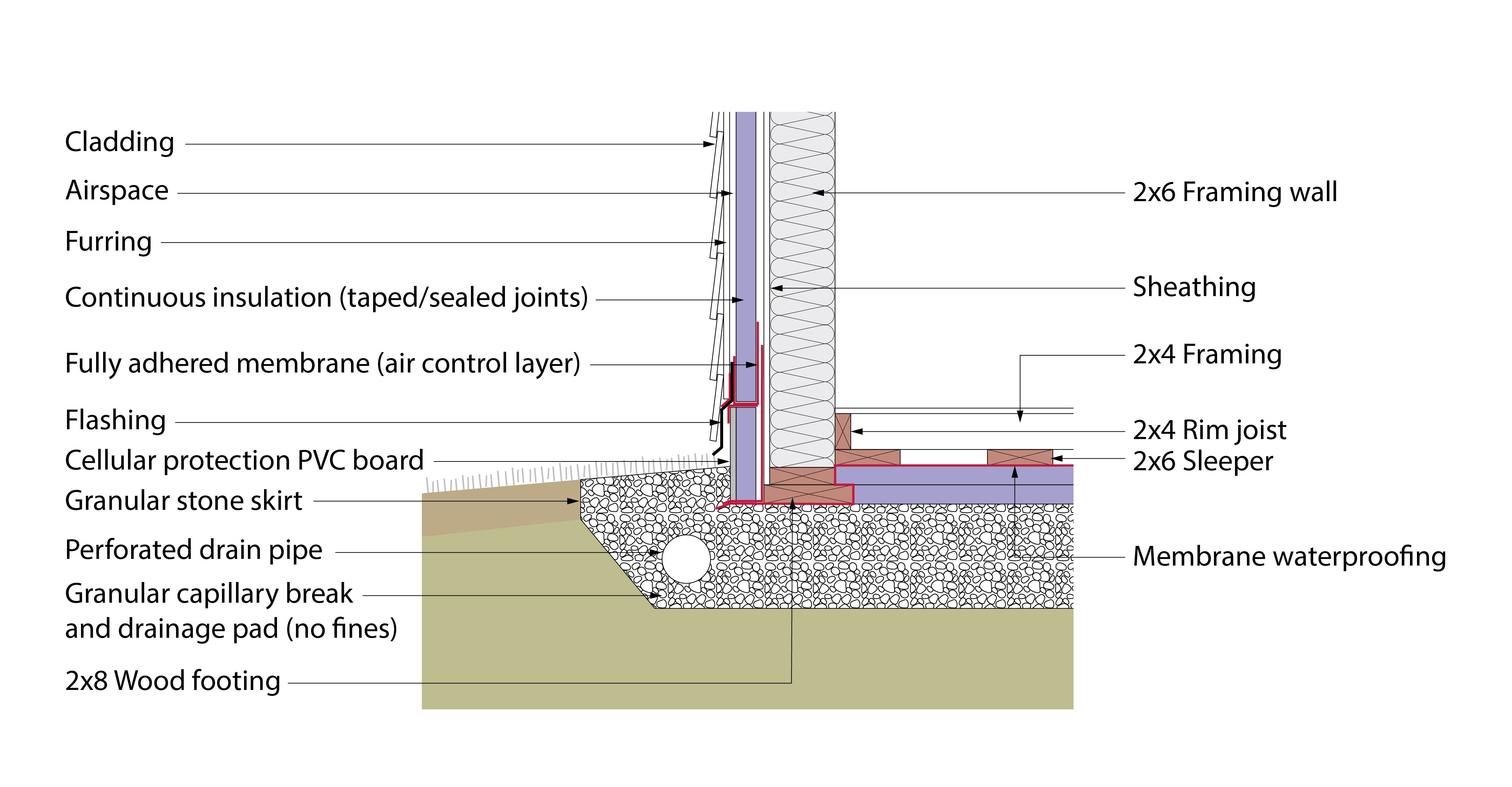

On to crawlspaces. Much easier. Especially if the interior grade of the crawlspace is higher than the exterior grade. Note that I am a conditioned crawlspace kind of guy. If you go that approach all it is…is a “mini-basement. All the details are pretty much the same as with the wood basement foundation details. But if you want to do away with the concrete footing…I think you can (Figure 2a & b). Just remember “point loads”. Wherever we had a point load I would put a concrete pad under it and run the load to the concrete pad with a steel column. Yup, conservative.
Figure 2a: Wood Crawlspace Foundation - All the details are pretty much the same as with the wood basement foundation details. But if you want to do away with the concrete footing…I think you can. Just remember “point loads”.
Figure 2b: Wood Crawlspace Foundation - All the details are pretty much the same as with the wood basement foundation details.

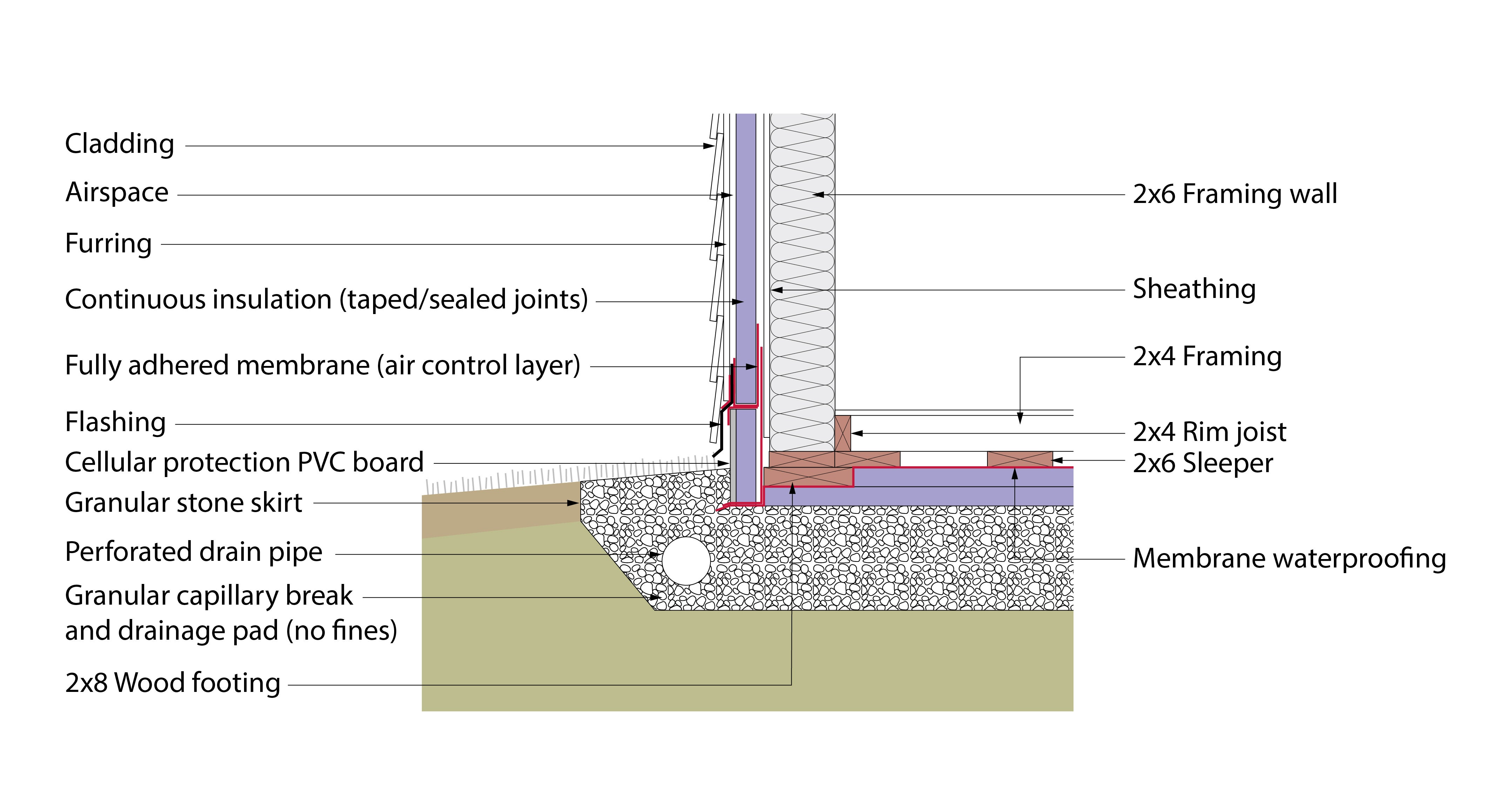

Now for wood-slab-on-grade foundations. Least risky….in my opinion….but almost never see them…. Start with a gravel pad, lay out your membrane water control layer, air control layer and vapor control layer, lay out your perimeter wood footing and lay down your continuous rigid insulation (Photograph 9). Then you do the framing and subfloor sheathing (Photograph 10). Now there are two ways of doing them….wood footing wise. The first is to install the wood footing directly on the gravel pad (over the top of the membrane…) (Figure 3). The second is to install the wood footing over XPS rigid insulation (Figure 4).[4]
Photograph 9: Wood-Slab-On-Grade Foundation - Start with a gravel pad, lay out your membrane water control layer, air control layer and vapor control layer, lay out your perimeter wood footing and lay down you continuous rigid insulation. Note the concrete “pad” that provides support for a “point” load.
Photograph 10: Wood-Slab-On-Grade Foundation - The framing and subfloor sheathing over the continuous rigid insulation.
Figure 3: Wood-Slab-On-Grade Foundation - Installing the wood footing directly on the gravel pad (over the top of the membrane).
Figure 4: Wood-Slab-On-Grade Foundation - Installing the wood footing over XPS rigid insulation.
