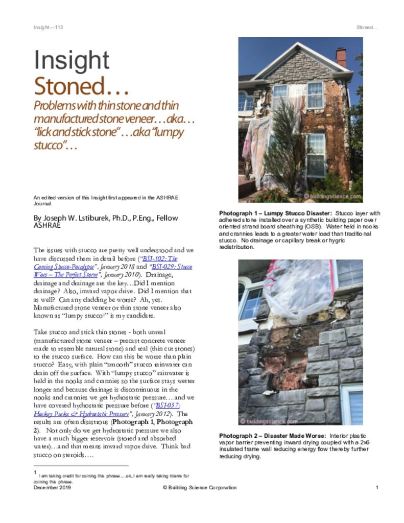

The issues with stucco are pretty well understood and we have discussed them in detail before (“BSI-102: The Coming Stucco-Pocalypse”, January 2018 and “BSI-029: Stucco Woes – The Perfect Storm”, January 2010).  Drainage, drainage and drainage are the key…Did I mention drainage?  Also, inward vapor drive.  Did I mention that as well?  Can any cladding be worse?  Ah, yes. Manufactured stone veneer or thin stone veneer also known as “lumpy stucco[1]” is my candidate.
Take stucco and stick thin stones - both unreal (manufactured stone veneer – precast concrete veneer made to resemble natural stone) and real (thin cut stones) to the stucco surface. How can this be worse than plain stucco? Easy, with plain “smooth” stucco rainwater can drain off the surface.  With “lumpy stucco” rainwater is held in the nooks and crannies so the surface stays wetter longer and because drainage is discontinuous in the nooks and crannies we get hydrostatic pressure….and we have covered hydrostatic pressure before (“BSI-057: Hockey Pucks & Hydrostatic Pressure”, January 2012).  The results are often disastrous (Photograph 1, Photograph 2).   Not only do we get hydrostatic pressure we also have a much bigger reservoir (stored and absorbed water)…and that means inward vapor drive.  Think bad stucco on steroids….
Photograph 1 – Lumpy Stucco Disaster:  Stucco layer with adhered stone installed over a synthetic building paper over oriented strand board sheathing (OSB).  Water held in nooks and crannies leads to a greater water load than traditional stucco.  No drainage or capillary break or hygric redistribution.
Photograph 2 – Disaster Made Worse:  Interior plastic vapor barrier preventing inward drying coupled with a 2x6 insulated frame wall reducing energy flow thereby further reducing drying.
However, the problems are easy to avoid. Same approach as with stucco….provide a drainage layer behind the “lumpy stucco” (Figure 1).  Drainage, drainage and drainage…and if the drainage gap is 3/16 inch or greater we get to address inward vapor drive and provide some hygric redistribution…aka “drying”.

We are not dealing with the rot and damage shown in Photograph 1and Photograph 2.  We are just dealing with the thin stones falling off (Photograph 3and Photograph 4).   Yup, workmanship.  Over and over I get the same argument.  Workmanship. Apparently, over 3 decades and more, and in regions all over North America, but only where it rains, we can’t seem to get folks to install the stuff correctly.  I bought into that argument at first.  Sure, there are workmanship issues on some projects.  But there have been countless failures where the workmanship was exceptional and supervised continuously by third parties[3].  The failures are now so pronounced we have social media stirring up the pot[4].
