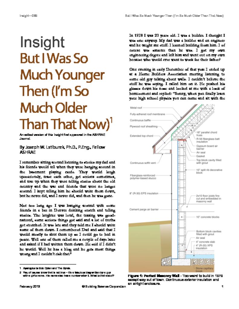

The building section I sketched up for the first one was pretty straightforward based on today’s thinking (Figure 1). But then? I couldn’t even get a building permit. It was too weird for the first building official I went to. I wasn’t a licensed engineer yet, so I couldn’t go that way. I had to build it in a place where there wasn’t a building department. Up near Bancroft, Ontario. God’s country. It wasn’t the end of the world. But you could see the end of the world from there. A three-hour plus drive there. Coming back was even worse. There and back every day? Fun. You want to ruin your marriage do that for a while.
Figure 1: Perfect Masonry Wall - Too weird to build in 1979 except way out of town. Continuous exterior insulation and an airtight enclosure.

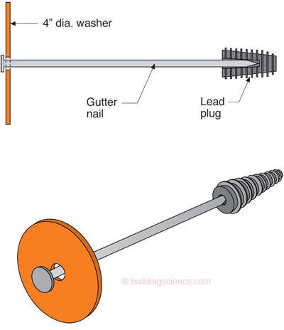

He just sat down and looked at me and didn’t say a thing. Dad was like that. Most guys of his generation were like that. He was a fighter pilot during the war. The ones that lived would go quiet a lot. The ones I knew anyway. I met a bunch of them through Dad. Not once did he ask why I wanted to do it. He just worked the problem. After about an hour he got up without saying a thing and I followed him to the car and we drove to Canadian Tire. He got a long masonry drill bit, some gutter nails, a bunch of really big washers and some lead plugs. He sketched out the solution on a pad of paper. I wish I had kept the sketch. Worked like a charm (Figure 2).
Figure 2: Dad’s Fastener - Gutter nails, a bunch of really big washers and some lead plugs. Put the nail through the washer. Push the lead plug onto the end of the nail. Lean the rigid foam against a masonry wall. Drill through the foam with a 5/8-inch diameter long masonry bit 1-inch into the masonry wall. Pull the bit out of the opening. Insert the fastener through the foam “pilot” hole so the lead plug engages the hole in the masonry. Use a mallet to hammer the fastener home.
How many would I need? How far apart? Dad gave me “the look”. The look I had been getting since I was in short pants. Build a wall and you will know. He was a flight test engineer at DeHaviland. He was an old school engineer. I was his son. I knew what to do. Mock ups, test walls, experiments. The Wright brothers were his role model. His sketch book and his slide rule were part of him. He was my role model. I built a test wall and tested it until it broke. Six fasteners for every 4 ft x 8 ft sheet of insulation. Two at the top, two in the middle and two at the bottom. Eight inch thick foam. No way that would work. Except when you built it, it did. You could hang a pickup truck off that wall.6

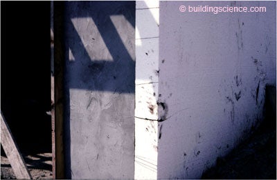

He took me down to the Gardiner Expressway7 where they were using it to fix and patch the concrete supports and concrete deck. He made sure I understood that the fiberglass cloth needed to be treated to handle the alkalinity of the mix or that the mix had to be buffered. I asked him how he knew. He handed me another book. “Properties of Concrete” by Adam Neville. He started to say something. I waved him off. “I know, I know, give it back when I am done,” I said.
So I mixed up a batch and did a test wall. Awesome. There was no Sto or Dryvit around yet. I hadn’t met John Edgar yet. I was in the EIFS8 business before there was one. I was getting my chemicals from the guys fixing the expressway and using the mix design from the guys in the concrete canoe club. So how did I avoid all those EIFS problems that came a decade later? Easy. I wrapped my EIFS lamina into the window opening and then installed the window (Figure 3). I also had a water control layer behind the foam. And I had a masonry wall. And I had the CBD’s. Especially CBD-40 “Rain Penetration and its Control.” Kirby Garden’s classic, first published April, 1963.

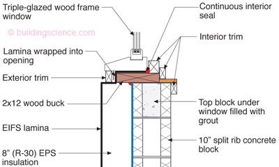

Figure 3: Avoiding EIFS Problems - I avoided all those EIFS problems that came a decade later by wrapping the EIFS lamina into the window opening and then installing the window. The lamina acts as an under window “gutter.” A stucco “pan flashing.”

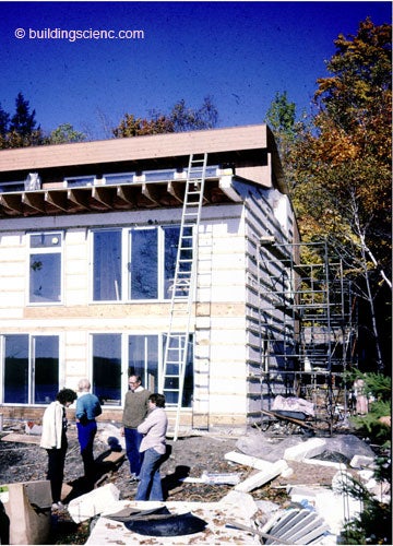

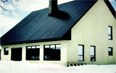

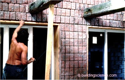

Finished the first one fall 1979 (Photograph 1). Continuous exterior insulation (Photograph 2). Beautiful split ribbed concrete block interior with timber beams (Photograph 3). Triple glazed windows. Airtight. Heated by a wood stove in the basement. No ducts, just transfer grilles in the floor. Old school. We used to do that before there was forced air. Combustion air ducted to the wood stove. Also had a fireplace. Combustion air ducted to the fireplace too. Got one of Greg Allen’s9 first air-to-air heat exchangers. Build tight, ventilate right. Doing it before Jim White coined the phrase.
Photograph 1: God’s Country 1979 – Super insulated continuous exterior insulation, triple glazed windows, airtight and ventilated right.
Photograph 2: Air Control Layer – Cement rendering is the air control layer. Mechanically attached 8 inch thick expanded polystyrene (EPS).
Photograph 3: Interior Finish – Split rib decorative block with exposed structural timbers.

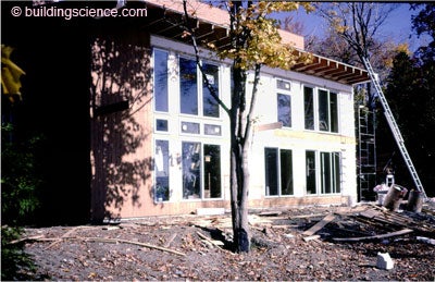

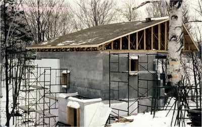

Built another one in Collingwood, Ontario the next year. Used “energy trusses” before there were energy trusses (Photograph 4). My old truss engineer said it was dumb to squeeze the insulation at the roof perimeter. He sketched up his idea on a napkin. Another napkin I should have kept. The rigid foam on this one went up “slick as snot on a glass door knob”10 (Photograph 5).
Photograph 4: Energy Trusses – “High heel” trusses and a R-60 vented attic with an airtight lid.

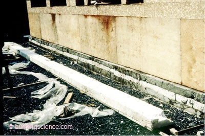

Photograph 5: Exterior Rigid Insulation – Large plastic washers and mechanically attached 8 inch thick expanded polystyrene (EPS).

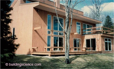

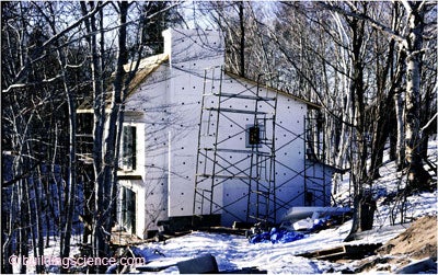

I had a system and it was working. I built a couple more in 1980. Problem was it was expensive. And it was slow. Needed to make this work with wood. I got a chance to give it a shot in the Eastern Townships outside of Montreal in 1981 (Photograph 6). The site was beautiful and on the edge of a lake. The site was also ugly because of the bearing conditions of the soil. I needed to spread the load. I needed a very stiff plate foundation and I needed the plate to be lightweight. And I needed a thermal break. And I needed a shallow foundation. I was a Toronto boy. The U of T had another unheralded genius, Eli Robinsky. He was a professor in the same department as JT. Professor Robinsky developed the shallow frost protected foundation that the Swedes get credit for. I actually took his class. I remembered.
Photograph 6: Go East Young Man – Wood frame perfect wall in the Eastern Townships outside of Montreal in 1981.

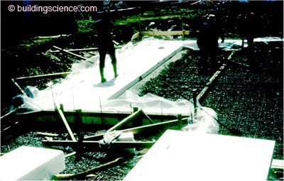

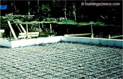

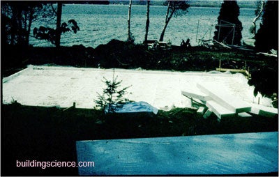

Check out Photographs 7, 8, 9 and 10. Got a crazy lunatic US engineer, Tony Karwoski, to do the structural calculations as no one I knew in Canada would touch it. “TK” wherever you are, you are my hero. Two thin reinforced concrete slabs sandwich a foam core that saves weight and acts as a thermal break. A slab on grade foundation with a high moment of inertia without a weight penalty. Stiffer than a week old corpse.
Photograph 7: Slab 1 – Grade prepared for first layer of concrete. Notice the foam form.
Photograph 8: Slab 2 – Foam core is embedded into the first layer of concrete as the first layer of concrete is placed.
Photograph 9: Slab 3 – “Foam bathtub” ready for top layer of concrete.
Photograph 10: Slab 4 – Sandwich construction of slab. Note the foam layer between two layers of concrete. A small section of the perimeter foam form was removed for this “photo op”.
I put a conditioned crawlspace on top of the slab and used a wood frame version of Professor Hutcheon’s masonry wall. Check out Figure 4. Professor Hutcheon meet Professor Robinsky. Introduction courtesy of “TK”.
Figure 4: Perfect Frame Wall - Two thin reinforced concrete slabs sandwich a foam core that saves weight and acts as a thermal break. A conditioned crawlspace was constructed on top of the slab. A wood frame version of Professor Hutcheon’s masonry wall was used for the exterior assemblies. Professor Robinsky’s frost protected shallow foundation makes it all work. The walls were wood frame sheathed with oriented stand board (OSB). A polyethylene water control layer, air control layer and vapor control layer was installed over the exterior of the OSB. R-30 EPS (8 inches worth) was installed over that held in place with wood furring and long screws. The wood siding was installed over the furring providing back venting and drainage. I had Kirby Garden’s “rain screen”. The frame wall was insulated with unfaced fiberglass batts. An R-40 single stud wall.

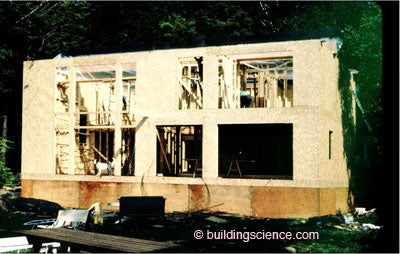

The walls were wood frame sheathed with a new product called oriented stand board (OSB) (Photograph 11). A polyethylene water control layer, air control layer and vapor control layer was installed over the exterior of the OSB. R-30 EPS (8 inches worth) was installed over that held in place with wood furring and long screws (Photograph 12). The wood siding was installed over the furring providing back venting and drainage. I had Kirby Garden’s “rain screen” (Photograph 13). The frame wall was insulated with unfaced fiberglass batts. And presto I had an R-40 single stud wall. All this was before R-2000.
Photograph 11: Frame Structure - The walls were wood frame sheathed with a new product called oriented stand board (OSB).
Photograph 12: Perfect Assembly - A polyethylene water control layer, air control layer and vapor control layer was installed over the exterior of the OSB. R-30 EPS (8 inches) was installed over that held in place with wood furring and long screws.

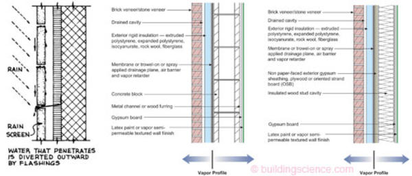

Thirty years later not a lot has changed in my designs from that wall I built in 1981. I call it the “perfect wall” now. Professor Hutcheon’s brainchild really was “perfect”. The wood frame is a 2x6 now and the poly has been replaced with a fully adhered membrane. I am down to 4 inches of rigid insulation, in two layers, with the joints offset. Polyisocyanurate at that thickness gives me R-26. With the nominal R-20 cavity insulation in the 2x6 frame I have got a “R-40 ish” wall. Figure 5 shows the evolution.
Figure 5: Perfect Evolution – Professor Hutcheon’s perfect wall circa 1964 is on the left. The masonry version constructed today is in the middle and the wood frame version constructed today is on the right.
