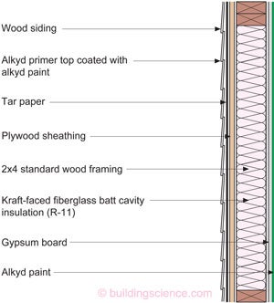

Figure 1: Yesterday’s “Old Classic” Wall - Plywood sheathing covered with tar paper over a wood frame lined with gypsum board on the inside and insulated with kraft-faced fiberglass batts. The kraft facing was really a vapor diffusion valve that opened and closed based on relative humidity. The plywood sheathing and tar paper worked the same way (see the “BSI-038: Mind the Gap” sidebar “The Magic of Plywood and the Modern Wall” and “BSI-029: Stucco Woes—The Perfect Storm Over Stucco”). So we had valves or “throttles” on both sides of the wall. Walls dried to the outside in the winter and to both sides in the summer.

Yesterday’s “old classic” wall was the workhorse wall for much of the last century. It was unbelievably robust. We know that it worked because we used it everywhere without any problems. When have you every heard of a technology to carry an industry through almost an entire century? Plywood sheathing covered with tar paper over a wood frame lined with gypsum board on the inside and insulated with kraft-faced fiberglass batts. We did not appreciate why it worked, but it worked. OK the old guys knew, but nobody was listening to them or reading their stuff.
The kraft facing was really a vapor diffusion valve that opened and closed based on relative humidity. The plywood sheathing and tar paper worked the same way (see the “BSI-038: Mind the Gap, Eh?” sidebar “The Magic of Plywood and the Modern Wall” and “BSI-029: Stucco Woes-The Perfect”). So we had valves or “throttles” on both sides of the wall. Walls dried to the outside in the winter and to both sides in the summer.
We still had a few annoying things we had to deal with the in the “old classic” wall. Mostly peeling paint on the wood siding. Thanks to the Forest Products Lab (FPL) in Madison, WI that was slam-dunked early—just no one listened or paid attention.3 Yes, same old story. Banged that drum two paragraphs earlier. Maybe there is a message there?
The FPL told us to install the wood siding over an air space, back prime the siding with oil-based primer to stop the leaching of water-soluble extractives and then top coat with something that “breathes” vapor such as a latex paint. When we did this and used latex paints over the top of oil based primers the paint could go 20 years. From 5 years to 20 years. I’d call that impressive. Vapor open interior latex paints solved the interior paint peeling problem as well. Interestingly the latex paint coatings on the inside and outside caught on, but the air gap did not.

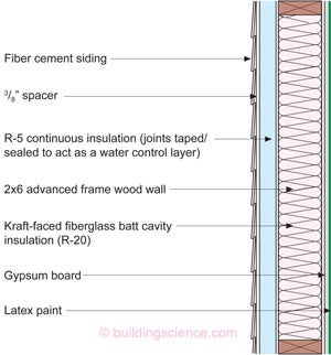

Once you get to IECC Climate Zones 6, 7 & 8 things change. You need to install at least R-5 continuous exterior insulation over the 2x6 framing to meet the thermal requirements of the 2012 IECC. And you may or may not need to install an interior Class II or Class I vapor retarder depending on stuff we still need to talk about.
The easy answer to meet the thermal requirements of the 2012 IECC and the vapor retarder requirements of the 2012 IRC is to install any R-5 insulating sheathing on the outside of the wall framing and install a kraft-faced fiberglass batt inside the frame cavity. We are done. The Class II vapor retarder characteristics of the kraft facing on the fiberglass batts (under “dry cup” conditions) throttles down the inward to outward vapor flow sufficiently to keep the wall assembly out of trouble from a vapor perspective during the winter and yet still allows inward drying during the summer.
Note that I said this works from a “vapor perspective”. Let’s talk rain now. If I use a foam-based sheathing to provide the R-5 continuous insulation and tape the joints I can use the foam sheathing as a water control layer. Don’t forget the gap between the cladding and the exterior face of the taped R-5 insulating sheathing to control hydrostatic pressure (Figure 3). And we are done.
Figure 3: Foam Sheathing Wall Assembly - Foam sheathing can be used to provide the R-5 continuous insulation called for by the 2012 IECC in Climate Zones 6, 7 and 8. If the joints in the foam sheathing are taped the foam sheathing can act as a water control layer. Don’t forget the gap between the cladding and the exterior face of the taped R-5 insulating sheathing to control hydrostatic pressure.

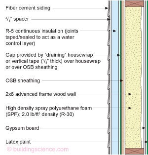

Or are we? We are only done if we have not installed the taped continuous insulation over OSB sheathing. What if I want to use OSB sheathing for structural reasons? Or what if I want to use OSB sheathing to support a housewrap for water control reasons? Or what if I want to use taped or sealed OSB sheathing as a water control layer and air control layer?
The issue is the ability of the OSB sheathing to either dry outwards or inwards. When an impermeable or low permeable insulating sheathing is used outward drying is restricted. If inward drying is also not restricted then this is not an issue. But if inward drying is restricted by installing an interior vapor barrier such as high density spray polyurethane foam (SPF) or sheet polyethylene then this becomes an issue. We have learned from our Vancouver work (see “BSI-058: Parthenon, Eh?”) that we can get effective moisture redistribution and buffering and some outward drying by providing a small gap between the OSB sheathing and the impermeable or low permeable insulating sheathing. This gap can be provided by installing a “draining” housewrap or by installing vertical strips of sheathing tape over the exterior face of the OSB sheathing on 24-inch centers (i.e. over studs) (Figure 4). The tape thickness should be limited to around 1/8-inch thick (3 mm) so that the thermal performance of the foam sheathing is negligibly affected.
Figure 4: Vapor Impermeable Foam Sheathing Installed Over OSB with High Density Spray Polyurethane Foam - The issue is the ability of the OSB sheathing to either dry outwards or inwards. When an impermeable or low permeable insulating sheathing is used outward drying is restricted. If inward drying is also not restricted then this is not an issue. But if inward drying is restricted by installing an interior vapor barrier such as high density spray polyurethane foam (SPF) then this becomes an issue.
When using a “draining” housewrap for this purpose the housewrap does not need to act as the water control layer—it can be used for its “spacer” characteristics. For example, it is typical to use OSB at corners to provide shear resistance and use insulating sheathing in the field of the wall. A thinner layer of insulating sheathing is installed over the OSB. Housewrap can be used as a spacer and only installed over the OSB and not the rest of the wall.
Many builders choose to sheath their entire building with OSB and then cover all the OSB with rigid insulation. Using a draining housewrap over the entire building under the rigid insulation provides both a “gap” and a water control layer. Note that in all these cases a gap is required between the cladding and the insulating sheathing.

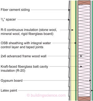

But why even use a impermeable or low permeable insulating sheathing? Why not use a vapor open insulating sheathing? Yup. Good idea. We can use stone wool or rock wool or rigid fiberglass board insulation as the continuous layer. You still need a gap between the cladding and the exterior face of this vapor open insulating sheathing. And you need a water control layer between the OSB sheathing and vapor open insulating sheathing (Figure 5) or you need to use an OSB where the water control layer is integral with the OSB sheathing where taping the joints provides water control layer continuity (Photograph 1).
Figure 5: Vapor Permeable Insulating Sheathing Installed Over OSB - Stone wool or rock wool or rigid fiberglass board insulation can be used to provide the R-5 continuous insulation called for by the 2012 IECC in Climate Zones 6, 7 and 8. You still need a gap between the cladding and the exterior face of this vapor open insulating sheathing. And you need a water control layer between the OSB sheathing and vapor open insulating sheathing or you need to use an OSB where the water control layer is integral with the OSB sheathing where taping the joints provides water control layer continuity.

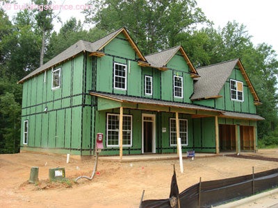

Photograph 1: OSB Water Control Layer – OSB where the water control layer is integral with the OSB sheathing where taping the joints provides water control layer continuity.

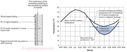

But what if I don’t want to use a “smart vapor barrier” or a vapor retarder paint? What are my options? Easy. Increase the thermal resistance of the insulating sheathing. The 2012 IRC has a table that provides the necessary thermal resistances (Table 1). The values in the table are based on the curves from “BSI-049: Confusion About Diffusion”, (Figure 6).
Figure 6: Insulating Sheathing Rocks - The insulating sheathing raises the temperature of the condensing surface of interest. This is a good thing. You need to follow the requirements in Table 1 in order to avoid having to install a Class I or Class II vapor retarder on the inside of the assembly.
There are few things that need to be said about these curves. We use average monthly temperatures to get the curves. Monthly averages work for moisture analysis. How do we know that? Old guys told us. Guess what? About 15 years ago bunch of young guys didn’t believe the old guys. I was sort of a young guy then. I was the oldest young guy running around with a bunch of really smart younger guys who thought they knew stuff. We built a whole bunch of test huts with all kinds or walls in all the climate zones. We wetted the walls. We watched some of them dry and some of them not. We made them air leaky and we made them reasonably tight. We varied interior moisture levels. We did this for a couple of years and guess what? The old guys were right. Again.
So how do we know what the temperature of the cavity side of the insulating sheathing (“condensing surface of interest”) should be in each of the climate zones? Ah. Easy once you know the answer. The test huts and the years of looking at real walls gave us the information we needed.
Turns out that you can get really close to the right answer if you average the average temperature of the 3 coldest months in the location of interest. If the location of interest is in Climate Zone 5 you make sure that the interface temperature stays above 35 degrees F when the interior temperature is 70 degrees F and where the outside temperature is the average temperature of the 3 coldest months. You have to realize the calculation is just a way to get you to the right amount of thermal resistance based on the real physics that came from real measurements in real experiments in the real world. But the curves and the presentation give most folks an insight as to how things work. Note that this simple calculation “tool” factors in vapor diffusion and air leakage and “incidental” wetting events. It is not a “dew point” calculation so therefore it is useful.

Note in Table 1 the R-value of the insulating sheathing increases with cavity thickness all other things being equal. Let’s say that I want my sheathing/cavity interface to stay above 35 degrees F when the outside temperature is 0 degrees F and the inside temperature is 70 degrees F. If my wall cavity has a thermal resistance of R-10 (sort of like you get with a 2x4 wall) and my insulating sheathing has a resistance of R-10 the total thermal resistance of the wall is R-20. In this case 50 percent of the thermal resistance is to the outside of the sheathing/cavity interface and 50 percent of the thermal resistance is to the inside of the sheathing/cavity interface. The temperature difference across the wall is 70 F degrees. The temperature at the interface is 35 degrees F since half the temperature difference is across the cavity insulation and half the temperature difference is across the insulating sheathing. Let’s say I now frame with 2x6’s my wall cavity now as a thermal resistance of R-20. To keep my sheathing/cavity interface at 35 degrees F or higher my insulating sheathing now has to have a thermal resistance of R-20 to keep the same 50:50 ratio. That is why the IRC has higher insulating sheathing R-value requirements for 2x6 walls compared to 2x4 walls in each of the climate zones.
Further note that this is not in conflict with the provisions of the 2012 IECC. The IECC sets the minimum level for continuous insulation for thermal performance reasons. The 2012 IRC sets the minimum levels for continuous insulation to control condensation when not using a Class I or Class II vapor retarder. These are two very different requirements.
So what am I saying here? The code has it right—the 2012 IRC—which is based on lots of real world experiments and observations and even more important—real world experience. When someone looks at the code tables and runs a simulation model and says the model shows that the table is wrong I just roll my eyes and mutter about youngsters and then smile because I was that guy once.
