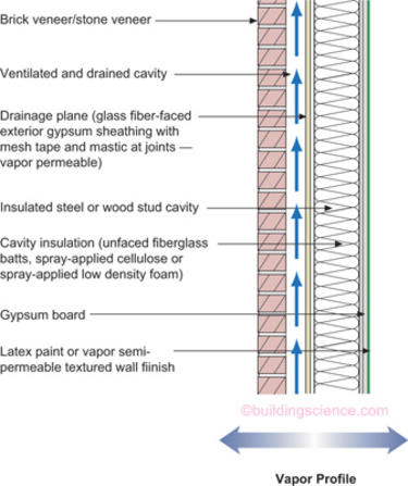

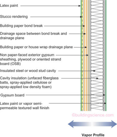

All exterior claddings pass some rainwater. Siding leaks, brick leaks, stucco leaks, stone leaks, etc. As such some control of this penetrating rainwater is required.  In most walls this penetrating rainwater is controlled by a drainage plane that directs the penetrating rainwater downwards and outwards.
Drainage planes are water repellent materials (building paper, house wrap, foam insulation, etc), which are located behind the cladding and are designed and constructed to drain water that passes through the cladding. They are interconnected with flashings, window and door openings, and other penetrations of the building enclosure to provide drainage of water to the exterior of the building. The materials that form the drainage plane overlap each other shingle fashion or are sealed so that water flow is down and out of the wall.
Reservoir claddings on the exterior of buildings can be a problem. Reservoir claddings are materials that can store rainwater—sponges that get wet when it rains. Once the reservoirs get wet, the stored water can migrate elsewhere and cause problems. Common reservoirs are brick veneers, stuccos, wood siding, wood trim and fiber cement cladding.
Reservoir claddings should be uncoupled from the building. Back priming (painting all surfaces, back, front, edges and ends of wood siding, cement siding and all wood trim) are techniques that can limit the moisture storage issue with these materials.
Back venting brick veneers and installing them over foam sheathings also disconnects or uncouples the brick veneer moisture reservoir from the building. Installing stucco over two layers of building paper or over an appropriate capillary break such foam sheathing similarly addresses stucco reservoirs.

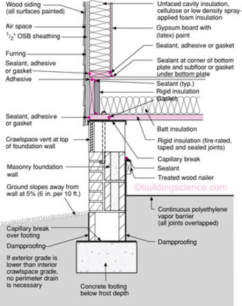

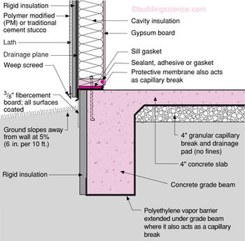

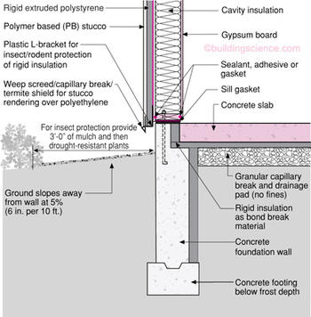

Groundwater
The fundamental principles of ground water control are to keep rainwater away from the foundation wall perimeter and to drain groundwater with sub-grade perimeter drains before it gets to the foundation wall.  This applies to slabs, crawlspaces and basements regardless of whether they are newly constructed or undergoing rehabilitation.
Concrete and masonry are sponges – they can wick water due to capillarity. This is the main reason that damp proofing (the black tar-like coating) is applied to exterior basement walls. The damp proofing fills in the pores in the concrete and masonry to reduce ground water absorption. The damp proofing is a capillary break. Under concrete floor slabs, the stone layer combined with polyethylene serves a similar function (they act as capillary breaks). Unfortunately, the capillary rise through footings is typically ignored. This can be a major problem if foundation perimeter wall are finished or insulated.
In new construction a capillary break should be installed on the top of the footing between the footing and the perimeter foundation wall. This can be done by damp-proofing the top of the footing or by installing a membrane at this location.
In new construction the interior insulation and finishing approach must take into account the moisture migrating up through the footing. This is best accomplished by installing vapor semi-permeable rigid foam insulation on the interior of the assembly to protect the interior finishes and to release the capillary water to the interior in a controlled manner – at a rate that does not damage interior finishes or lead to mold.
The best foams to use have a perm rating of greater than 1 perm for the thickness used. This means limiting extruded polystyrene insulation to less than 1-inch thickness for walls (more than 1 inch thick and they do not breathe sufficiently) and making sure that the rigid insulation is not faced with polypropylene skins or foil facings. Additionally, since foams need to be protected from fire, and this is often done with gypsum board only latex paint should be used on interior gypsum finishes (since it breathes).
Capillary control also applies to slab-on-grade construction and crawlspaces. Monolithic slabs need plastic ground covers that extend under the perimeter grade beam and upwards to grade. Additionally, the exposed portion of slabs should be painted with latex paint to reduce water absorption and a capillary break should be installed under perimeter wall framing.

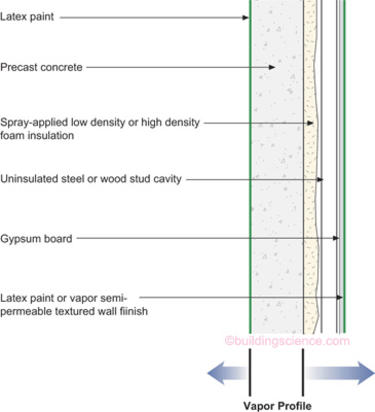

Vapor Diffusion
The fundamental principle of control of water in the vapor form is to keep it out and to let it out if it gets in.  It gets complicated because sometimes the best strategies to keep water vapor out also trap water vapor in. This can be a real problem if the assemblies start out wet because of rain or the use of wet materials.
It gets even more complicated because of climate. In general water vapor moves from the warm side of building assemblies to the cold side of building assemblies. Logically, this means we need different strategies for different climates.  We also have to take into account differences between summer and winter.
A vapor retarder is defined as follows:
Vapor Retarder*:  The element that is designed and installed in an assembly to retard the movement of water by vapor diffusion.
The unit of measurement typically used in characterizing the water vapor permeance of materials is the “perm.” Several classes of vapor retarders are further defined as follows [4]:
  • Class I     Vapor Retarder:  0.1 perm or less
  • Class II     Vapor Retarder:   1.0 perm or less and greater than 0.1 perm
  • Class III    Vapor Retarder:  10 perm or less and greater than 1.0 perm
  • Test Procedure for vapor retarders:  ASTM E-96 Test Method A (the desiccant method or dry cup method)
Finally, a vapor barrier is defined as:
  • Vapor Barrier:  A Class I vapor retarder.

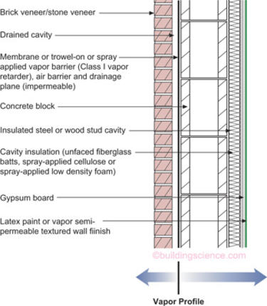

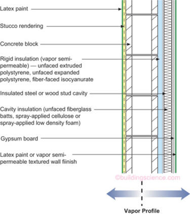

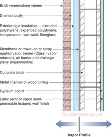

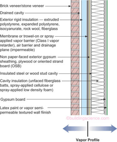

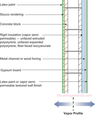

Materials can be separated into four general classes based on their permeance [4]:
  • Vapor impermeable:  0.1 perm or less
  • Vapor semi-impermeable:  1.0 perm or less and greater than 0.1 perm
  • Vapor semi-permeable:  10 perms or less and greater than 1.0 perm
  • Vapor permeable:  greater than 10 perms
Based on the definitions the following general principles should be followed in assembly design:
  • Avoidance of using vapor barriers where vapor retarders will provide satisfactory performance. Avoidance of using vapor retarders where vapor permeable materials will provide satisfactory performance. Thereby encouraging drying mechanisms over wetting prevention mechanisms.
  • Avoidance of the installation of vapor barriers on both sides of assemblies—i.e. “double vapor barriers” in order to facilitate assembly drying in at least one direction.
  • Avoidance of the installation of vapor barriers such as polyethylene vapor barriers, foil-faced batt insulation and reflective radiant barrier foil insulation on the interior of air-conditioned assemblies—a practice that has been linked with moldy buildings.
  • Avoidance of the installation of vinyl wall coverings on the inside of air-conditioned assemblies.

Figure 1: Concrete Block With Exterior Insulation and Brick or Stone Veneer
Wall 1
Applicability – all hygro-thermal regions
This is arguably the most durable wall assembly available to architects and engineers.  It is constructed from non-water sensitive materials and due to the block construction has a large moisture storage (or hygric buffer) capacity.  It can be constructed virtually anywhere.  In cold climates condensation is limited on the interior side of the vapor barrier as a result of installing all of the thermal insulation on the exterior side of the vapor barrier (which is also the drainage plane and air barrier in this assembly).  In hot climates any moisture that condenses on the exterior side of the vapor barrier will be drained to the exterior since the vapor barrier is also a drainage plane.  This wall assembly will dry from the vapor barrier inwards and will dry from the vapor barrier outwards.

Figure 3: Concrete Block With Interior Rigid Insulation and Stucco
Wall 3
Applicability – all hygro-thermal regions*
This assembly has all of the thermal insulation installed on the interior of the concrete block construction but differs from Figure 2 since it does not have a vapor barrier on the exterior. The assembly also does not have a vapor barrier on the interior of the assembly.  It has a large moisture storage (hygric buffer) capacity due to the block construction. The rigid insulation installed on the interior should be non-moisture sensitive and allow the wall to dry inwards—hence the recommended use of vapor semi permeable foam sheathing.  Note that the foam sheathing is not faced with aluminum foil or polypropylene skins.  It is important that this assembly can dry inwards except in very cold and subarctic/arctic regions—therefore vapor semi impermeable interior finishes such as vinyl wall coverings should be avoided in assemblies – except in very cold and subarctic/arctic regions. Vapor impermeable foam sheathings should be used in place of the vapor semi permeable foam sheathings in very cold and subarctic/arctic regions. The drainage plane in this assembly is the latex painted stucco rendering. A Class III vapor retarder is located on both the interior and exterior of the assembly (the latex paint on the stucco and on the interior gypsum board.
* In very cold and subarctic/arctic regions vapor impermeable foam sheathings are recommended
Figure 4: Concrete Block With Interior Rigid Insulation/Frame Wall With Cavity Insulation and Stucco
Wall 4
This assembly is a variation of Figure 3.  It also has all of the thermal insulation installed on the interior of the concrete block construction but differs from Figure 3 due to the addition of a frame wall to the interior of the rigid insulation.  This assembly also does not have a vapor barrier on the exterior. The assembly also does not have a vapor barrier on the interior of the assembly. It has a large moisture storage (hygric buffer) capacity due to the block construction. The rigid insulation installed on the interior should be non-moisture sensitive and allow the wall to dry inwards—hence the recommended use of vapor semi permeable foam sheathing.  Note that the foam sheathing is not faced with aluminum foil or polypropylene skins. It is important that this assembly can dry inwards even in very cold and sub arctic/arctic regions—therefore vapor semi impermeable interior finishes such as vinyl wall coverings should be avoided in assemblies. Vapor impermeable foam sheathings should be used in place of the vapor semi permeable foam sheathings in very cold and sub arctic/arctic regions. The drainage plane in this assembly is the latex painted stucco rendering.  A Class III vapor retarder is located on both the interior and exterior of the assembly (the latex paint on the stucco and on the interior gypsum board.
* In very cold and sub arctic/arctic regions vapor impermeable foam sheathings are recommended – additionally the thickness of the foam sheathing should be determined by hygro-thermal analysis so that the interior surface of the foam sheathing remains above the dew point temperature of the interior air.

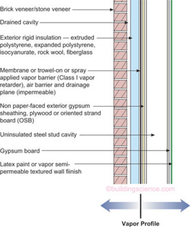

Figure 5: Frame Wall With Exterior Insulation and Brick or Stone Veneer
Wall 5
This wall is a variation of Figure 1—but without the moisture storage (or hygric buffer) capacity. This wall is also a durable wall assembly.  It is constructed from non-water sensitive materials and has a high drying potential inwards due to the frame wall cavity not being insulated. It can also be constructed virtually anywhere.  In cold climates condensation is limited on the interior side of the vapor barrier as a result of installing all of the thermal insulation on the exterior side of the vapor barrier (which is also the drainage plane and air barrier in this assembly).  In hot climates any moisture that condenses on the exterior side of the vapor barrier will be drained to the exterior since the vapor barrier is also a drainage plane. This wall assembly will dry from the vapor barrier inwards and will dry from the vapor barrier outwards.

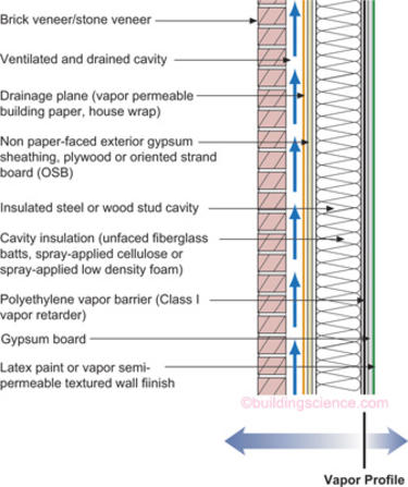

Figure 6: Frame Wall With Cavity Insulation and Brick or Stone Veneer
Wall 6
Applicability – Limited to mixed-humid, hot-humid, mixed-dry, hot-dry and marine regions – can be used with hygro-thermal analysis in some areas in cold regions - should not be used in very cold and subarctic/arctic regions
This wall is a flow through assembly—it can dry to both the exterior and the interior. It has a Class III vapor retarder on the interior of the assembly (the latex paint on the gypsum board).  It is critical in this wall assembly that the exterior brick veneer (a “reservoir” cladding) be uncoupled from the wall assembly with a ventilated and drained cavity. The cavity behind the brick veneer should be at least 2 inches wide (source: Brick Institute of America) and free from mortar droppings.  It must also have air inlets (“weep holes”) at its base and air outlets (“weep holes”) at its top in order to provide back ventilation of the brick veneer. The drainage plane in this assembly is the building paper or building wrap. The air barrier can be any of the following: the interior gypsum board, the exterior gypsum wallboard or the exterior building wrap.

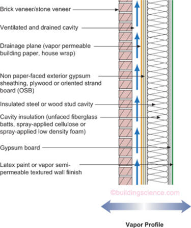

Figure 7: Frame Wall With Cavity Insulation and Brick or Stone Veneer
Wall 7
This wall is a variation of Figure 6. The exterior gypsum sheathing becomes the drainage plane. As in Figure 6 this wall is a flow through assembly—it can dry to both the exterior and the interior. It has a Class III vapor retarder on the interior of the assembly (the latex paint on the gypsum board).  It is also critical in this wall assembly that the exterior brick veneer (a “reservoir” cladding) be uncoupled from the wall assembly with a ventilated and drained cavity. The cavity behind the brick veneer should be at least 2 inches wide (source: Brick Institute of America) and free from mortar droppings. It must also have air inlets (“weep holes”) at its base and air outlets (“weep holes”) at its top in order to provide back ventilation of the brick veneer. The air barrier in this assembly can be either the interior gypsum board or the exterior gypsum sheathing.
Figure 8: Frame Wall With Exterior Rigid Insulation With Cavity Insulation and Brick or Stone Veneer
Wall 8
Applicability – all hygro-thermal regions except subarctic/arctic – in cold and very cold regions the thickness of the foam sheathing should be determined by hygro-thermal analysis so that the interior surface of the foam sheathing remains above the dew point temperature of the interior air
This wall is a variation of Figure 5. In cold climates condensation is limited on the interior side of the vapor barrier as a result of installing some of the thermal insulation on the exterior side of the vapor barrier (which is also the drainage plane and air barrier in this assembly). In hot climates any moisture that condenses on the exterior side of the vapor barrier will be drained to the exterior since the vapor barrier is also a drainage plane.  This wall assembly will dry from the vapor barrier inwards and will dry from the vapor barrier outwards. Since this wall assembly has a vapor barrier that is also a drainage plane it is not necessary to back vent the brick veneer reservoir cladding as in Figure 6 and Figure 7. Moisture driven inwards out of the brick veneer will condense on the vapor barrier/drainage plane and be drained outwards.

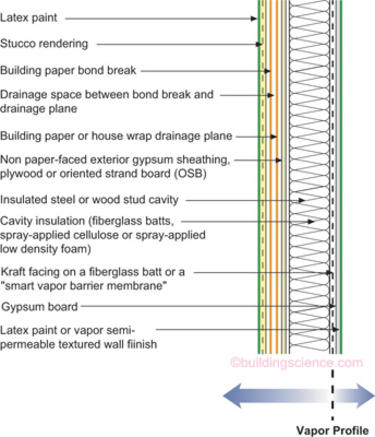

Figure 11: Frame Wall With Cavity Insulation and Stucco
Wall 11
Applicability – Limited to mixed-humid, hot-humid, mixed-dry, hot-dry and marine regions – can be used with hygro-thermal analysis in some areas in cold regions – should not be used in very cold, and subarctic/arctic regions
This wall is also a flow through assembly similar to Figure 6—but without the brick veneer—it has a stucco cladding. It can dry to both the exterior and the interior. It has a Class III vapor retarder on the interior of the assembly (the latex paint on the gypsum board). It is critical in this wall assembly that a drainage space be provided between the stucco rendering and the drainage plane. This can be accomplished by installing a bond break (a layer of tar paper) between the drainage plane and the stucco. A spacer mat can also be used to increase drainability. Alternatively, a textured or profiled drainage plane (building wrap) can be used. The drainage plane in this assembly is the building paper or building wrap. The air barrier can be any of the following: the interior gypsum board, the exterior stucco rendering, the exterior sheathing or the exterior building wrap.

Figure 14: Precast Concrete With Interior Frame Wall Cavity Insulation
Wall 14
Applicability – Limited to mixed-humid, hot-humid, mixed-dry, hot-dry and marine regions – should not be used in cold, very cold, and subarctic/arctic regions
The vapor barrier in this assembly is the precast concrete itself. Therefore this wall assembly has all of the thermal insulation installed to the interior of the vapor barrier. Of particular concern is the fact that the thermal insulation is air permeable (except where spray foam is used). Therefore this wall assembly should not be used in cold regions or colder. It has a small moisture storage (hygric buffer) capacity due to the precast concrete construction. The wall assembly does contain water sensitive cavity insulation (except where spray foam is used) and it is important that this assembly can dry inwards—therefore vapor semi impermeable interior finishes such as vinyl wall coverings should be avoided. In this wall assembly the precast concrete is also the drainage plane and air barrier.

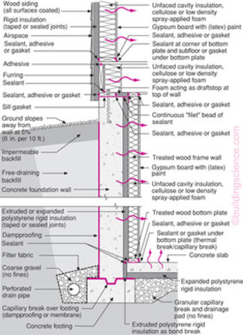

Figure 21: Concrete Basement With Interior Insulation
Foundation 21
The key to this assembly is the use of non-water sensitive rigid insulation on the interior that still permits drying to the interior. The recommended permeance of the interior rigid insulation layer is approximately 1 perm.  This typically limits the thermal resistance of the interior rigid insulation layer and an insulated frame wall assembly can be located to the interior of the interior rigid insulation. No interior vapor retarder is located within the frame wall permitting inward drying. All interior concrete surfaces are wrapped with the rigid insulation layer—particularly at the top of the wall and at foundation “step downs.” Exterior rigid insulation is located at the rim joist floor framing to control summer condensation. When insulating sheathing is not used, rigid insulation should we installed to the interior of the rim joist or an air impermeable insulation be applied at the rim joist assembly. Note the capillary break at the top of the footing.

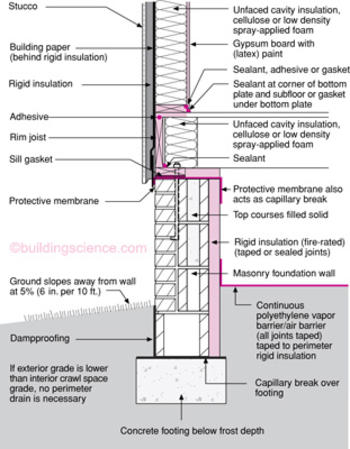

Figure 22: Vented Crawlspace
Foundation 22
The key to this assembly is the use of a Class I vapor retarder insulating sheathing at the underside of the floor framing protecting the floor frame assembly. In most regions the exterior air is above the dewpoint temperature of both the ground surface temperature in crawlspaces and the temperature of the floor assembly. The rigid insulation protects the floor assembly from the condensation. A ground cover is also recommended to limit evaporation of water from the soil.  The interior grade should be higher than the exterior grade. Floor cavity insulation should be located in contact with the rigid insulation. Rim joists should be internally insulated with rigid insulation to control condensation or an air impermeable insulation should be applied to the interior of the rim joist.  Alternatively, exterior insulating sheathing can be used.

Figure 24: Insulated Stem Wall Slab Foundation
Foundation 24
The key to this assembly is completely thermally uncoupling the concrete slab from the surrounding ground. Note the rigid insulation as a bond break and the full height interior insulation extending from the top of the footing to the underside of the slab as well as the rigid insulation extending horizontally inward. The sill gasket is typically an adhered membrane strip that also provides an air and soil gas seal between the concrete slab and the stem wall.
Figure 25: Externally Insulated Monolithic Slab
Foundation 25
The key to this assembly is protecting the exterior rigid insulation with a non water sensitive protection board such a fiber cement that is coated on all six surfaces. The protection board should be installed within the formwork prior to placing the concrete so that the insulation is protected from the start of the project. Additionally, the polyethylene vapor barrier should extend under the grade beam so that it can effectively act as a capillary break.
