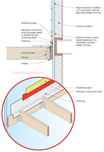

The diagram below shows flashing over a deck ledger board. The top of the flashing is integrated into the wall drainage plane. (In this case, insulating sheathing installed in a continuous manner with seams taped also functions as the drainage plane). The ends of the joist should be treated with a sealant to reduce the absorption of water at the end of the joist.

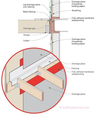

Where the drainage plane is applied over the sheathing material as a separate component—as would be the case for housewrap or building paper applied over structural sheathing—a water proof membrane should be installed between the ledger board and the sheathing. The diagram below illustrates the application of ledger board flashing in this situation.

Figure 1
Flashing over Deck Ledger
- Ledger flashing directs water out over deck ledger
- Membrane flashing integrates metal flashing into the wall drainage plane
- Sheathing tape seals membrane flashing to drainage plane/sheathing
- Deck joist ends treated to reduce absorption of water
Figure 2
WRB Behind Deck Ledger
- Drainage plane above ledger to lap over flashing which is placed over waterproof membrane
- Drainage plane to be tucked under waterproof membrane below ledger
- Deck joist ends should be treated to reduce absorption of water

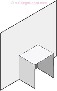

Saddle Flashing
- Deck ledger flashing to lap over saddle flashing.
- Saddle flashing may also be used for railing connections
