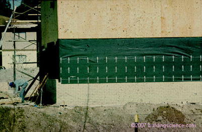

photo_02: "housewrap" drainage plane
Photograph 2:  “Housewrap” drainage plane

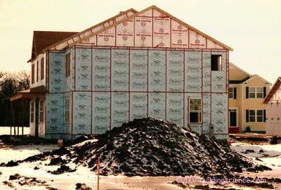

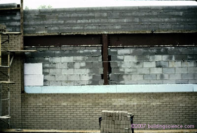

photo_03: rigid foam insulating sheathing drainage plane
Photograph 3:  Rigid foam insulating sheathing drainage plane

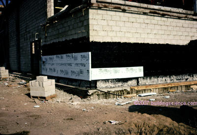

photo_04: fully adhered sheet membrane drainage plane (and "air barrier" and "vapor barrier")
Photograph 4:  Fully adhered sheet membrane drainage plane (and “air barrier” and “vapor barrier”)

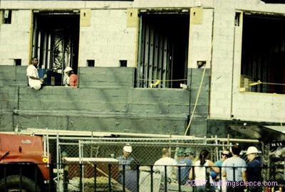

In commercial construction drainage planes are sometimes referred to as “air barriers,” but in my opinion are misnamed, as their principle fundamental function is rainwater control not air control. I prefer to refer to these type of commercial membranes as “drainage planes that also act as air barriers and vapor barriers” so that their primary function is emphasized. On drawings they should be referred to by their function – in order of importance. So if they also act as air barriers and vapor barriers they should be noted as such: e.g. “Membrane drainage plane/air barrier/vapor barrier.”

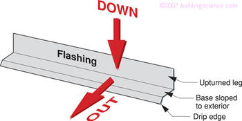

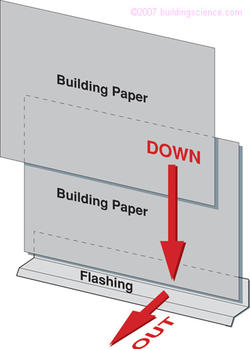

The most elegant expression of this concept is a flashing (Figure 1). Flashings are the most under-rated building enclosure component and arguably the most important. Flashings are integrated with drainage planes creating for all practical purposes a flashing for the entire assembly (Figure 2). A “screen” or “cladding” is installed over the drainage plane to provide aesthetics and to provide protection from ultra-violet radiation and mechanical damage (Figure 3). Drainage occurs between the cladding and the drainage plane.
figure_01: flashing
Figure 1:  Flashing
figure_02: flashing integrated with drainage plane - a "flashing for the entire assembly"
Figure 2:  Flashing integrated with drainage plane – a “flashing for the entire assembly”

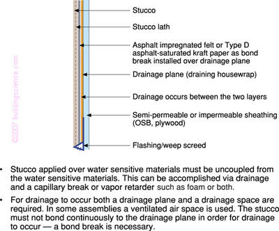

figure_04: stucco with a drainage plane and a drainage space
Figure 4:  Stucco with a drainage plane and a drainage space

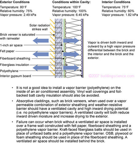

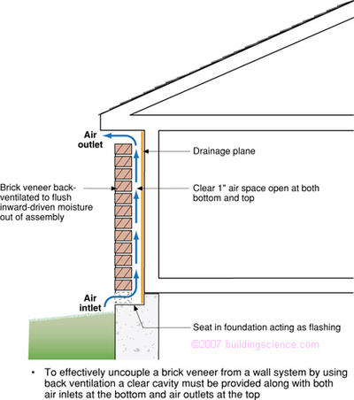

figure_05: brick veneer with a drainage plane, drainage space and ventilation space
Figure 5:  Brick veneer with a drainage plane, drainage space and ventilation space
Why ventilate a cladding in addition to providing drainage? Some claddings act as reservoirs – materials that store water. Once the reservoirs get wet, the stored water can migrate elsewhere and cause problems. The most common reservoir cladding is a brick veneer (although wood siding and stone also can be significant reservoir claddings. Serious problems can occur with rain wetted brick veneers and inward moisture movement due to solar radiation particularly where an interior vapor barrier is installed (Figure 6).

“Back ventilating” a reservoir cladding uncouples or disconnects the reservoir cladding from the rest of the wall assembly. The greater the reservoir, the greater the moisture load, and the greater the ventilation required. A reservoir cladding can also be uncoupled by providing a condensing surface such as an impermeable insulating sheathing (Figure 7) or by using a fully adhered sheet membrane that is also impermeable (i.e. also a vapor barrier). This is a particularly attractive approach where it is not possible or practical to provide a cavity (“ventilation space”) free from mortar droppings.

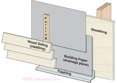

With wood siding, the drainage space is typically intermittent and depends largely on the profile of the siding. Ideally, wood siding, should be installed over furring creating a drained (and vented) air space between the drainage plane and wood siding. With vinyl and aluminum siding, the drainage space is more pronounced and furring is not necessary.
With stucco claddings, the drainage space was traditionally provided by using two layers of asphalt impregnated felt paper. The water absorbed by the felt papers from the base coat of stucco caused the papers to swell and expand.  When the assembly dried, the papers would shrink, wrinkle and de-bond from the stucco rendering providing a tortuous, but reasonably effective drainage space.
With brick veneers, the width of the drainage space has been based more on tradition than physics. A 1-inch (25 mm) airspace is more-or-less the width of a mason’s fingers, hence, the typical requirement for a 1-inch (25 mm) airspace.  However, historical experience with stucco and other cladding systems show spaces as small as 1/16 inch (2 mm) drain.  However large the space it must be coupled with a functional drainage plane.

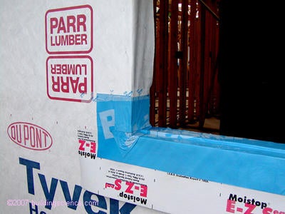

Pan flashings, membranes lining openings, precast sills with seats extending under window and door units, formable flashings, building papers, housewraps lining openings are all methods of providing drained openings (Photograph 7).

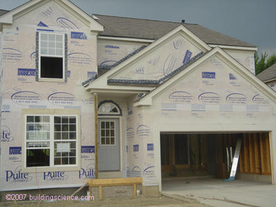

photo_06: note absence of drainage plane - problem in the making
Photograph 6:  Note absence of drainage plane – problem in the making
photo_07: membrane lining window opening creating a "pan flashing"
 Photograph 7:  Membrane lining window opening creating a “pan flashing”
These techniques allow for sealants to be installed imperfectly or for sealants to age without resulting in catastrophic failure of the assembly. A leak is not truly a leak if it leaks back to the exterior without wetting a water sensitive material.

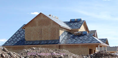

The drainage plane and drainage logic should encompass the entire building enclosure. Deck, balcony and railing connections should be designed and constructed to shed or drain water to the exterior. Roof-wall connections and roof dormer connections should be designed and constructed to shed or drain water to the exterior (Photograph 8). Garages, decks, and terraces should be sloped to the exterior and drained. And sites should be graded to shed or drain water away from building perimeters.
photo_08: membrane connecting dormer drainage plane to roof drainage plane
Photograph 8:  Membrane connecting dormer drainage plane to roof drainage plane
