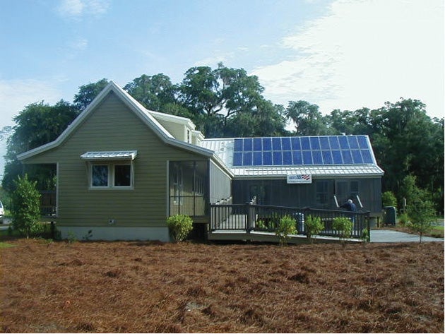

Ultra Low Energy Building Performance
Although most people associate the term zero energy with solar panels, the starting point must always be the efficiency of the structure and its heating/ventilation/air conditioning (HVAC) system. The way to really fine-tune the energy performance of a building is to treat the structure andthe HVAC system as integrated systems, matching their features and individual contributions to the whole.
  • deep wrap-around porches and window awnings for maximum shading and lots of indirect daylighting;
  • number and location of operable windows (for cross ventilation) and high ceilings (for stack effect ventilation);
  • highly reflective white standing seam metal roof cladding. These all work to reduce the need for mechanical cooling and electric lighting.
2.  The HVAC system – Building a high-performance structure allows you to really fine tune or “right-size” your space heating and cooling unit, your fresh-air ventilation, and the ducts that deliver all three. Essential elements to the Administration Building include a variable-speed ECM air handler, a two-stage 13.25 SEER/8.95 HSPF heat pump unit, and a scheduled intermittent out-side air ventilation system that also provides mixing of all interior air.  Mechanical ventilation, you say? You can’t build this tight and not purposefully introduce the outside air you need.
3.  Water heating – After your HVAC system, water heating makesup the largest single energy demand in the building. Solar waterheating (described below) is an essential part of any zero energy strategy, but you always need a back-up. While there are several options to consider—combo systems (combining water and space heating), heat pump water heaters, instantaneous systems—the Suwannee River Administration Building simply has the top-of-the-line electric tank water heater. Given the fact that solar hot water will be available much of the year in this climate, it was the most reasonable water heating solution.
4.  Lighting and appliances – Once the energy performance of the structure, the HVAC, and water heating have been optimized, “plug loads” become the next target for significant energy improvements. It begins with the big boys—the refrigerator and lighting—and reaches down to the dishwasher, dryer, and household items such as the television and microwave. The higher performance of many of these items also reduces air conditioning needs in climates with any cooling period.
The Photovoltaic System
To turn sunlight into usable electricity requires:
  • panels - to collect the solar energy and convert it into directcurrent (DC) electricity;
  • an inverter - to convert the DC into alternating current (AC), matching your building’s conventional electrical system;
  • a controller – to manage where the solar and grid-supplied power go, to or from your home or office and the grid.
Over the past few years, each of these components has been rapidly evolving and improving so that today they are compatible, code-compliant, and cost-effective. Lots of work has been done to bring the efficiency of the panels up and their cost down, and to link the panels into system packages so that you don’t have to build the system. And in many states (and maybe the whole country with residential energy efficiency legislation pending in Congress), rebates and tax incentives exist to subsidize solar equipment investment.
For the Suwannee River Administration Building of 1,700 square feet with astaff of three to four people, a 4.1-kilowattsystem with 40 EC-102 panels will supply nearly all of the building’s electrical needs. Like most PV systems, the Suwannee River PV system costs about $6 per watt. But the system will continue generating power with little to no replacement for many years.
The Solar Hot Water System
To turn sunlight into hot water requires:
  1. roof panel(s) – essentially box “greenhouses” containing highly absorbent piping and faced with double-glazing that lets light in yet traps significant heat energy for the piping to capture;
  2. transfer piping – this carries the liquid heated in the panels (either pure water in direct systems or a coolant/water mix in indirect systems) down to either a storage tank or the water heater tank (direct system) or to a heat exchanger (indirect system).
In the Suwannee River Administration Building, one 4’ x 8’ collector at peak efficiency (when the sun in a cloudless sky is shining directly over the panels) supplies most of the hot water for the office staff and visitors.
