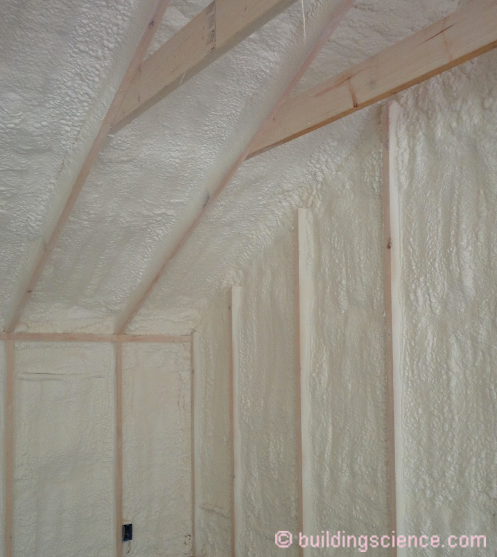

Here is the issue.  Closed-cell 2-lb/ft3 (32 kg/m3)… “high density” spray polyurethane foam has tremendous adhesive and strength properties as well as high thermal resistance and airtightness.   Closed cell spray foam is often installed on the underside of roof sheathing (Photograph 1).  If the bond  between the closed cell spray foam and the underside of the roof sheathing fails it fails quickly.  Very quickly.  And it lets everyone know that it has failed quickly.  It shouts out the failure.  Yup.  You hear the “pop”.  It wants to be the center of attention…and lets you know.
Photograph 1:  Closed cell spray foam is often installed on the underside of roof sheathing.

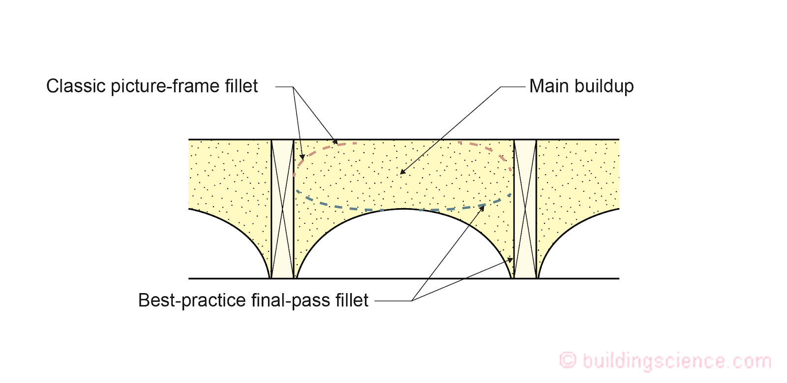

Figure 1 illustrates good installation practice that maximizes bond surface.  It is referred to as “classic picture-frame” installation…”doubled up”.  The perimeter of the “framing bays” are sprayed first with a “fillet” of foam prior to the application of the “main” buildup followed by a second layer of “picture-framing”.
Figure 1: Good Installation Practice -   Bond surface is maximized.  It is referred to as “classic picture-frame” installation…”doubled up”.  The perimeter of the “framing bays” are sprayed first with a “fillet” of foam prior to the application of the “main” buildup followed by a second layer of “picture-framing”.
