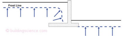

Figure 2: Frost Expansion—Freezing of frost-susceptible soil behind walls causing thrust perpendicular to the freezing front (figure adapted from U.S. Department of Defense. 1984. “Technical Manual TM 5-852-4/AFM 88-19, Arctic and Subarctic Construction, Foundations for Structures.”).
Heat loss in the ground during the winter is upwards from the ground to the air. It is never inwards from the ground into a basement if the basement is heated. The heave is upward, never inward. Key point—heated basements never, ever, experience inward frost heave, if they are warmer than the ground. This is true even if the basement is insulated. But, if you don’t heat the basement, watch out (Photograph 1).

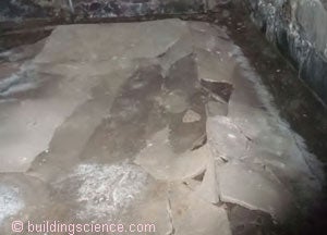

Photograph 1: Slab Heaving in Unheated Basement—So why didn’t the walls collapse inwards and only the slab buckled upward? Easy, the ground beside the foundation wall was not wet, only the ground under the slab was wet. Another “ah ha” moment. You need wet soil for frost heave. Not only do you need wet soil, you actually need “frost-susceptible” wet soil. A miserable type of soil with an annoying distribution of fines. The size of voids in a soil determines its frost-susceptibility. More than 3% grains finer than 0.02 mm in diameter by weight usually are a problem.

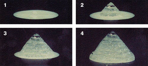

Frost heave, when it happens, can be huge. Frost heaving is due to the growth of ice crystals not due to a change in the volume of frozen water. The ice crystals under freezing conditions draw water from the surrounding soil and develop into ice lenses.3
The growth of ice lenses can be quite phenomenal. At the freezing plane, water is turned into ice, desiccating the soil beneath it. More water is drawn to that location to replace the liquid water that was removed due to a concentration gradient and, according to Penner, “pressure is developed so that the ice and soil above it are lifted.” How high can frost heave lift the soil? In the lab, it’s not so high (Photograph 2). But in the real world where nature is involved? It’s impressively high. Read on.
Photograph 2: Frost Heaving in the Lab (A sequence of Photographs courtesy of the American Physical Society from a paper by Ozawa, H. 1997. “Thermodynamics of frost heaving: A thermodynamic proposition for dynamic phenomena,” Physical Review E 56(3):2811 – 2816).

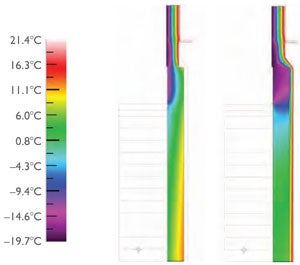

Figure 3 (left): Infrared THERM Simulation of an Uninsulated Basement Wall—Insulation or no insulation, the thermal gradient is away from the foundation wall. Figure 4 (right): Infrared THERM Simulation of an Insulated Basement Wall—Insulation or no insulation, the thermal gradient is away from the foundation wall.

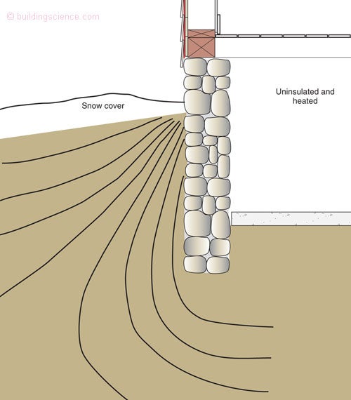

Let’s look at isotherms in the ground adjacent foundations. Figure 5 is the ground temperature profile for a heated and uninsulated basement. Figure 6is the ground temperature profile for a heated and insulated basement. The ground clearly gets colder with the addition of basement insulation. But the key point to remember is that the gradient does not change when the basement is insulated. The heat flow is greatly reduced, but the direction is still the same.
Figure 5: Isotherms in the Ground Adjacent Foundations—The ground temperature profile for a heated and uninsulated basement (adapted from Penner, E., K.N. Burn. 1970. “Adfreezing and frost heaving of foundations.” Canadian Building Digest).
Figure 6: Isotherms in the Ground Adjacent Foundations—The ground temperature profile for a heated and insulated basement. The ground clearly gets colder with the addition of basement insulation. But the key point to remember is that the gradient does not change when the basement is heated. The heat flow is greatly reduced, but the direction is still the same.

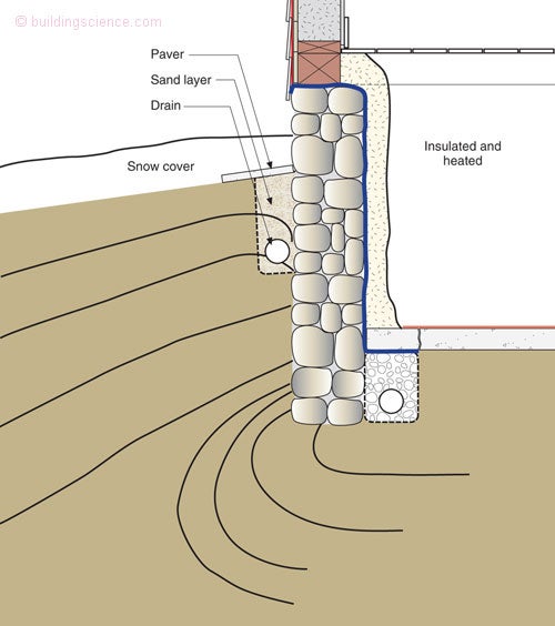

But what if I don’t want to excavate all of that dirt around the perimeter to install a wide insulation skirt? Are there other options? Of course there are. If you do not have frost susceptible soils, and if you do not have saturated soil, you do not have a problem. Get rid of the frost susceptible soils or get rid of the water, or even better, get rid of both (Figure 8).
Figure 8: Get Rid of the Frost Susceptible Soils, and Get Rid of the Water—If you do not have frost susceptible soils, and if you do not have saturated soil, you do not have a problem.

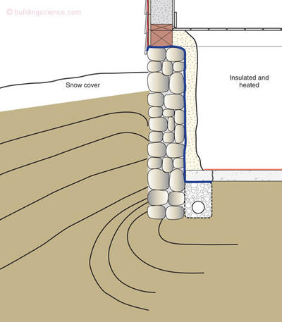

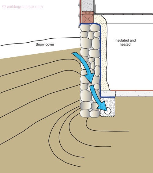

So, why in cases where we have unheated foundations and frost susceptible soils we still don’t have many problems? Well, mostly luck and some unexpected and under-appreciated drainage. With many rubble foundations, we dodge the adfreezing bullet and lateral frost heave forces because the rubble foundation wall is a pretty good drainage medium (Figure 9).
Figure 9: Dodging the Adfreezing Bullet—With many rubble foundations, we dodge the adfreezing bullet because the rubble foundation wall is a pretty good drainage medium.
