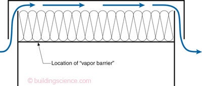

Ok, we want a roof design with a vent ratio of 1:300. What does the code want? I think Figure 1 pretty much says what the code wants – but with the code you are never quite always sure. Let’s stick with Figure 1. Note where the “vapor barrier” needs to be. This should make you a little nervous with hot humid roof assemblies.
Figure 1: Code Intent—Cross ventilation area and “vapor barrier” location.

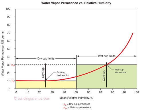

A real roof assembly would probably look like Figure 2. Again, note the location of the Class II vapor retarder. This is troublesome – you really do not want something around 1 perm at that location especially in the summer. But we have a way out. Here comes the work around. Note the test procedure. It is Test Method A. Check out Figure 3. The curve is a thing of beauty. It is a curve that is characteristic of hygroscopic materials.

Figure 3 shows as relative humidity goes up, so does vapor permeance. Where hygroscopic materials are concerned they are only vapor retarders in the absence of vapor. Test Method A (the “dry cup” method) gives you a representative value for the material exposed to an environment around 25 percent RH. When are you ever going to see a RH around 25 percent in Houston? For that roof assembly Test Method B (the “wet cup” method) would be more representative of typical conditions.
Figure 3: A Thing of Beauty
—The curve is characteristic of hygroscopic materials and shows as relative humidity goes up, so does vapor permeance. Where hygroscopic materials are concerned they are only vapor retarders in the absence of vapor. Test Method A (the “dry cup” method) gives you a representative value for the material exposed to an environment around 25 percent RH. When are you ever going to see a RH around 25 percent in Houston? For that roof assembly Test Method B (the “wet cup” method) would be more representative of typical conditions.

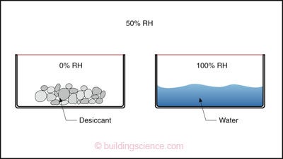

What’s with the “cups” terminology? Back in the day we actually used “cups” to test the vapor transmission properties of materials. With the “dry cup” method we kept the “cup” dry with a desiccant. With the “wet cup” method we kept the “cup” wet by filling it with water. Both dry cup testing and wet cup testing establish a 50 percent RH difference across the test specimen. However, with dry cup testing one side is at 0 percent RH and the other side is at 50 percent RH. With wet cup testing one side is at 50 percent RH and the other side is at 100 percent RH (Figure 4). Over time the weight of the cups would change. The dry cup would weigh more over time. The wet cup would weigh less over time. The rate of weight change is tracked and presto we have a metric. The “perm” was born.
Figure 4: “Cup” Terminology
—Vapor transmission properties of materials are tested with both the “dry cup” and “wet cup” method. With the “dry cup” method the “cup” is kept dry with a desiccant. With the “wet cup” method the “cup” is kept wet by filling it with water. Both “cups” are placed in an environmental chamber kept at 50 percent RH. Note that both dry cup testing and wet cup testing establish a 50 percent RH difference across the test specimen. However, with dry cup testing one side is at 0 percent RH and the other side is at 50 percent RH. With wet cup testing one side is at 50 percent RH and the other side is at 100 percent RH (Figure 4). Over time the weight of the cups change. The dry cup weighs more over time. The wet cup weighs less over time. The rate of weight change is tracked and presto we have a metric. Welcome the “perm.”

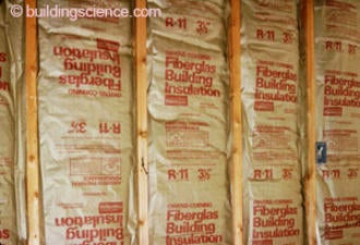

So what material is available to us that we can use for our work around in our Houston roof? The humble and ubiquitous kraft faced fiberglass batt (Photograph 1). Its dry cup value is 1 perm – so it meets the code requirement of a Class II vapor retarder as tested under ASTM E-96 Test Method A (the desiccant method). Its wet cup value is around 10 perms. So most of the year it is “vapor open” – especially during the most important part of the year for Houston, the hot and humid summer.
Photograph 1: Kraft-Faced Batt
—Humble and ubiquitous with a dry cup value of 1 perm so it meets the code requirement of a Class II vapor retarder as tested under ASTM E-96 Test Method A (the desiccant method). Its wet cup value is around 10 perms.

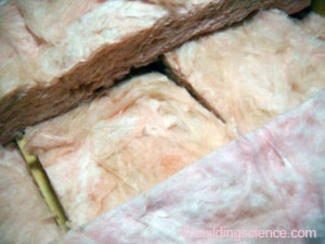

Are we done with Houston yet? Nope. The batts don’t fit very well in horizontal applications. All kinds of gaps occur between them (Photograph 2). The gaps are not an air lea.k.a.ge issue, but they are a thermal performance issue. What to do? Easy, blow loose insulation over the top of them – use blown fiberglass or blown cellulose. Guess what we call it? Batt and blow. Are we clever or what?
Photograph 2: Mind the Gap
— Batts don’t fit very well in horizontal applications. Blow loose insulation over the top of them – use blown fiberglass or blown cellulose. Guess what we call it? Batt and blow. Photograph courtesy of Steven Winter Associates.

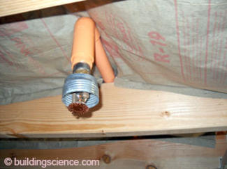

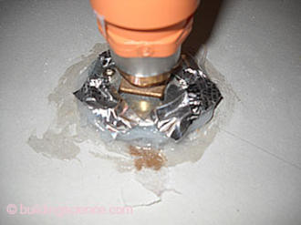

Now let's get to the next work around. If we are operating under the 2012 International Building Code we probably have to install sprinklers. Ugh. The “ugh” is not because of the sprinklers per say, the “ugh” is because we are now going to run into a fairly complicated and typically stubborn creature – the Fire Inspector. These creatures insist on having all of the insulation installed completely above the sprinklers and the sprinkler lines. Never mind the physics that can easily show that you can bury the lines in loose insulation and not risk freezing if way more insulation is above the lines and heads than below the lines. Don’t confuse the issue with physics. It gets worse, these creatures also insist on seeing the insulation installed completely above the sprinklers before they sign off. The only approach that one can use in this case is once again kraft-faced batt insulation (Photograph 3). You “tent” the sprinkler lines and heads and you are good to go. Don’t forget to blow the loose stuff over the top of the batts. Remember “batt and blow is the way to go.” This holds for all climate zones.
Photograph 3: Tenting
—Many “authorities having jurisdiction” insist that sprinklers and the sprinkler lines have insulation only installed above them – no insulation under them – and that they be inspected with the insulation in place before gypsum board is installed. The only practical way to do this is by “tenting” kraft faced batts over them. Don’t forget to blow loose fill insulation over the “tented” batt insulation. Photograph courtesy of Steven Winter Associates.

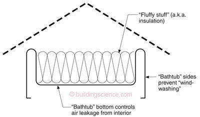

Are we done yet? Nope. One more thing. A really, really big thing. We need to understand the “bathtub principle.” Check out Figure 5. With vented attics it is real important to have a continuous air control layer (a.k.a. “air barrier”) at the ceiling plane. It is also real important to prevent wind from blowing though the insulation at the roof perimeter (a.k.a. “wind washing”). Think of the roof as a bathtub that is filled with insulation. The sides of the bathtub control wind washing and the bottom of the bathtub controls air lea.k.a.ge from the interior. So where are we going with this? The sprinkler heads can now be a really big problem. They are the holes in the bottom of the bathtub.
Figure 5: “The Bathtub Principle”
—With vented attics it is real important to have a continuous air control layer (aka “air barrier”) at the ceiling plane. It is also real important to prevent wind from blowing though the insulation at the roof perimeter (aka “wind washing”). Think of the roof as a bathtub that is filled with insulation. The sides of the bathtub control wind washing and the bottom of the bathtub controls air leakage from the interior.

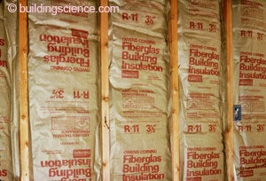

The sprinkler heads and escutcheon plates need to be airtight where they penetrate the ceiling (Photograph 4). Easy, so just seal them. Not so fast. Were they tested “sealed” or “unsealed.” This matters a great deal to that “fairly complicated and typically stubborn creature.” The manufacture of the sprinkler system has to sign off on this. Good luck. Or the “authority having jurisdiction.” Even more luck needed. Or the “architect of record” has to seal the drawing. Sealing the sprinkler heads and escutcheon plates is the “right thing to do” but not often possible because they have not been tested in that configuration and an “exception” has to be granted. An even “better” right thing to do would be for the industry to test their stuff in the “right configuration” – the “sealed” configuration.
Photograph 4: Big Holes
— Sprinkler heads and escutcheon plates need to be airtight where they penetrate the ceiling. The problem is have they been tested in this configuration?
