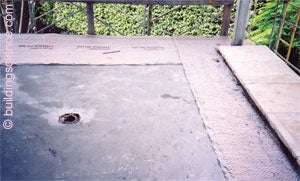

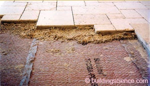

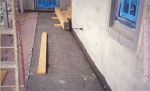

Photograph 6 shows a waterproof membrane installed on a structural deck. This is good. Note how it runs up the wall. This is also good. Also note the drainage mat going down over the top of the waterproof membrane. This is very, very good. Now look at Photograph 7. It shows the deck sloping to an interior located drain. This is awesome, as we shall see. With an interior located drain the water draining over the top of the waterproof membrane does not drain over the outside edge of the deck or balcony; it drains inward. This is a big deal with mud set tile. Photograph 8 shows mud set tile. Note the drainage mat under the mud set tile. OK, this example was done correctly with everything sloping inward away from the edge of the deck or balcony to an interior drain.
Photograph 6: Waterproof Membrane Installed on a Structural Deck—Note how it runs up the wall. This is good. Also note the drainage mat going down over the top of the waterproof membrane. This is very, very good.
Photograph 7: Interior Drain—Deck slopes to an interior located drain. With an interior located drain the water draining over the top of the waterproof membrane does not drain over the outside edge of the deck or balcony; it drains inward. This is a big deal with mud set tile.
Photograph 8: Mud Set Tile—Note the drainage mat under the mud set tile.

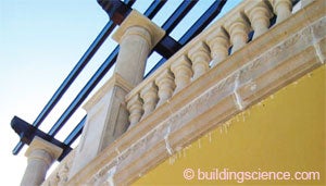

So what happens when you drain over the outside edge? Check out Photograph 9. Amazing. Stalactites. Yes, it is true, there is a lot of “stuff” in mud set mortars that is water soluble that leaches out and stains the edges of balconies and decks. The thought was, in the old days, all you needed was a drip edge that caused the water to drip away from the face of the edge. Nope, not enough with all the crud in mud sets.5 You want a drip edge and you want to drain inwards away from the edge. We learned this with parapets in last month’s column and, we learned it here.
Photograph 9 (bottom right): Stalactites—Drainage of penetrating rainwater over the outside edge of decks and balconies. There is a lot of “stuff” in mud set mortars that is water soluble that leaches out and stains the edges of balconies and decks.

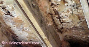

OK, now back to the condensation thing. What if you can’t insulate on the top of the deck and have to insulate underneath the deck? It happens, especially when you do not have space on the top of the deck for the insulation layer. Those darn architects again, not giving the rest of us space to make things work for them.
Let’s look at Figure 4. The water management is awesome. Note the continuity of the water control layer of the wall, connecting to the deck, connecting to the wall again. Also note the drainage gap in the wall behind the brick, the drainage gap on the deck under the tile, and the drainage gap behind the stucco. Note the base of the brick veneer is elevated and drains over the top of the tile. All good so far.6 So what is the problem? Ah, the insulation. It is not on the top of the deck, it is underneath the deck, and it’s the wrong kind. If it is underneath the deck it cannot be air permeable because, if it is, you get Photograph 10. Not good. Condensation is bad. Decay is bad. You cannot use fiberglass or cellulose insulation here. You have to go the air impermeable insulation route. You have to go to spray foam (Photograph 11).
Figure 4: Insulating the Bottom of Decks Wrong—The water management is awesome. Note the continuity of the water control layer of the wall, connecting to the deck, connecting to the wall again. Also note the drainage gap in the wall behind the brick, the drainage gap on the deck under the tile, and the drainage gap behind the stucco. Note the base of the brick veneer is elevated and drains over the top of the tile. So what is the problem? Ah, the insulation. It is not on the top of the deck; it is underneath the deck. And it’s the wrong kind; it is air permeable. If it is underneath the deck it cannot be air permeable.
Photograph 10: Condensation and Decay are Bad—Air permeable insulation under deck can lead to condensation and decay. You would never construct an unvented roof this way. So why would you ever construct a deck this way?

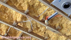

Photograph 11: Air Impermeable Insulation—Spray polyurethane foam is air impermeable. The low density stuff works in the South. The high density stuff works everywhere.
Check out Figure 5. The only thing that changes is the type of insulation used under the deck. With spray polyurethane foam the problem of condensation goes away. But, which type of spray foam? The open cell or the closed cell? The closed cell works pretty much everywhere. The open cell only in the South. So what is the definition of the South? Go to the International Residential Code (IRC) for their definition of South. South means Climate Zones 4 and lower. It has nothing to do with the Civil War. At least I don’t think it does.
Figure 5: Insulating the Bottom of Decks Right—The only thing that changes from Figure 4 is the type of insulation used under the deck. It is an air impermeable insulation—spray polyurethane foam. With spray polyurethane foam the problem of condensation goes away. But which type of spray foam? The open cell or the closed cell? The closed cell works pretty much everywhere. The open cell only works in the South.
