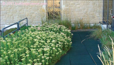

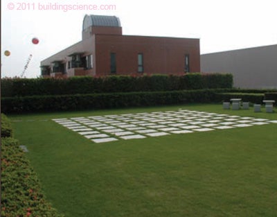

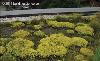

So why do I like green roofs? I think they can look beautiful (Photograph 1, Photograph 2 and Photograph 3). Not always. But when they do, it is pretty special. Most roofs are pretty ugly things, cluttered with all that mechanical stuff and design afterthoughts. You think looking down from a window in a tall building on a cityscape cluttered with ugly roofs gives you a warm and fuzzy? Give me some beauty any day. This discussion is on the verge of getting out of hand. Think about it. An engineer, a crotchety, gruff, irritating one to boot, talking about beauty? Wow. Well, let me tell you about beauty. The discussion might not be pretty, but here goes.
Photograph 1: Waterloo Green Roof—This is the roof one of my partners designed and built for his apartment building in Waterloo, Ontario. He invests his share of the company profits in Canadian real estate. I prefer mine in the form of liquid assets. I drink my profits.
Photograph 2: Buffalo Green Roof—This is a green roof walk-out balcony deck at a college building in Buffalo, N.Y. It was gorgeous. I was just passing through. Loved it; took a picture of it. I don’t know who did it. Whoever did—nicely done.
Photograph 3: Tsukuba Green Roof—A conference center in Tsukuba, Japan, near the Japanese building research center.

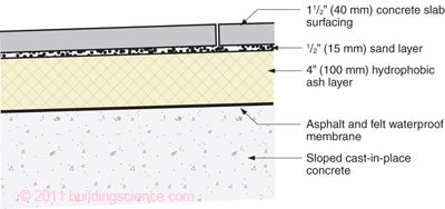

What do we know about building them? A great deal. The earliest ones go back to the old Soviet Union in the 1940s (Figure 1 and Figure 2). Think of them as PMRs or IRMAs with dirt and grass ballast. We sure know about PMR and IRMA assemblies, and we sure know about green roofs. For the newbies, PMR stands for “protected membrane roof” and IRMA stands for “inverted roof membrane assembly.” In these roofs the water control layer is (not always! fully-adhered, alas) directly on the structural deck, and the thermal control layer and ballast are located above (Figure 3).
Figure 1: Soviet-Era Protected Membrane Roof (PMR)—Pretty impressive technology for the time.
Figure 2: More Soviet Era Stuff—Great roof drain. Could have also been the design for a shower drain. For real, not kidding.

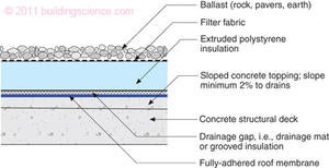

Figure 3: PMR and IRMA—Protected membrane roofs and inverted roof membrane assemblies date back in North America to before I was born—a time when the Toronto Maple Leafs were winning Stanley Cups. Note that drainage below the extruded polystyrene (XPS) layer is necessary to keep it from becoming saturated over time.
One of the great features of these systems is that the water control layer is also the assembly air control layer and vapor control layer, a.k.a., the “Perfect Roof” (see BSI-001: The Perfect Wall). The biggest benefit of the PMR is that the membrane is, well, protected. Protected from the things that destroy most membranes: heat, cold, ultraviolet radiation and mechanical damage from above. By keeping a “fully-adhered” (yup, this “fully-adhered” thing is a big deal) quality membrane below the insulation, it will never see temperatures much different than room temperature for its entire life, and will never be exposed to sunlight. It does not take a Ph.D. (“professional hairdresser”) to figure out this means that the membrane will last a very long time. In green roofs, mechanical damage happens easier because of folks working on the roof (a.k.a. “gardening”), and the costs of getting at a leak are much more expensive than other roofs, so protecting the membrane should be a no-brainer. Therefore, the PMR is tailor-made for green roofs. Even the Feds have figured this out; the General Services Administration requires PMRs for all vegetative roofs—and the brain trust at City Hall in my hometown.8
In taking apart PMR or IRMA (including terrace and green roofs) that are 10 and 20 years old and older, we have learned that the insulation layer can get saturated if it is not drained above and below. This approach was not common practice in the early days; it should be standard practice today. For drainage, all that is needed is a small gap, 1/8 in. (3 mm) or so, provided by drainage layer materials. A good slope of at least 1/4 in. (6 mm) in 12 in. (305 mm) is important so that the water can run away. And the membrane should be protected even as it turns up at parapets, curbs, and penthouses to ensure that the membrane remains durable everywhere. There is one, and only one, insulation that can be used in this type of assembly: extruded polystyrene. Use a thick layer or a series of thick layers—as thick as you can get to reduce water uptake. Surface area results in water uptake. Less surface area, less uptake. For example, one 4 in. (102 mm) layer of rigid insulation has less uptake than two layers of 2 in. (50 mm) rigid insulation. All of the other insulation types get too wet and hold too much water.

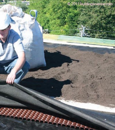

How do you turn a PMR or IRMA into a green roof? Add a root barrier, a soil-based growth medium (a.k.a. “dirt”) and plantings (a.k.a. “grass”). Make sure that drainage occurs above and below the insulation layer (Photograph 4). I mentioned this earlier, and I mention it again here. This must mean that it is important (Figure 4).
Photograph 4: Root Barrier and Drainage Layer—Both are a big deal. Notice the filter fabric above the drainage mat and the root barrier under it.
