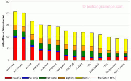

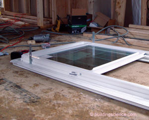

So here we are 25 years later. We all know what to do, but we can’t seem to do it. Use lots of insulation, airtight construction, controlled ventilation, and not a lot of glass. We now know what else to add to this 1970’s list—use real good glass whenever you use glass (it wasn’t available back in the day), use real good appliances, use real good lighting, and after you have done all of this use real good equipment. The real good equipment is now pretty small because you have done the other stuff. And then stop.

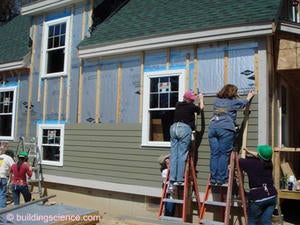

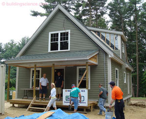

With all that we now know couldn’t we do something special? Like the old guys did? Couldn’t we build on the lessons learned from Canada’s R-2000 Program and America’s Building America Program and the stuff Eyre and Leger did? Well, architect Betsy Pettit did.8 She designed the Westford House. In a sweet link to the past it is located only a couple miles from Gene Leger’s masterpiece.

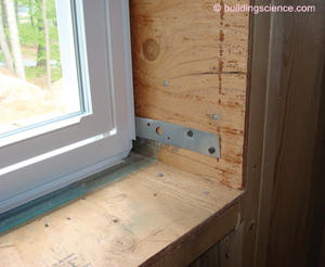

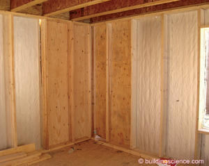

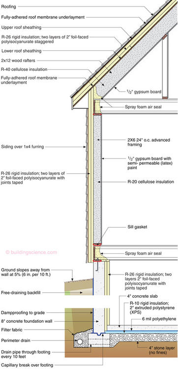

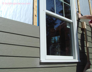

The Westford House is not weird looking. It is superinsulated. It is ultratight. It has controlled ventilation with heat recovery. It does not have lots of glass. It has real good glass. It has real good appliances. It has real good lighting. And it has real good equipment—that is small.9 Everything is off-the-shelf and can be built by anyone (see Building America Sidebar).
What did the Westford House teach us? It got us a set of performance metrics that are matched with current materials and current understanding of building science. The core design is good for all climates. It is of single wall construction with insulating sheathing. In more moderate climates just peel away some of the exterior insulation layers on the exterior walls and roof—all that changes is the thickness of the insulating sheathing. It won’t win any awards. It just works. It doesn’t need PV—but if you want to make a statement go right ahead—and now I wouldn’t bust your chops because you’ve earned the right to make the statement. Geothermal would work great where gas is not available—the trick is finding a small enough geothermal system. Harry Tschum, Les Blades and Frank Holtzclaw would be proud.
Building AmericaThe Westford House is a product of the Building America Program (BAP)—a U.S. Department of Energy initiative to develop innovative system engineering approaches to advanced housing. The technology developed under the BAP was applied by architect Betsy Pettit, FAIA, in the Westford House designed for the local chapter of Habitat for Humanity, who also was responsible for its construction (Photograph 1). The house features a R-66 roof, R-46 walls, R-26 basement perimeter insulation and R-10 under slab insulation. The framing is an “advanced frame 2x6” where studs are on 24-inch centers, stack framed, single top plates, two stud corners, no jacks, no cripples. Almost 40 percent of the framing elements typical in traditional wood frame construction have been removed. The framing factor was reduced from 25 percent to less than 15 percent. Enough board footage was removed such that the 2x6 frame package cost approx-imately 5 percent less than a traditional 2x4 frame package. The exterior sheathing was foam board insulation; racking resistance was provided at corners by structural sheathing (Photograph 2). The exterior of the wood frame structure was insulated with 4 inches of foil-faced polyiso-cyanurate rigid insulation installed in two 2-inch layers. The exterior seams were taped with flashing and sheathing tape to provide rainwater control. The wood frame cavities were insulated with cellulose. Roof construction was similar to the wall construction (Figure 1). Cladding attachment was facilitated by installing 1x4 wood furring over the 4 inches of rigid insulation using long epoxy coated steel screws. Engineering values for the 1x4 wood furring cladding support were developed using simple “bench top” testing (Photograph 3). Standard cladding attachment was then used to attach cladding to the 1x4 wood furring (Photograph 4). Published tables for cladding attachment found in the model building codes were followed. Window openings were lined with ½ inch thick plywood “boxes” that extended outward 4 inches past the exterior face of the stud wall framing such that their exterior edge lined up “flush” with the exterior surface of the exterior rigid foam insulating sheathing (Photograph 5). Typical flanged residential windows were installed with the flanges overlapping the exterior surface of the rigid foam insulating sheathing. Attachment was with mounting straps typically used with masonry openings (Photograph 6). Exterior trim was attached over the top of the exterior 1x4 wood furring (Photograph 7). Standard water management (pan flashing and flashing tape) for rigid foam sheathing was used. The experiences of the Westford House lead to the development of the “Westford Metrics” for high performance houses in cold climates. The following list yields a house with a Home Energy Rating System (HERS) index of 40. Under the HERS Index a reference home is assigned a HERS Index of 100, while a net zero energy home is assigned a HERS Index of 0. Graph 1 presents the individual energy features of the Westford Metrics and their corresponding and cumulative effect on energy consumption for a house of approximately 2,300 square feet of conditioned space (including the basement floor area).
Superinsulated R-66 roof, R-46 above grade walls, R-26 basement perimeter insulation, R-10 under slab insulation Ultratight 1.5 air changes per hour @ 50 Pascals as tested by pressurization Controlled Ventilation with Heat Recovery Ventilation rate established by ASHRAE Standard 62.2 – fully ducted, balanced ventilation Real Good Glass R-5 glass – triple glazed; U=0.20; SHGC=0.19; krypton gas filled Real Good Appliances All from the top 10% of the Energy Star range Real Good Lighting CFL throughout Real Good Equipment 95% AFUE gas furnace, instantaneous gas water heater (0.82 EF), 16 SEER A/C Smart Controls The “other” needs to be limited – turn things off when you are not using them. Controls do that. Graph 1: Parametric Study |
