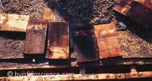

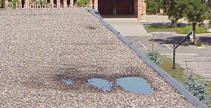

I’ve got news for you. Even with trying to get a perfect air seal, dense packing a cathedral ceiling or flat roof will not work. I am not the first to point this out to you, nor the only one.9 But, the stories of success persist, and the approach keeps getting used (Photographs 7 and 8) despite the physical evidence to the contrary (Photograph 9). Individual gamblers tell stories of winning millions in Las Vegas, but in the end, on average, the house wins. Apparently, the physics and the field evidence of failure does not deter a salesman from his mission.
Photograph 7: Flat Roof—There are a gazillion of these roofs that are uninsulated and need to be addressed.

Photograph 9: Damaged Decking—The proof of the insulating is in the opening (old insulation contractor proverb). The deck did not stand a chance. Don’t do this.
