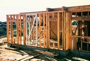

Sheathing does more than deal with wind. Sometimes it doesn’t even deal with that. It wasn’t always that way. We didn’t even used to have sheathing. We had a timber structural frame (or not, sometimes we just had rocks, or bricks, but you get the idea) and a cladding. The cladding kept the outside out – kind of – and the structure kept the building from falling down and blowing over – kind of. A century or two ago we began to get boards as a sheathing whose function was more to provide intermediate support for a cladding than anything else, and then less than a century ago we got building papers that kept the wind out. The board sheathing evolved into plywood and we got the modern residential wall – a wood structural frame sheathed with plywood sheets, wrapped with building paper covered with a cladding.
This configuration took us through almost half a century – the last half of the 20th for those that don’t quite know how to count them.
The key to the modern residential wall was the magic of the plywood (see the Sidebar). Plywood was and still is an amazing product, we continue to build furniture, houses, boats1 and planes out of it. We no longer build as many of these things out of plywood as we used to because plywood is being replaced by alternatives. This is most evident in housing where plywood is pretty much gone. In housing we see two alternatives2 - oriented strand board (OSB) (Photograph 1) and foam boards (Photograph 2).

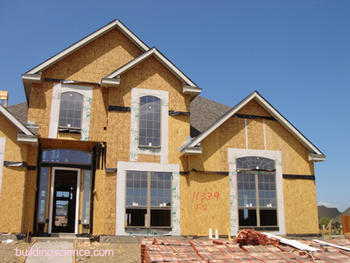

Photograph 1: Ubiquitous Sheathing—A pretty familiar sight – a home completely sheathed with oriented strand board (OSB); “ruling the range…”

OSB Sheathing
It took us about 20 years to get OSB right. The early stuff was unbelievably water sensitive. The edges swelled and the only thing you could do was to invest in a belt sander. Some of the cheap stuff today is still pretty bad. But if you shop well you can now get OSB with nail-holding characteristics as good as plywood’s and OSB shear strength that just rocks (actually it doesn’t rock… which is the point…). And it can rain on it and not swell. And we don’t need big trees and it is much less expensive than plywood. Pretty awesome all things considered.

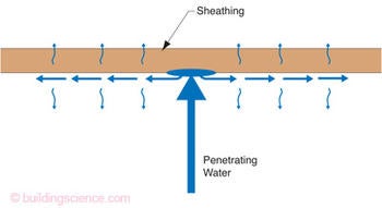

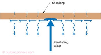

So what’s the catch? There always is a catch. It does not breathe3 as well as plywood or redistribute water as well as plywood (Figures 1a, 1b and 1c and see the Sidebar again). With lots of insulation in wall cavities we discovered that when walls get wet they don’t dry very easily because there is not much energy available to move the water vapor and that turns out to be a big problem. It gets worse if we have a barrier to the water vapor flow such as OSB.
Figure 1a: Hygric Redistribution Within a Material—Penetrating rainwater hits the sheathing, is absorbed, and redistributed laterally and inward and outward. Think plywood. Think plywood with vapor open exterior cladding.
Figure 1b: Hygric Redistribution Adjacent the Surface of a Material—Penetrating rainwater hits the sheathing, and is not easily absorbed and is not able to be redistributed within the material or passed inward or outward easily. Think OSB. But if redistribution happens within an air film adjacent the surface of the material performance can approximate that of a material with characteristics similar to those of Figure 1a. Think OSB with a small air gap. Think OSB with a vapor open exterior cladding. How small a gap? Ah, that’s the rub, eh? Pretty small, so small that “crinkled housewrap has a significant effect, as do small “bumps” or even ribbons of adhesive (think commercial water managed EIFS).
Figure 1c: Hygric Redistribution Adjacent the Surface of a Material with Limited Inward and Outward Drying—Penetrating rainwater hits the sheathing, laterally redistributed along the surface. Inward drying is limited as is outward drying. Even with limited inward and outward drying lateral redistribution significantly reduces risk of moisture damage.

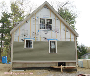

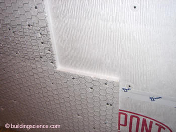

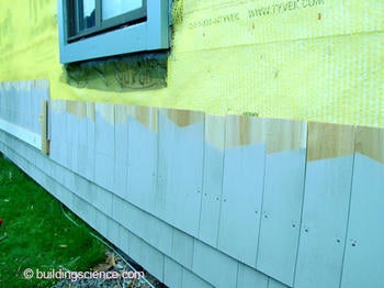

We have to help out the drying part of the equation. Turns out that to help out with the drying thing we need an air-gap between the cladding and housewrap/OSB interface. Especially with airtight claddings like stucco and manufactured stone veneer; and especially where the cavities are insulated with those new fancy spray insulations (like cellulose, or spray foam, or blown-in-batt). The air-gap is simple, elegant and unbelievably effective in helping out drying. Back-vent your cladding and be happy. How much of an air-gap? We know from experience that 3/8 of an inch is a pretty safe dimension4 with stucco, manufactured stone veneers, wood claddings or other claddings like fiber-cement that lie flat against the housewrap and OSB (Photograph 3 and Photograph 4). Typical vinyl and aluminum siding have plenty of air-gaps behind them without having to do anything.
Photograph 3: “High-tech air?”—Polypropylene mesh providing an air gap between OSB covered with housewrap and cladding.
Photograph 4: Cedar Shingles—Back ventilation and drainage of wood shingle cladding installed over OSB covered housewrap – it does not get better than this from a durability perspective.
We learned through trial and error (mostly error) that if you use OSB and really good cavity insulation and a housewrap make sure you have an air-gap between the cladding and housewrap/OSB interface. These types of assemblies with gaps work almost as well as those uninsulated assemblies sheathed with plywood we used to build decades ago. Except now we have insulation. Lots of insulation. This is a good thing.

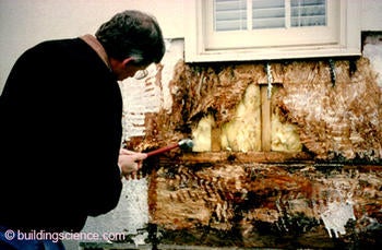

There is another factor at play that is often overlooked – and it turns out to be a real wall killer. Remember I mentioned stucco earlier? Stucco absolutely positively needs an air-gap between it and whatever it is on (except when it is applied directly on block). The air-gap’s primary function with stucco is to prevent the build up of hydrostatic pressure across the water control layer by draining the water that penetrates the stucco downwards and outwards. This is the big, big problem with stucco – the lack of drainage and the build up of hydrostatic pressure. With hydrostatic pressure water is squirted through nail holes and staple holes in building papers or even nails penetrating “self-sealing” membranes. The effect is like a junkie mainlining heroin. In the good old days plywood could tolerate a little bit of this abuse if the plywood wall saw enough energy exchange and didn’t have an additional interior vapor barrier. But the real problem was always the hydrostatic pressure because of the stucco cladding configuration - the lack of a drainage gap that would have relieved the hydrostatic pressure. So how big should this air-gap be? Easy, 3/8 of an inch. Can it be smaller? Yes, 3/8 of an inch is once again very, very conservative.5

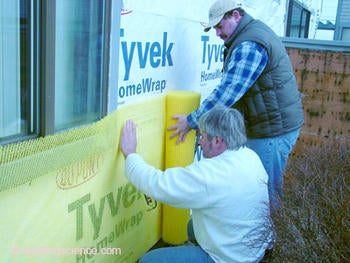

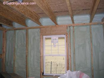

Let us go back to the cavity insulation thing. Things get very risky if you use a high-density spray foam on the inside of OSB sheathing (Photograph 5). There is no way that any appreciable moisture in the OSB can dry inwards. The only drying possible is outwards. We need the gap. Same thing with structural insulated panels (SIPs). These are foam panels lined on both sides with OSB. There is no way that an exterior OSB skin that gets wet on a SIP can dry inwards. We really need the gap with a SIP. How much of a gap? Oh, how about 3/8 of an inch? Remember the discussion about being conservative. It can be smaller with small loads.
Photograph 5: High-Density Spray Foam Cavity Insulation—High tech and low perm. Great air sealing, great thermal performance, great structural strength. Does not allow for any appreciable inward drying of the exterior sheathing.

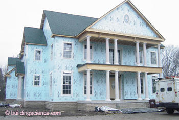

Foam Sheathing
Foam sheathings are definitely not plywood. They are also not OSB. The foam sheathings come in various flavors – extruded polystyrene (XPS) and foil-faced isocyanurate are the most common. For purposes of this discussion they will all be treated pretty much the same way – as impermeable6 and without any shear or racking structural resistance. It will be assumed that none of them store nor absorb any significant water and that none of them rot.
If you tape or seal the joints of foam sheathings they can also act as water control layers. Let me translate – if you tape or seal the joints, foam sheathings do not need to be covered with a housewrap or building paper. Foam sheathing with joint treatment can replace OSB and a housewrap and you get all of that insulating value from the foam sheathing to boot – and nothing to rot. Easy, we are done. Well, not quite.
Three details need to be addressed – foam sheathing provides no structural strength, foam sheathing does not breathe and we have to control hydrostatic pressure. These are not so minor problems.

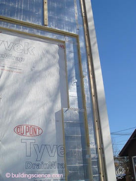

What about attaching cladding? What about it? You do not attach the cladding to foam sheathing. You attach the cladding through the foam sheathing to the structure under the foam sheathing. It is pretty straightforward. You can attach vinyl and wood siding and hardcoat stucco lath and manufactured stone veneer directly through all flavors of foam sheathing up to 2 inches thick. With fiber-cement siding this is limited to 1-1/2 inches of foil-faced polyisocyanurate. For thicker foam sheathings, 1x4 wood furring is necessary. The 1x4 wood furring is installed over the foam sheathing (up to 6 inches – really, up to 6 inches) and then the cladding is attached to the 1x4 wood furring (Photograph 7).
Photograph 7: Furring—When foam sheathings exceed 2 inches in thickness 1x4 furring becomes necessary. This wall has 4 inches of foil-faced polyisocyanurate insulating sheathing installed over a 2x6 wood frame wall. The wood furring acts as the nail base for the fiber-cement cladding.

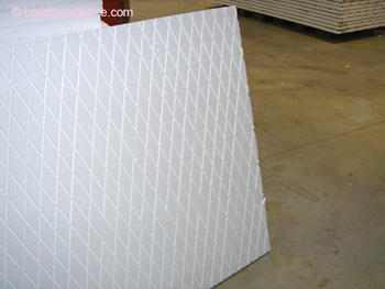

What if I use a vapor closed cavity insulation? Well, we now have a problem. Ah-hah – a problem! Yes, closed cell high-density foam cavity insulation applied to the inside of OSB sheathings that are in turn covered on the exterior with impermeable foam sheathings is risky. Unless you provide a small gap between the exterior face of the OSB and the back surface of the foam sheathing to provide for some hygric redistribution. Or if you are “perfect” with your rainwater control such as when you use a fully adhered membrane – think roof membrane standing up applied to a wall. Otherwise, go with a gap. What works? Grooved foam, “bumpy” OSB, “crinkled” building wrap, 1/8-inch polypropylene mesh, dimpled polypropylene sheets. Lots of stuff (Photograph 9 and Photograph 10). But won’t the tiny gap cause a loss of thermal performance of the foam sheathing? Yes. How much? About 5 percent of the thermal performance of the foam sheathing (not the entire wall assembly) with the 1/8-inch gap, less with a smaller gap. With “crinkly” stuff you loose next to nothing.7 Is it worth it? Yes, in my opinion, the loss in thermal performance is trivial compared to the reduced risk and improved durability. The 5 percent thermal loss is also easily offset by the improved thermal performance of the closed cell high-density foam cavity insulation. Even if you think you are perfect with a water control membrane, go with a gap for at least the relief of hydrostatic pressure. Most of think we are perfect when we really are not. Remember EIFS. Perfection is hard (Photograph 11).
Photograph 10: Groovy—Cross-cut grooves in the back of foam sheathing to provide relief of hydrostatic pressure and lateral hygric redistribution.

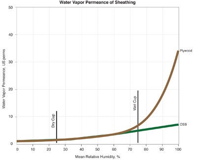

The plywood on a wood frame wall did a few important things very well. It kept the wall from falling over – it provided shear strength – and it did this very, very well. It also provided support to the cladding even though some claddings didn’t need it, whereas others did. Cladding is a fancy name for wood siding, aluminum siding, vinyl siding, fiber cement siding, stucco, manufactured stone veneer and brick. The plywood also contributed to the air tightness of the wall. It wasn’t an air barrier, but it sure helped, and it was much better than the wood board sheathing it replaced in the 1950’s.

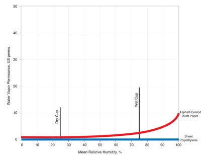

Plywood “breathes” as its moisture content increases (Figure A). So does the “kraft paper facing” traditionally found attached to the interior side of fiberglass batt cavity insulation (Figure B). This means that a wood frame wall with plywood on the exterior and with a cavity insulated with a kraft-faced batt was able to dry outwards in the winter and inwards in the summer and in both directions if a window leaked rainwater of if a cavity got wet because of a missing flashing.
Think of the plywood sheathing as a valve that opens and closes based on relative humidity or moisture content. Same for the kraft facing on the fiberglass batt cavity insulation. We now have a wall with two valves – one on the outside and one on the inside. In the winter, interior relative humidity is low so the inside valve is “closed.” On the same wall, the plywood on the exterior, sees a high relative humidity and its “valve” is open. Beautiful. The wall is semi-vapor closed on the interior and vapor open on the exterior. In the summer the conditions reverse. The interior valve opens and the exterior valve closes. And if we get cavity wetting both valves open. It meant that the same wall could work in Baton Rouge, LA and International Falls, MN and everywhere in between. Not only could it work, but it actually did, for over a half century.
But all good things and times come to an end. The Beatles broke up (you should be ashamed Yoko) and we began to run out of big trees to make plywood. We also got the Arab oil embargo and our first energy scare. All of that got us OSB, plastic housewraps, a huge focus on air tightness and so much innovation in cavity insulation that we are still somewhat confused. And even worse, we sometimes got walls with no valves at all – or valves that were permanently closed on both sides. Think interior plastic vapor barriers or vinyl wall coverings and exterior OSB sheathings or foil faced foam sheathings. Heck, all we now needed was a leaking window. What are the odds of that?
Figure A: Notice the difference between the wet cup and dry cup tests. And the huge difference at the end of the scale when things are really wet. Plywood passes moisture better than OSB, redistributes moisture better than OSB and dries much faster when it gets wet. This graph helps explain why. But, with an air gap we can compensate for this difference and make OSB the future standard for structural sheathings.
Figure B: What a difference a material makes. Plastic vapor barriers really are vapor barriers when things get wet. Not so asphalt saturated kraft paper. And most walls with asphalt saturated kraft paper thank the building science gods for the difference.
