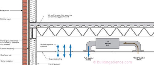

So what to do? Install a return duct on each air-handling unit in a dropped ceiling and pull air from the space below. Get rid of every 20th ceiling tile and install a grate to equalize the pressure between the occupied space and the dropped ceiling (Figure 2). The return system does not have to be extensive and fully ducted. Use transfer grilles and transoms to bleed the pressure from rooms with doors (Figure 3). And create a closure—seal the exterior wall to the floor above and the floor below creating a continuous air barrier. Note: mineral wool meets the fire requirements but does not stop airflow, so don’t shove mineral wool into a gap that leads between floors and think you have done a good deed—fire-rated foam, mastic or sealant needs to be used.
figure_02: uncoupling
Figure 2: Uncoupling Dropped Ceilings from Building Enclosures—Create a closure by extending the interior gypsum board to the underside of the floor deck, add a return air duct to the air handling units and equalize the air pressure between the dropped ceiling and the occupied space by adding ceiling grates.
