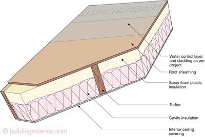

Two acceptable assemblies are shown below: one with air impermeable expanding spray foam insulation installed at the underside of the roof deck (as shown in Figure 2), and the other with rigid board foam plastic insulation installed above the roof deck (as shown in Figure 3).
In both assemblies, air permeable insulation (such as batt or loose fill) is used to increase overall insulation value. This is by no means a requirement; however, it is typically the most economical way to achieve target (or code minimum) R-values. Alternately, “air impermeable insulation” alone could be used for the entire insulation thickness, assuming that all requirements below are met.
Figure 2: Spray foam unvented roof assemblies

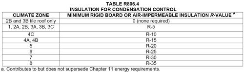

The minimum required thickness of the “air impermeable insulation” is stated in Table R806.4 Insulation for condensation control, which provides prescriptive requirements for minimum rigid board or air impermeable insulation R-values based on climate zone, in order to manage the condensation potential in the assembly.

In climate zones 5 through 8, the “air impermeable insulation” must be a vapor retarder (Class II; 1.0 perm dry cup or less), or have a vapor retarder coating or covering in direct contact with the underside of the insulation. For instance, an air impermeable but vapor permeable spray foam (0.5 pounds/cubic foot) would not meet this requirement, unless a vapor retarder coating were applied (R806.4.4).

Figure 4: Table of minimum rigid board/air impermeable insulation per climate zone
