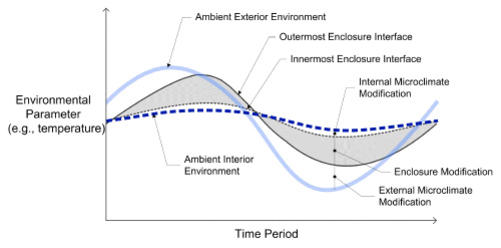

Figure 2 indicates that, while the building enclosure separates the interior and exterior environments, it really experiences several microclimates. The enclosure interacts with both environments and, in turn, affects both environments. This interaction is usually dependent on the time of day, the day of the week, and the season. There is thus a cyclical (diurnal, workday/non-workday, weekly and seasonal) aspect to the time-dependent response of the enclosure as it separates and, to some degree, modifies the influence of both environments.
Figure 2: Contributors to environmental modification
While the enclosure may be the largest modifier, the difference or the modification between the ambient and interface conditions can also be significant. Note that the scale of Figure 2 will be different for different parameters. Moreover, this simple representation of variation over one cycle of time for one parameter does not accurately or fully represent the complex behavior and interactions that occur.

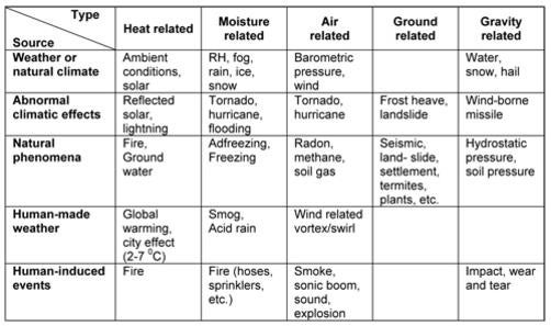

The exterior environment described above is responsible for many different loadings. Sources of these loadings are the climate (weather over the short term), human or human-made effects, and nature or natural phenomena. Table 1 identifies, by type and source, those loadings due to the exterior environment that could affect the enclosure. It should be evident from this list of loadings that the design or analysis of the enclosure involves consideration of not only the usual structural loadings but also mass (air, moisture, etc.) and energy (heat, light, sound, etc.) loadings. Moreover, for design purposes, we need to have some knowledge of both average and extreme conditions for each relevant loading.
Table 1: Loadings from the exterior environment

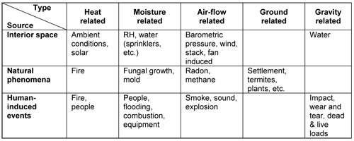

The interior environment consists of occupied, used and, often, conditioned spaces. As shown in Table 2, the main sources of loading are human-induced, the result of natural phenomena or due to conditioning. Variations in the state of the interior “climate” and the related extreme values tend to be smaller or less than those occurring within either the enclosure or the exterior. This occurs not only because the building enclosure modifies the effect of exterior variations but also because the interior environment is generally augmented by inputs of mass and energy, e.g., the building or parts of it may be mechanically conditioned.
For a building to successfully meet its desired performance, the required state of each of the interior environments must be ensured. The state of an interior space may either be maintained constant or may vary in time as a function of the nature and degree of space conditioning, internal gains (equipment, lighting, solar effects and human activities) and the modifying influence of the enclosure.
Table 2: Loadings from the interior environment

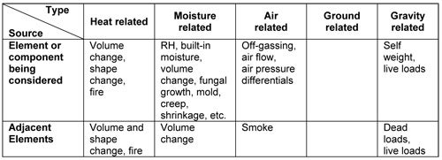

The enclosure itself is a source of loading and, as shown in Table 3, loadings arise from the enclosure element under consideration as well as adjacent elements.
To properly design buildings and their enclosures it is necessary to have some knowledge and understanding of the relevant environments as well as their interdependence. A considerable body of empirical and experimental data exists on the interaction of climate, site and building [Watson and Labs 1983, Olgyay 1963, Brown 2001, Moore 1993]. Research, notably that by Fanger [1970] and Givoni [1981], has identified and defined the physiological aspects of human response to both interior and exterior climates, and these data have been distilled into convenient forms for building designers [ASHRAE 2001].
The enclosure is only one part of the larger system that moderates or controls the environments on both sides (especially the inside) of the enclosure at some location on the building. The building itself and the enclosure both influence the exterior microclimate that interfaces with the exterior surface of the building enclosure at a specific location. Consider, for example, the local impact of wind, rain, and solar radiation. In addition, the mass and energy inputs provided by heating, ventilation, air conditioning equipment or other internal gains likewise modify the interior environment.
Table 3: Loadings from the enclosure

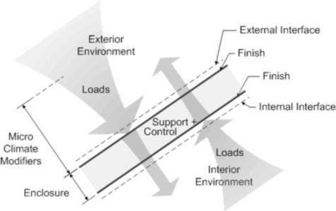

Figure 3 illustrates a representative portion of a building enclosure, its functions and the nature of the loadings. The enclosure may also serve other, usually non-physical, purposes such as advertising or as a symbol or image, e.g., as a statement about power or security or wealth, etc., but these are not considered here.
Figure 3: The enclosure and its functions
Each and every part of the enclosure must satisfy the relevant support, control, finish and distribution functions. Only the support and control functions are needed everywhere. The finish functions may not be needed in some areas (such as above suspended ceilings, in service rooms). Moreover the distribution functions, which largely service the adjacent interior spaces, need to be met only where there is a service or utility to be distributed – large segments of most enclosures do not need to fulfill this function.

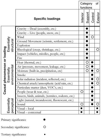

To further demonstrate the relationship between category of function and loading, consider Table 4. All the possibly relevant loadings are listed and their functional relevance is identified. This table is important because it clearly shows that the number of loadings is considerable and that each loading affects at least one functional sub-category for the enclosure and often more than one.
Table 4: General category of loadings and related functions
