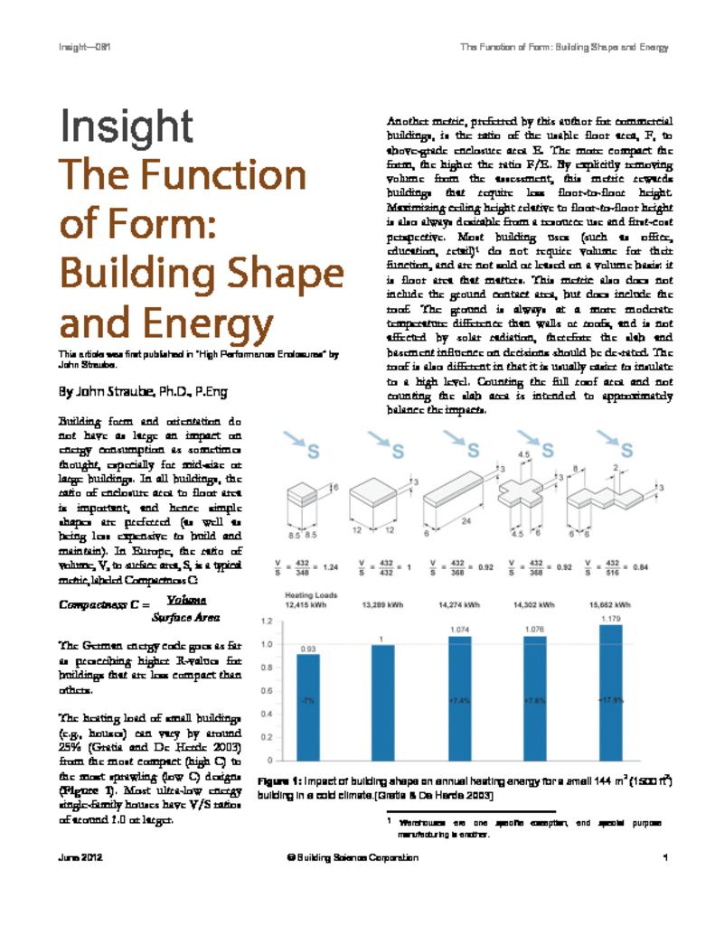

The heating load of small buildings (e.g., houses) can vary by around 25% (Gratia and De Herde 2003) from the most compact (high C) to the most sprawling (low C) designs (Figure 1). Most ultra-low energy single-family houses have V/S ratios of around 1.0 or larger.
Figure 1: Impact of building shape on annual heating energy for a small 144 m2 (1500 ft2) building in a cold climate.[Gratia & De Herde 2003]

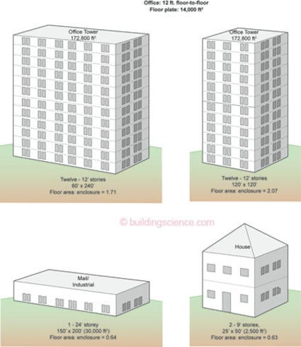

Figure 2 depicts the impact of size and form on the floor: enclosure (F/E) area ratio for an office with a 14,000 ft2 floor plate. As can be seen, the more compact the form (square is close to the perfect optimum, the circle), the higher the ratio. Large buildings (e.g., 172,800 ft2 over 12 stories) have a much more efficient form than small buildings (houses) or large high-bay buildings (e.g., malls). It follows, that for the same heat loss through the enclosure (i.e., the same overall U-value or R-value) on a winter night, the heating energy intensity (W/m2 or Btu/hr/ft2) will be higher for low F/E ratio (e.g., the house or mall) and lower for high F/E ratios. It is this logic that leads to much higher recommended overall R-values for enclosures of houses than large offices.
Figure 2:
Impact of form on floor-to-enclosure (F/E) area ratio of different building types.

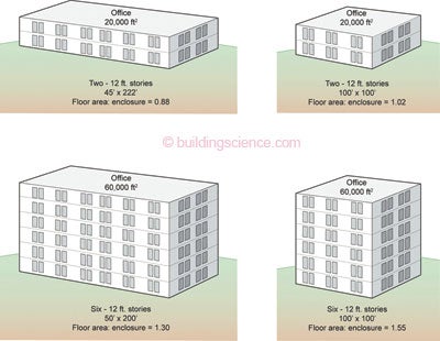

Figure 3 provides a range of F/E ratios for two sizes of office floor plan area (10,000 ft2 per floor). For the small office of 20,000 ft2 (1800 m2) a narrow two-storey form, ideal for natural ventilation and daylighting, has an F/E of 0.88, whereas a deep square plan has an F/E of 1.02. For the long narrow building to have the same enclosure heat loss coefficient, its overall average enclosure R-value would need to be 1.02/0.88 = 16% higher. In practice, this might be achieved by increasing the average R-value from 7.5 to 9.0. This small increase in overall average R- value appears deceptively easy but would require a significant increase in the opaque wall area R-value, a reduction in window area, or a much more expensive window. Never-the-less, it is relatively easily to achieve technologically.
Figure 3:
Floor area-to-enclosure area ratios for different building forms, each with
10,000 ft2 (930 m2) floor plate
The larger building of 60,000 ft2 (5500 m2) has a much higher F/E ratio. For the same floor plan form, the F/E reduction is around one third (0.88/1.33 and 1.02/1.55) and hence the larger building would have notable reduction in heat loss relative to the smaller building. The impact of plan form is similar, at around 15%, as the smaller building.

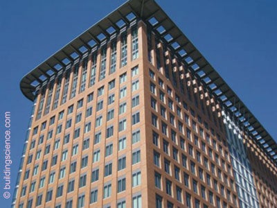

Figure 4:
A large modern office tower with highly efficient shape and window-wall area (note the number of windows with shades drawn)
