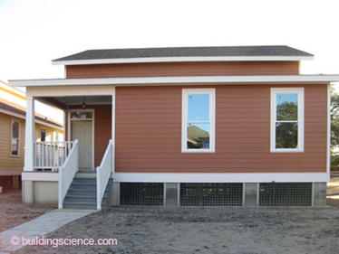

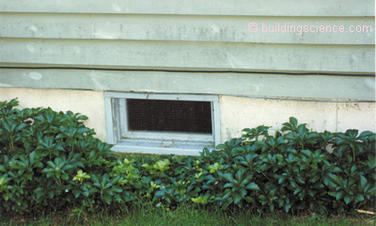

Crawlspaces stink, they rot, and are just plain icky. Photograph 1 shows the modern crawlspace, which is a forest of water droplets on the underside of fiberglass batt insulation. The exposed wood floor joists are rotting. The house over this crawlspace is not shabby (Photograph 2). Did I mention that this is a vented crawlspace (Photograph 3)? Oh, by the way, there is a continuous plastic sheet ground cover and excellent drainage. Everything in this crawlspace was done “right.” It has code specified ventilation, a continuous impermeable ground cover, excellent drainage and still we have a mess. What caused this mess? The floor insulation. No way. Yup.

Photograph 3: Ventilation Opening—Crawlspace has plenty of cross ventilation and good drainage.

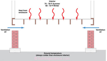

Think of the good old days—the Civil War, WWI, the Great Depression, WWII—crawlspaces were uninsulated. They were ventilated and they didn’t have ground covers—and they didn’t have problems. Why? The floor framing was pretty much always warmer than the ground (Figure 1). Everywhere, even in air-conditioned buildings. This was a pretty big deal as the temperature of the floor framing was above the dew point temperature of the exterior air that was used for “ventilation.” And the old floor finishes tended to breathe—they were relatively vapor open. No one had heard of vinyl flooring yet.
Figure 1: Old Crawlspaces—Old uninsulated and ventilated crawlspaces had warm floor assembly surfaces due to heat flow downward from occupied space above.
The ground in crawlspaces is cold,1 much colder than the outside air during the summer months. In an irony not appreciated except by building science geeks ventilation air in the summer months in most parts of North America brings moisture into crawlspaces and deposits this moisture on surfaces that are below the ventilation air dew point. In the good old days this was the ground—or the ground cover which of course is at the same temperature as the ground. It was not typically the floor framing. And who cared if the ground or the ground cover was wet as long as the wood framing was not.

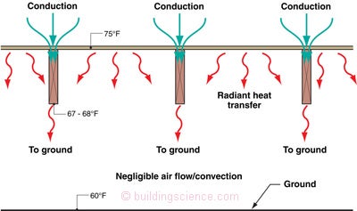

We don’t get much ventilation air change in crawlspaces—the typical ventilation air change rate in a crawlspace is approximately 1 air change per hour (ach).2 In determining crawlspace surface temperatures we can pretty much ignore the ventilation air change.3 We can’t ignore the ventilation air in the moisture balance but we can in the energy balance. Crawlspace surface temperatures are dominated by radiation and conduction, not by convection (Figure 2). And, as pointed out, old crawlspace floor framing was not only warmer than the ground but also warmer than the ventilation air dew point.
Figure 2: Old Crawlspace Temperatures—Surface temperatures are dominated by radiation and conduction, not by convection. Old crawlspace floor framing was not only warmer than the ground but also warmer than the ventilation air dew point.

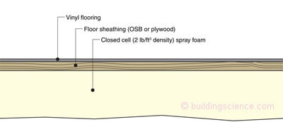

If we were do something foolish like install vinyl flooring (0.1 to 0.5 perms) over OSB floor sheathing (1.0 perms) in an assembly like that described in Figure 4 we would get a result that looks like Photograph 4. Notice the pink spots on the vinyl flooring. Reminds you of the pink spots on vinyl wall-covering.4 Come to think of it, haven’t we just constructed a wall with vinyl wall-covering and laid it down? Same principle, same problem. The floor does not “breathe.” We have a vapor barrier on the wrong side of the assembly. So we can fix this problem by having a vapor permeable floor assembly—plywood sheathing (it is way more permeable than OSB) and carpet do the trick. Works, but it is kind of limiting. Oh, yeah, you also can’t put furniture on the floor if the furniture is impermeable, so you have to hold it up to ventilate under it—same for cabinetry—you have to ventilate it as well. But what if I don’t want plywood, carpet and ventilated furniture and cabinetry?
Photograph 4: Vinyl Flooring—Pink spots due to moisture problems arising from the impermeability of the vinyl flooring and ventilated and insulated crawlspace underneath.

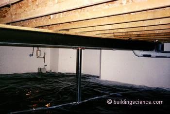

The easy answer is to construct a conditioned crawlspace (Photograph 5). Construct it like a “mini-basement.” Then you can have any floor finish you want and save a bunch of energy and money. But I know you folks. You are stubborn and insist on doing the vented crawlspace thing. Hey, maybe you need to because you are in a flood zone—it could happen that you actually have a legitimate reason to construct a vented crawlspace. So how should the floor assembly look?
Photograph 5: Conditioned Crawlspace—The way all crawlspaces should look. Dry, warm, part of the house, not part of the outside or part of the ground. Insulated on the perimeter not in the floor. Beautiful.

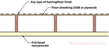

Check out Figure 6 and Figure 7. Both show foil faced rigid insulation under the floor framing. The wood is warm and therefore dry. The foil facing on the rigid insulation handles the vapor drive. The foil facing is an exceptional vapor barrier ( 0.1 perm). Beautiful. It gets better, the foil facing, if you expose the shiny side (face it down into the crawlspace) almost eliminates radiative coupling and means that the surface of the insulation approaches the temperature of the ventilation air reducing condensation. So why don’t we see lots of this? Well, I forgot to mention that the rigid insulation needs to be airtight so that requires tiny people with good workmanship to seal the seams with foil tape that sticks in miserable environmental conditions forever. Having said that, a poor job using the approaches described in Figure 6 and Figure 7 are way better than what we typically get with Photograph 1 and Figure 3.
Figure 6: Vapor Barrier—Installing impermeable rigid insulation keeps the wood framing warm and provides a low perm layer that addresses the upward vapor drive. How impermeable? Less than 0.1 perms. Foil faced rigid insulations are the ticket here. This approach allows any type of flooring to be used above. Even better—exposing the shiny side of the foil facing (face it down into the crawlspace) almost eliminates radiative coupling and means that the surface of the insulation approaches the temperature of the ventilation air reducing condensation.

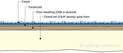

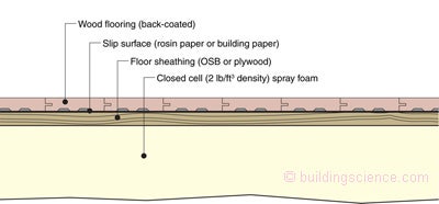

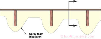

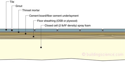

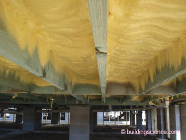

All this leads us back to Figure 5 and spray foam. Lots of folks are looking at this option due to the lack of tiny people with good workmanship.5 The spray foam clearly handles the warming the wood thing. Any foam will work for the wood warming—low density, high density, whatever. Recall, just by warming the wood you lower it’s equilibrium moisture content. Where things get difficult are with the vapor drive across the floor sheathing and the floor finish. Unless you stick to carpet, and ventilated furniture and ventilated cabinetry you are going to have to use high-density foam—at least 2 lb/ft3—due to its lower perm value. And at least 3 inches thick or thicker (gives you less than 1 perm at this thickness). Figure 8 shows a few configurations that pretty much work everywhere. Even Figure 8d, with vinyl flooring, works in mixed-humid and hot-humid climates. Having said that, I think you should just say no to vinyl—that makes things a whole lot easier. If you really like vinyl, go with Figure 6 or Figure 7 or even better Photograph 5 (the conditioned crawlspace or mini-basement).
What if I don’t want to completely encase the floor framing? What if I want to go with Figure 9 and Photograph 6? That works if the crawlspace does not get too cold—in the summer—if it is coupled more to the outside air than to the crawlspace ground temperature. Elevated crawlspaces with open piers work fine in this regard (Photograph 7).
At the end of the day, recall that the best crawlspace of all is filled with concrete and called a slab—or dug out and called a basement.
Figures 8a – 8d: Spray Foam Configurations—Stick to closed cell 2 1b/ft3 density spray foam. Avoid vinyl flooring—except in dry and cold climates.
Figure 8b
Figure 8c
Figure 9: Not Encased Floor Framing—Use high-density foam, at least 2 lb/ft3, due to its lower perm rate and couple the crawlspace to the outside. Elevate the crawlspace and use open pier construction.
Photograph 6: Spray Foam Between Joists—Floor framing is not completely encased with spray foam in this application. Works only where the crawlspace is open to the outside.
