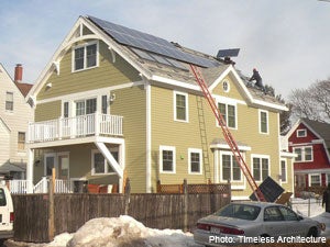

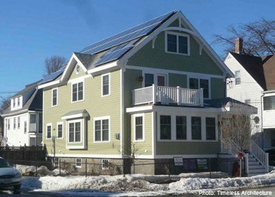

During the DER process an additional floor was added to the home, as well as an entirely new roof with a 6.255 kW PV array.

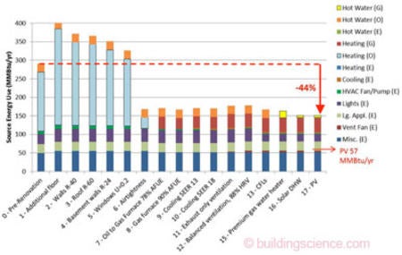

Estimated Annual Energy Savings: Source energy reduction is 66% with predicted PV generation (44% without PV); expected to meet Thousand Home Challenge
The design includes significant reconfiguration to accommodate a growing family, pending move-in of an elderly parent, and careers performed from in-home offices–all within an existing foot print. The foundation walls and first floor enclosure structure were retained. The roof and half-story beneath the roof were demolished to make way for a new full 2nd floor plus half-story under a new roof.

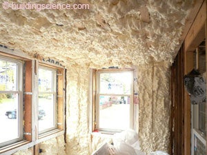

The architect designed the retrofit of the existing enclosure as well as the new structure to provide a high level of thermal performance. Roof eaves, rake extensions and, even, a false dormer detail, were attached over a continuous airflow control layer and exterior insulation. Other details were also designed to minimize thermal bridging. To complement the air flow control of a carefully detailed housewrap and 2 layers of exterior insulation, framing cavities in exterior wood-framed walls and roof are filled with open-cell spray foam. Closed-cell foam is applied to the framing sill and granite block foundation wall. The architect specified a high-density EPS foam board as a substitution for XPS beneath the radiant slab out of concern for the blowing agents used in XPS foam.

Parametric Study of Source Energy Use

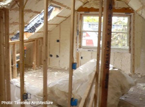

Roof Assembly: R-62 unvented roof: 10” Icynene® open-cell spray foam insulation in rafter cavities; roof sheathing; housewrap; two layers of 2” polyisocyanurate insulating sheathing, joints offset and taped; plywood nail base; roof underlayment; asphalt shingles.

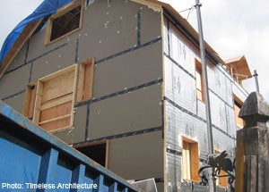

Wall Assembly: R-38 (nominal): Icynene® open-cell spray foam insulation in 2x4 wall framing cavities; existing board sheathing or new plywood sheathing; housewrap; two layers of 2” polyisocyanurate insulating sheathing joints offset and taped; 1x3 wood furring; fiber cement siding.

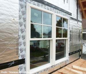

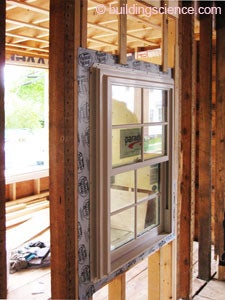

Window Specifications: New Paradigm triple-pane, vinyl framed, low-e, krypton blend or argon gas filled; U=0.20 – 0.26, SHGC=0.23 – 0.21; windows installed in plane with primary water control layer.
Air Sealing: Taped housewrap over roof and wall sheathing; adhered membrane wrapping from roof to wall; two layers of 2” polyisocyanurate insulating sheathing joints offset and taped; open-cell spray foam insulation in wall and roof framing cavities; closed-cell spray foam applied over framing sill and granite block foundation wall; spray foam extends to new concrete slab.

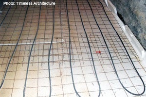

Foundation Assembly: Conditioned basement: 2” closed-cell spray foam applied over framing sill and foundation wall; 3½” fiberglass batt in new wall framing cavity; 6-10” gravel, 2½” EPS insulation; polyethylene vapor retarder under new concrete slab with radiant tubing.

The expanded polystyrene (EPS) insulation specified to insulate the new basement slab proved difficult to source and not rugged enough to stand up to the conditions of the construction site.

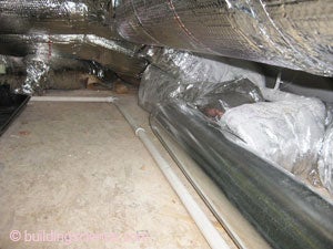

Ventilation: LifeBreath HRV, ducted to central AHU distribution.
Heat recovery ventilator (HRV) ducts
Space Conditioning Distribution: Ductwork for forced-air system entirely within conditioned space; hydronic radiant in new concrete basement slab; hydronic panel radiator at entry and front/porch room.

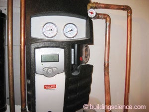

DHW: Phoenix Evolution Versa-Hydro™ direct-fired storage water heater with heat exchanger for input from 6 Velux integrated solar thermal collector panels.
Input from Velux solar thermal panels

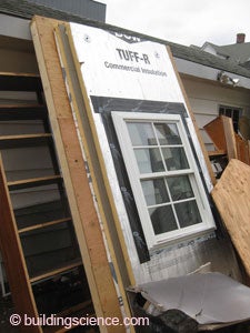

Early in the project cycle, BSC assisted the architect in communicating performance goals to the HVAC subcontractors at on-site meetings. During the course of construction BSC conducted multiple site visits to review construction details with the architect and general contractor. During one such visit, BSC guided the general contractor and framing/siding subcontractor through a mock up window installation.

During measurement and verification testing, BSC noted that the HRV was ducted to the central forced-air system in a way that would allow air to be drawn through the ventilation unit when the ventilation system is not running. BSC performed duct leakage diagnostics to estimate the magnitude of this unintended ventilation so that the programmed ventilation rate could be adjusted accordingly.

Design Challenge: Mock-Up Makes Perfect This project represented the first implementation of thick exterior insulation (>2”) for both the general contractor and the framing/siding subcontractor. During an early construction-phase site visit, BSC guided the general contractor and framing/siding subcontractor through a mock-up window installation. This exercise helped both contractors to develop a level of comfort and confidence in the designed window installation details. This was particularly important as the window placement needed for proper water management and airflow control requires a deviation from standard practice. Subsequently, the project construction team constructed a wall section mock-up that demonstrated window flashing, air sealing, and attachment of exterior insulation. Both mock-ups provided opportunities to resolve unique installation questions and also proved effective communication tools. |
