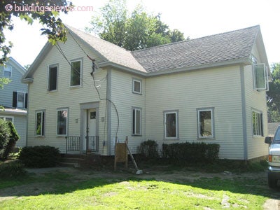

Description: 2,747 ft2, 3 bedroom, 2 bathroom, 2 stories with a full basement single family Victorian
Completion Date: August 2011
The owners of this circa 1800 Victorian have been postponing renovation and performance upgrade for years in anticipation of a major change in the household structure. With the likelihood of an aging parent’s arrival, they decided to rebuild a portion of the home and add new space to provide a ground floor bedroom with an unfinished office space above. Financial and technical support offered through National Grid’s Deep Energy Retrofit Pilot Program allowed the owners to incorporate a deep energy retrofit (DER) of the existing portions of the building into the larger project. Building Science Corporation provided technical support to the project on behalf of National Grid. The DER was implemented while the home was occupied.

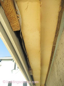

The design uses the “chain saw” approach at the roof-wall interface. In this approach, roof overhangs are sawn off at the wall sheathing so that the air control layer and thermal control layers of the roof connect directly to the corresponding control layers of the wall system.

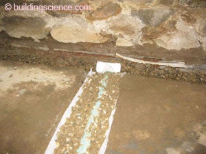

Water issues in the basement are managed by gravel trenches cut into the existing slab and an interior perimeter drain connected to sumps. Closed-cell spray foam on the brick-and-rubble-stone walls and rigid foam surrounding the newly cast slab provide insulation and also direct water to the sub-slab drainage system.

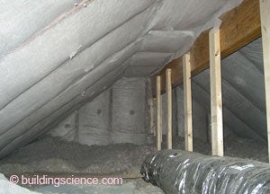

Roof Assembly: R-60 (nominal) Unvented roof assembly: Rafter bays netted and dense-packed with cellulose insulation, ½” plywood over existing board sheathing; fully adhered membrane; 4” polyisocyanurate insulating sheathing in 2 layers; taped OSB sheathing system (Zip System® Roof); 2nd layer of fully adhered membrane; asphalt shingles.

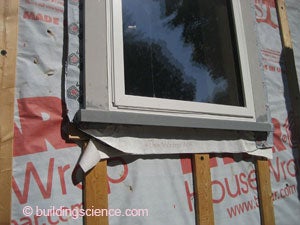

Window Specifications: Serious Windows triple-glazed, krypton gas, low-E fiberglass windows; U=0.14-0.17, SHGC=0.33-0.42; windows installed over strapping at exterior face of insulating sheathing; rigid insulation inserts at basement windows.

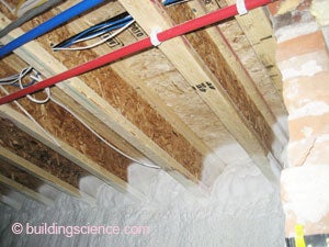

Foundation Assembly: Conditioned basement with 5” of closed-cell spray foam at existing fieldstone and brick foundation walls; open-cell spray foam at sill beam; intumescent coating on spray foam; new concrete slab cast in “bathtub” of 2” high-density EPS over existing slab, interior drain and gravel.

The builder brought a passion for perfection that was evident in implementation of water management and air sealing details. No effort (or canned foam) was spared in ensuring a thorough air seal between the framed wall system and the foundation wall. A beveled cap over window head casing trim is an example of the attention to water management details. This small trim piece makes it virtually impossible for the metal cap flashing to have a back slope. The builder opted to apply two layers of adhered ice and water membrane at the roof: one over the plywood sheathing beneath exterior insulation and one to the sheathing installed over the insulation.

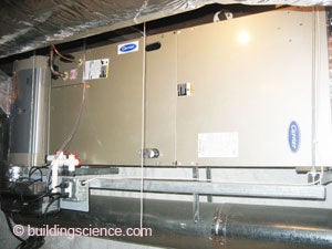

Heating and Cooling: ClimateMaster ground-source heat pump system*; Carrier air handler unit located in the conditioned basement.
Air handler

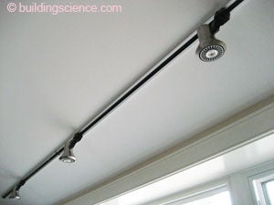

Lighting: Combination of CFL and LED lighting.

* The client elected to pursue all-electric heating and water heating system. This was not the recommendation of the architect or BSC.
Through both on-site and remote technical support, BSC was able to help the project identify feasible improvements and simplifications. Closed-cell spray foam was substituted for the open-cell at the sill in order to provide a drying mechanism for the framing. BSC eased the architect and builder into eliminating a planned drainage mat over the existing slab and at the new slab perimeter by demonstrating how rigid foam insulation against the rubble stone created a path to the drainage system. Despite generally excellent implementation of water management details, BSC was able to point out a few instances of missing flashing at critical locations.

The “chain saw” approach at the roof-wall transition also greatly simplifies implementation of robust airflow control. A fully adhered membrane wrapped from the airflow control sheathing at the roof onto the airflow control sheathing of the wall. Two layers of 2” foil-faced polyisocyanurate insulating sheathing were added to the walls and roof with seams offset and sealed with sheathing tape. Well-applied spray foam insulation and a new concrete slab provided robust airflow control at the foundation level. The spray foam also facilitates robust air barrier transitions to the slab and framed wall.
