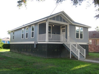

Address: Gentilly, New Orleans, LA
Description: A mix of 1,146 ft2 and 1,316 ft2 one-story single family detached homes
Completion Date: November, 2009
Estimated Annual Energy Savings: $750 to $1025 or an average 40% energy use reduction relative to the 2008 Building America benchmark

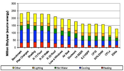

Parametric Study
This year, “Phase II”, is the construction of 12 detached single family homes in the same manner of construction as Phase I. The makeup of the team is the same as Phase I. This is a benefit in that the entire team is now familiar with all aspects of the house design. There are 3 floor plans that were designed by the local architecture firm FutureProof http://www.futureproofnola.com/). The architect has provided an aesthetically pleasing mix of house designs that will fit well with the existing community. The floor plans are all single story with conditioned floor area ranging from 1146 ft2 to 1316 ft2. Please refer to the appendix for full floor plans. The builder for this project is TKTMJ, Inc. (http://tktmj.com/). All 12 homes will be occupied by low income families in need of a home after Hurricane Katrina.
These affordable homes have a higher occupancy density than other Building America communities. The construction budget for each house is around $198,000 and there is no more money available for increasing the budget. Therefore, BSC and PHA had to be careful choosing what Building America design recommendations to implement.
BSC provided consulting services for PHA and recommended numerous efficiency and durability improvements. Key upgrades include closed cell high density spray foam insulation for the entire enclosure (including an unvented cathedralized attic) and supplemental dehumidification. Other important upgrades include LoE3 glazing as well as a high efficiency heat pump.

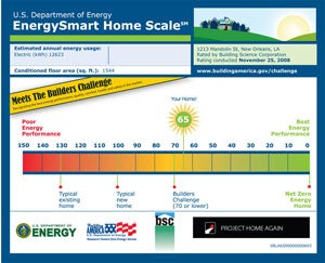

Project Home Again and BSC are working with a local rater who will provide the majority of the testing and building commissioning. They will not be Energy Star rated because of the additional cost concerns and the fact that they slightly missed the $2000 Federal Tax Credit. However, all these homes receive a HERS Index score that range from 66-69, therefore they qualify for Building America’s Builder’s Challenge certification.

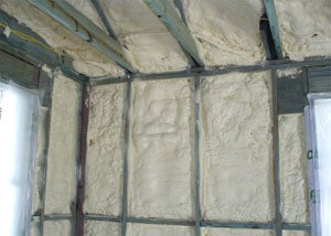

Wall Assembly: The framing is 2x6 at 24” o.c. however full advanced framing could not be achieved due to structural concerns. Full advanced framing could not be achieved because of prescriptive guidelines set by the 130 MPH Wood Frame Construction Manual that was adopted by the city of New Orleans. Therefore, the houses are framed with a double top plate and 3 - 4 stud corners.
Wall framing

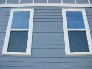

Window Specifications:The windows are vinyl with LoE3 spectrally selective glass that has a very low SHGC of 0.23. Glazing is the most important enclosure element in a hot-humid climate, and this next generation glazing technology is an impressive efficiency and durability upgrade.

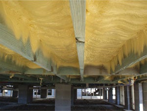

Foundation Assembly:The homes will be fully framed and will be constructed on pressure treated wooden piles. Wooden piles were chosen for Phase II over the block piers utilized in Phase I due to the different soil geography in the neighborhood. All wood is borate pressure treated for resistance to termites and mold.
Floor framing on wooden piles

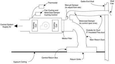

Heating and Cooling: A high efficiency heat pump (14 SEER/8.25 HSPF) is installed in the unvented attic. An extremely well sealed duct system will be fully enclosed within conditioned space. Transfer grilles provide passive returns from the bedrooms to the main living space. A fully ducted central return will be installed on each floor in a main living area.
Heating and cooling schematic

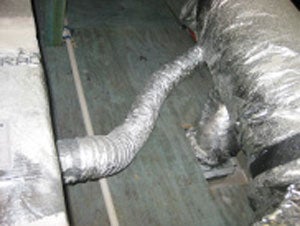

Ventilation: Central Fan Integrated Supply (CFIS) ventilation controlled by the Aprilaire dehumidifier. Ventilation is provided via a CFIS ventilation system that draws outside through a 6” flex duct to the return plenum of the HVAC system. This allows for the introduction of outside air to the living space whenever space conditioning is already operating.
Ventilation ductwork

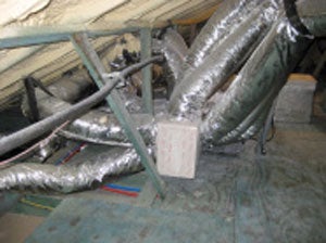

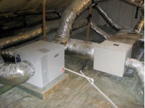

Space Conditioning Distribution: All 3 floor plans had the system “right sized” sized with Manual J8. That is, each house has the heat pump sized to 100% total load as calculated by ACCA Manual J8. Duct sizes and room CFM flows were specified for each house at its particular orientation.
Ductwork in conditioned atti
c

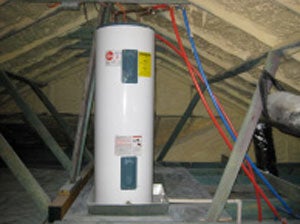

DHW: 0.92 EF 50 gallon electric water heater
Electric water heater in conditioned attic

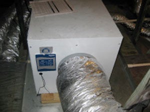

Dehumidification: A whole house dehumidifier has been installed to allow for humidity control separate from cooling. This ensures proper comfort control year round. An Aprilaire Model 1750 whole house dehumidifier is configured to draw air from the main living space be distributed throughout the house and for the dehumidifier to run only when dehumidification is needed.
Whole house dehumidifie
r

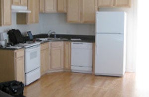

ENERGY STAR® appliances

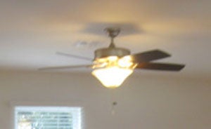

Lighting: ENERGY STAR® CFLs
Lighting

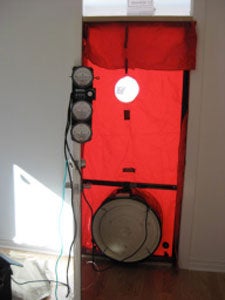

Testing
Overall performance testing was performed by a local HERS Rater. They performed tests such as:
  • Blower door enclosure air leakage
  • Duct Blaster® duct leakage
  • Bedroom room pressures

Overall, the construction of these homes has been a success; however a lesson was learned with respect to the supplemental dehumidification. Some homeowners began complaining that the cooling system could not meet set point during peak cooling conditions.
It was determined by the builder that this was due to the additional sensible heat produced by the whole house dehumidifier. The dehumidifier was running along with the cooling system during periods of high cooling. The added sensible output of the dehumidifier was preventing the cooling system from achieving set point temperature.
The dehumidifier is not supposed to run during the peak cooling periods by design. Rather, the existing HVAC system will provide enough dehumidification through standard cooling during periods of high cooling. Initially, the 90 pint Aprilaire® Model 1750 dehumidifier’s operation dial was set in the 3-5 range, per the manufacturer’s installation manual. This was too high of a setting and it resulted in the dehumidifier running too much. The 90 pint unit outputs around ~10 kBtu while operating. This was enough sensible gain to raise the cooling load above the capacity of the two ton unit.
The reason for this is that the dehumidifier settings couldn’t be altered without going up into the unvented cathedralized attic space and access the unit directly. This is because PHA did not purchase and install a remote dehumidistat, therefore the homeowner was unable to change the dehumidifier setting. The homes are now operating normally and the occupants are comfortable.
In response to the complaints, BSC recommended that the dial setting be reduced to the lowest setting (~1 on the dial) until the dehumidistats are installed. HOBOs were installed in 10 homes after the settings were adjusted. The measurements from the HOBOs confirm that the interior dry bulb set point is now always met and that interior %RH doesn't rise above 55% RH throughout the year.
Building Science Corporation contacted Aprilaire® and the manufacturer offered 20 dehumidistats at a greatly reduced rate and the builder will be installing these units. BSC will require the installation of the Model 70 interior dehumidistat next to the thermostat such that the homeowner can read and change the interior humidity levels if needed in all future BA homes that have supplemental dehumidification.
